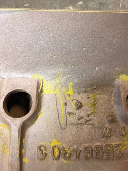

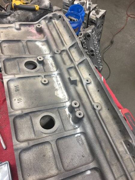

Machine shop sent my engine builder this picture. They called it a minor crack. It is circled in pencil.
What appears to be a crack next to freeze out plug (right side) is not.
This is a 67 440 out of a GTX.
For the minor crack we are discussing options to fix. LockNStitch?
Just looking for your all thoughts.
Thanks.

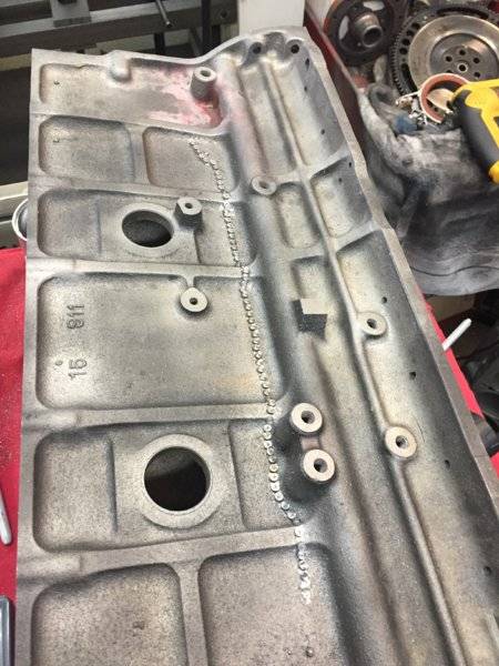

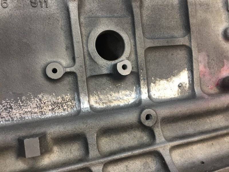

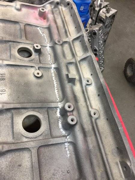

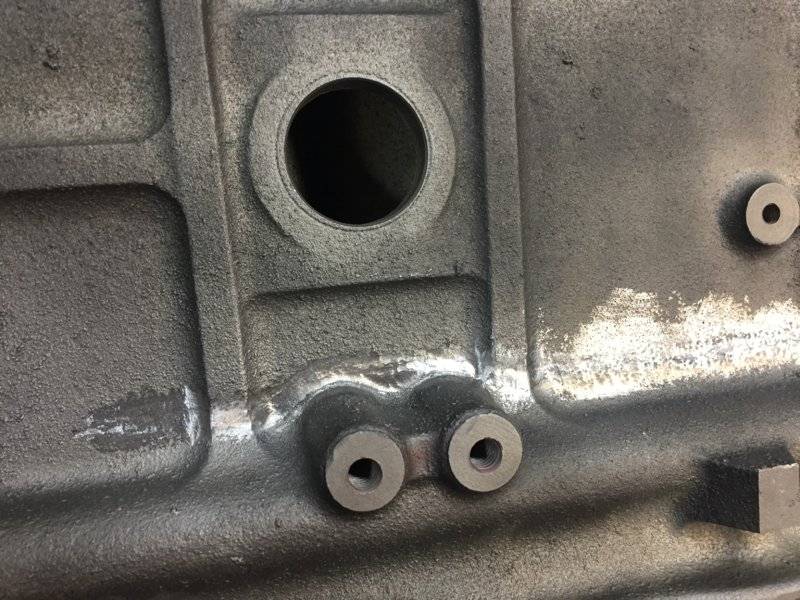

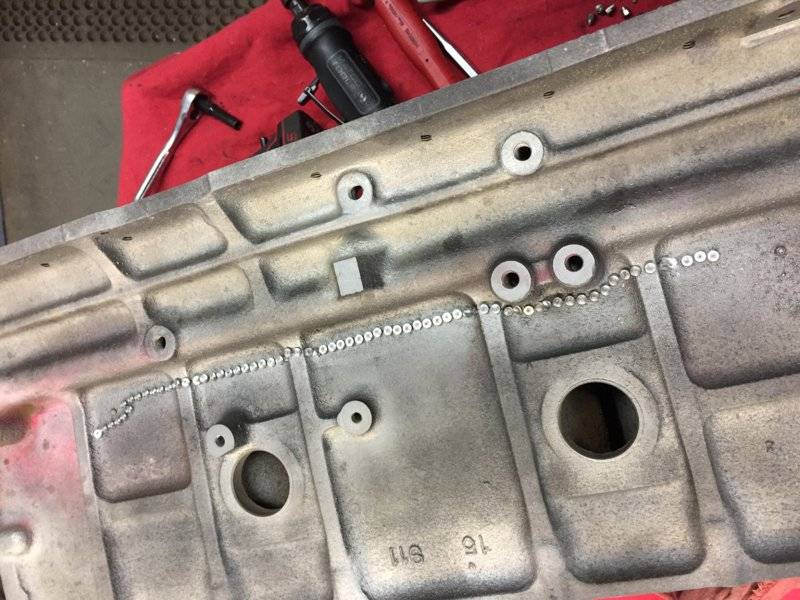

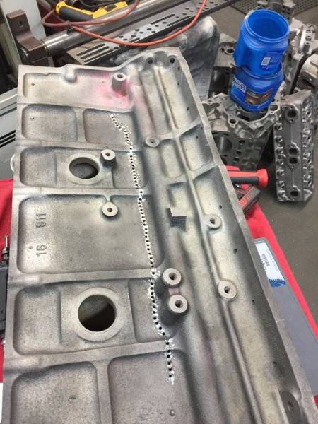

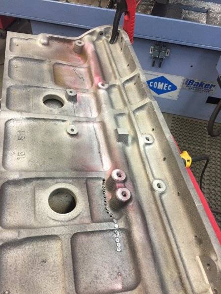

I use lock-n-stitch all the time, and works very well. I would see ANY problems with fixing that crack this way. Here are some pics of a 16" crack I repaired on a 235 GM 6cyl. Owner wanted original block, so... Took about 7 hrs and 135 pins.
Maybe kinda crude but, I used JB Weld on a very similar crack 15 years ago and it's still holding. Ground out a "V" and filled it back in.
Mike
View attachment 585223 View attachment 585224 View attachment 585225 View attachment 585227 View attachment 585228 View attachment 585229 View attachment 585230 View attachment 585231
Wow your work looks first class. I appreciate all the pictures. My crack is about 2" or less. I'm hoping less than a couple hours. Thx.
Weld it! A good professional welder can fix that. If a potential welder expresses any doubt, go find another ASAP!

drill a tiny to small hole at each end of that crack , so it won't grow any further , 'v' the crack with a bit deep , heat the area up to cherry red and keep it there . tig (have to remove the fluks coating from rod) or arc weld up that crack with the ni-99 rod , its made for repairing and welding on cast iron . have done it on different engine block with great results .
last block I had repaired had the same type crack in it..at the freeze plug,,sent it to a cast iron repair shop in northern calif,,where they heat the block up in an oven,then braze the cracks..worked great..professionally done..with freight back to me was 600.00..same thing with cracked max wedge heads..brazed...
Simple weld without going through the oven process, if the welder knows what he’s doing. Should be much less that $400.
that's nothing to worry about I've had a lot worse than that repaired I'd just cold stitch which is usually $50 a inch make sure they over lap them & pressure test it. I would never weld a block unless it absolutely had to be.

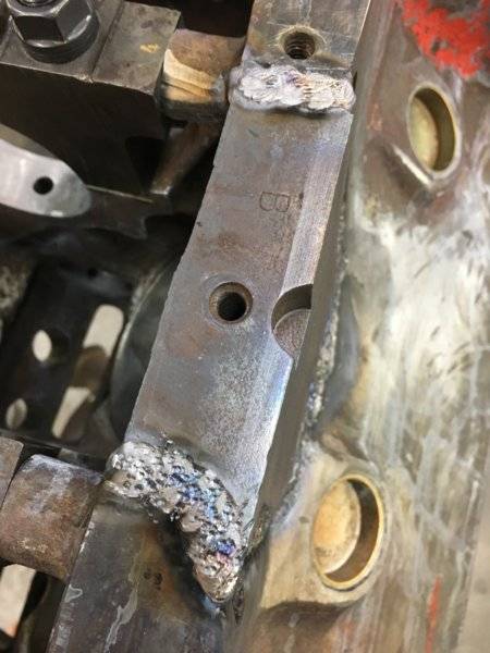

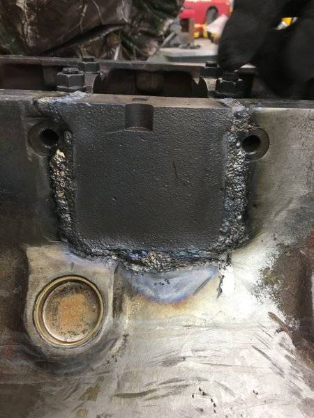

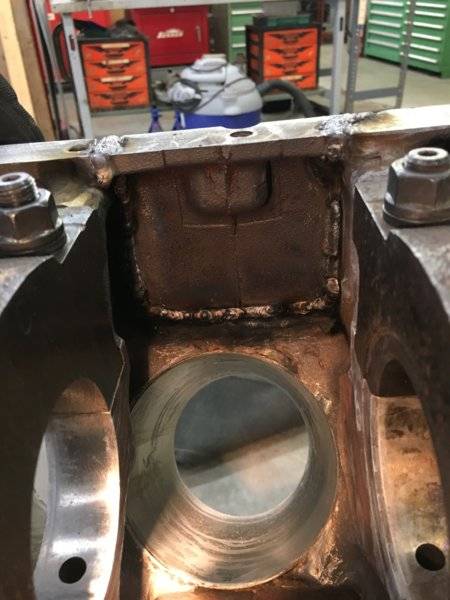

I just tig welded this hemi block.

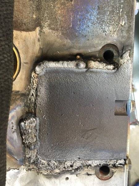

We used a product that works amazingly well. The middle picture shows a bead in as welded condition before my old school assistant peened it to death (it didn’t need it at all).
