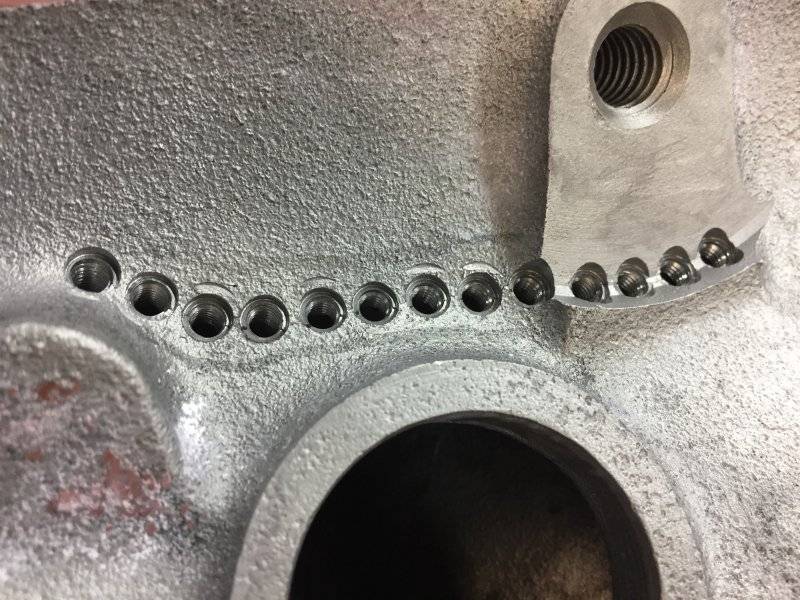

Check out this 440 block repair!
TruckManiaMike
6:21 PM
Feb 5, 2024
59
25
California Maryland

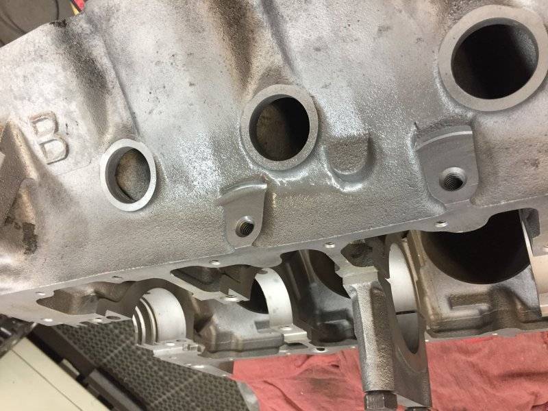

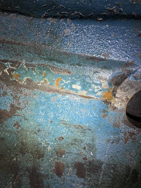

Just got the motor pulled and during cleaning I found this….never leaked coolant before so I guess I’m going to roll with it! Somebody beat/tapped in 17 1/4” rods into the side of my block. Did not see a crack where it connects to freeze plug….anybody seen a repair like this before??
Yes, I've seen something close to that in cast parts called "stitching". Being in a water jacket like that,
I would drill out the threaded rods and have someone TIG weld the area with a product called TigTectic 224.
It is designed for repairs in castings. I fixed a few inboard engines with the stuff when the people didn't
drain all of the water before winter. That repair might hold, but I couldn't build an engine with that known
fix! The filler rod is made by a company called Castolin-Eutectic. Works excellent!

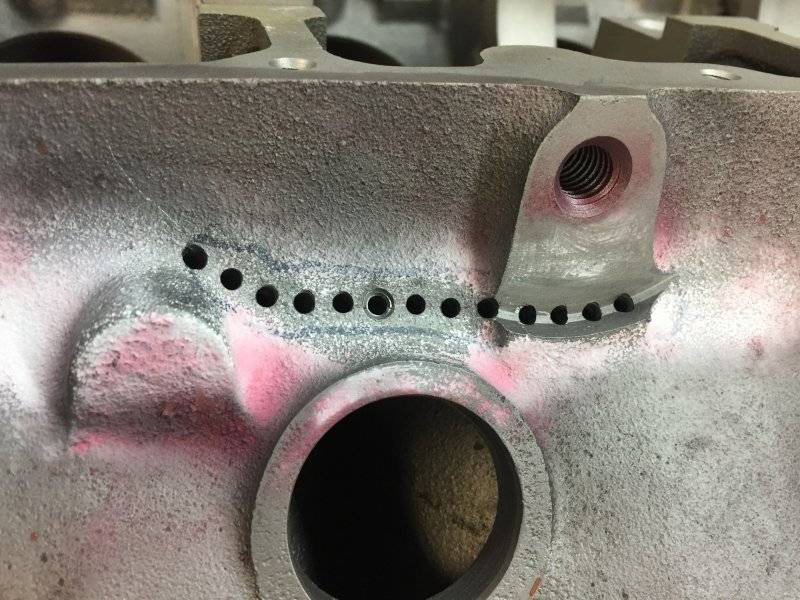

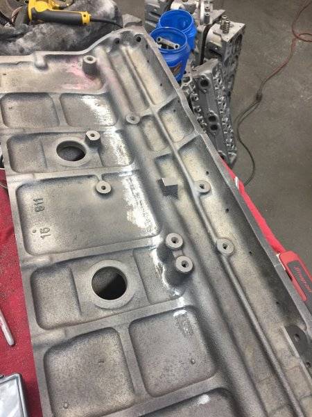

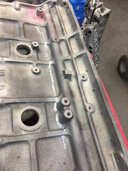

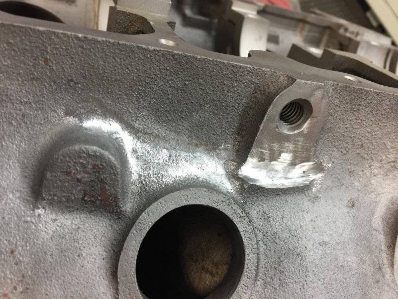

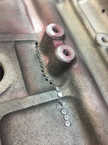

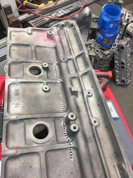

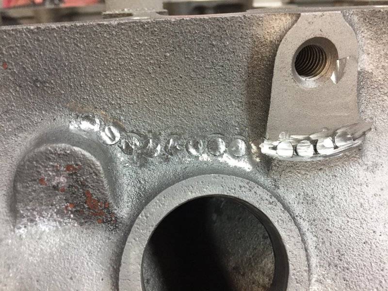

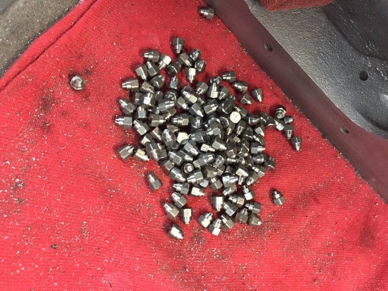

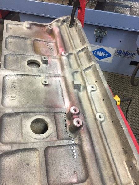

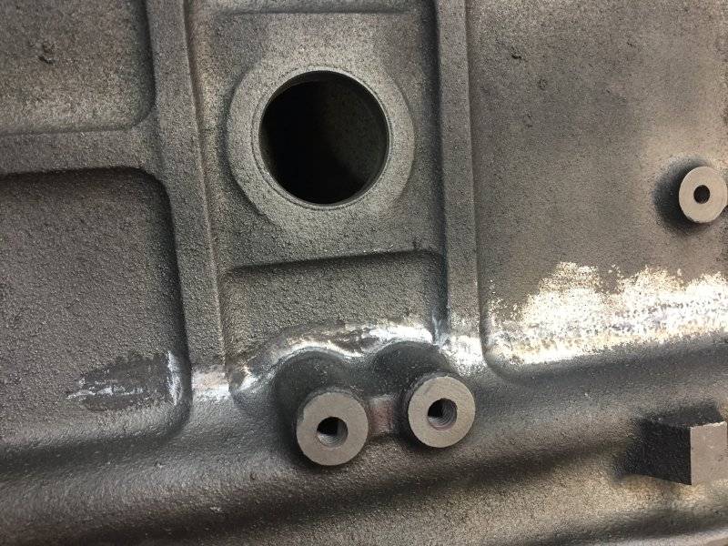

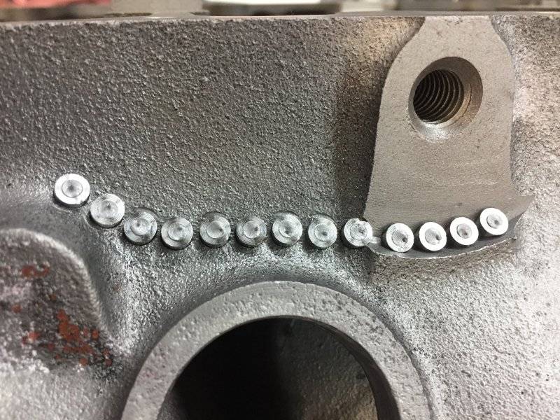

Thos pins are an older type made by a company called "Irontight", a division of Kwik-Way. I don't like them because they tend to open the crack due to the tapered pins. I do not weld any cracks, because if it is not done properly, you can create more issues than you started with. Stick welding is not the approved method of repair, but can work if an oven is used. The key is to keep the repair area and block hot, and a long cool down in the oven to prevent spider cracks from developing. High nickel rods are a plus too. The best method is a type of molten metal sprayed onto the repair. A special torch head is applied to an acetylene setup, and powdered metal is introduced into the flame, melting it, and sealing the properly dressed crack. Can "Redneck" welding fix cracks? Sure, but I have seen a lot come to me that re-cracked and were leaking. I use a "Cold Welding" system from a company called "Lock-N-Stitch" that uses pins that have a reverse rake on the threads which pull the crack together. Same method as pinning, but accomplished a different way. Here are some pictures of a GM 235 block that had a 17" crack that I repaired. I have seen the customer over time, and still does not leak. Pics not in any particular order, but ID the length of the crack, start drilling and tapping, wash/rinse/repeat. Pins/holes are staggered in order to prevent turning once installed.
Had to make two posts... I think it took 135 pins to complete, and about 7 to 8 hrs.
Nothing to worry about. I have seen that repair on a 440 between 2 "frost" plugs (or core plugs so I don't get yelled at) many years ago and it never leaked. The last pin at each end is at the end of the crack to stop it from growing that is why you don't see a crack there it never made it there..
