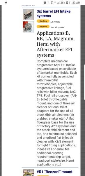

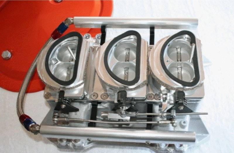

Unfortunately you cant use your original 6pack manifold. The one they have to use is a single plenum.This is the mechanical and performance work of art by F&B.
Costs around $2,600 (may be less with you supplying the 6bbl intake manifold) and then you have to add a control system to it.
View attachment 655505 View attachment 655506
Indy mod-man intake with a 6 bbl top.Unfortunately you cant use your original 6pack manifold. The one they have to use is a single plenum.
That's the one he said.Indy mod-man intake with a 6 bbl top.
