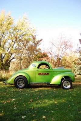

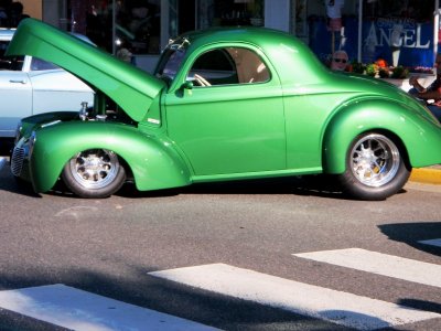

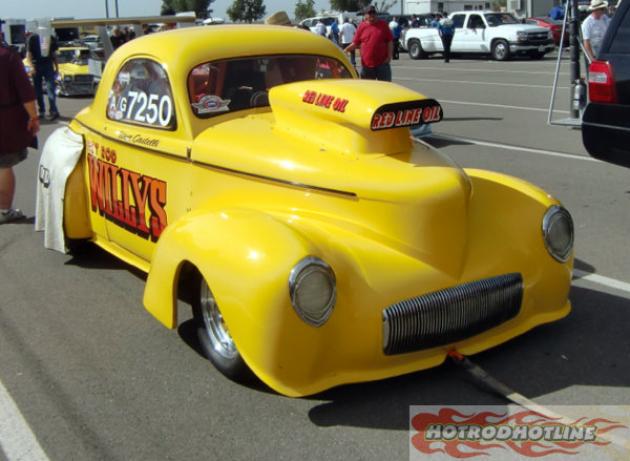

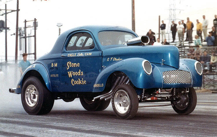

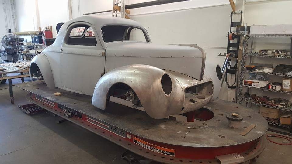

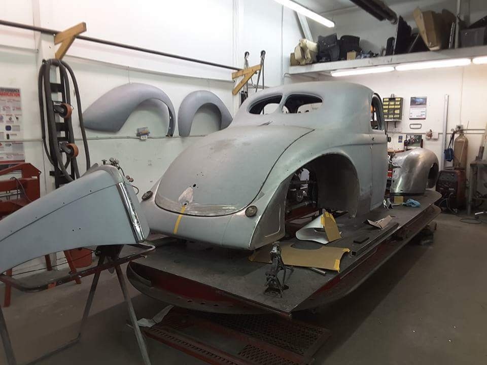

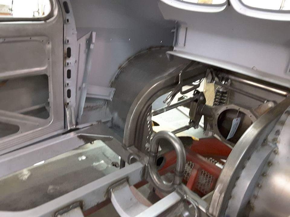

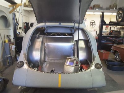

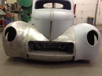

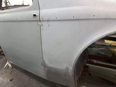

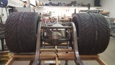

Finally starting to move a bit. Recd the modified rear clip from Art Morrison and began by attaching it to the front and attaching the body. Setting this up similar to a B Body UniBody.
Looking good. I'm a huge fan of big tires.

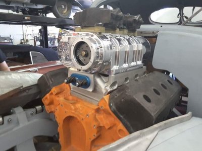

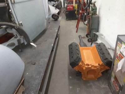

Bad ***!! That plastic block seems to have the distributor hole in the wrong location. Will you be using a distributor??

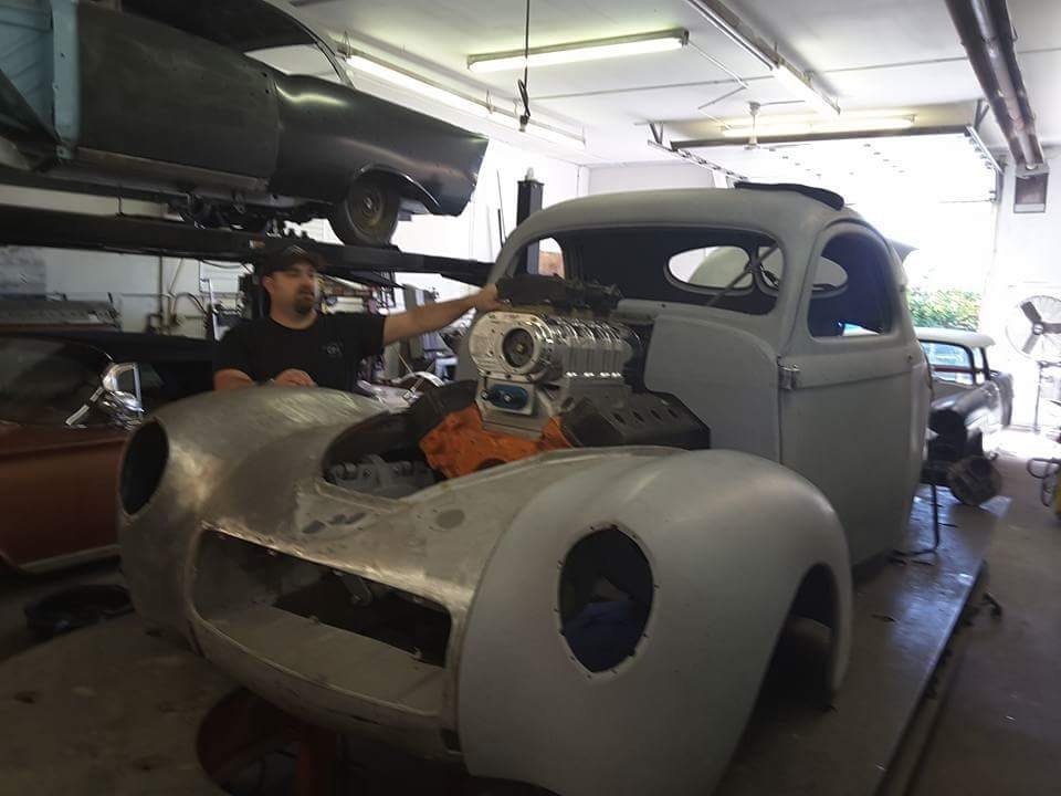

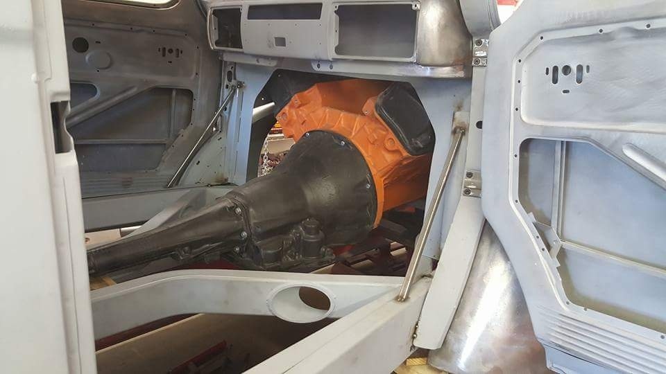

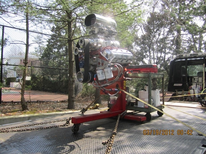

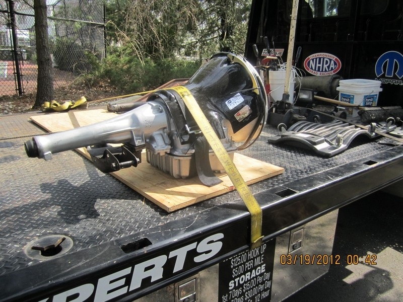

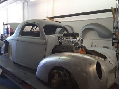

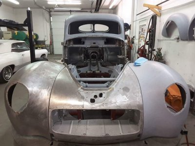

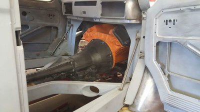

Some update photos. Asked David Barton to send the blown hemi that he was rebuilding over CPI. They don't trust a fiberglass dummy as we are dealing with 1/4" clearances. Going to use it to accurately set the engine, trans, and O/D mounts.
FB_IMG_1477238894503.jpg FB_IMG_1477238906176.jpg FB_IMG_1477238920868.jpg FB_IMG_1477238965537.jpg FB_IMG_1477239002173.jpg
