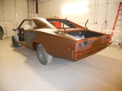

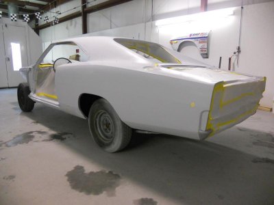

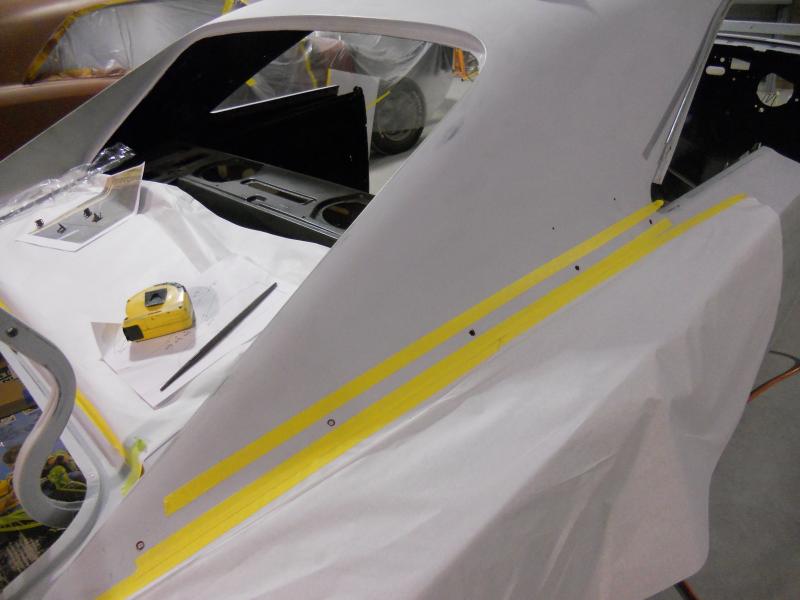

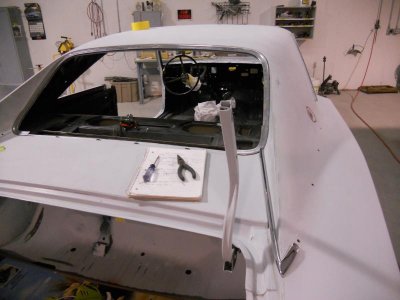

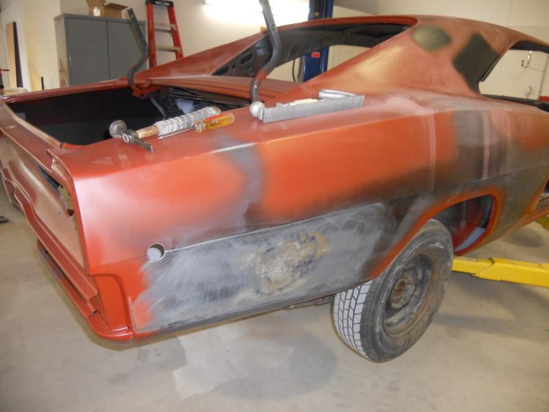

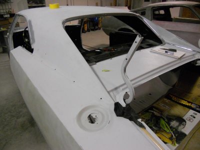

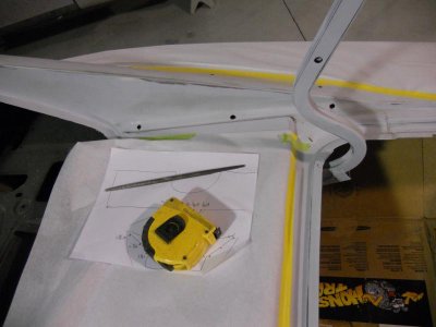

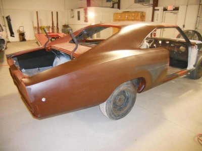

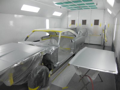

Speaking again of modifying new parts, when both new quarter panels were unpacked I noticed both were stamped with a slight bulge behind the wheel and below the body line. Rather than try and alter the shape off of the car, I waited until they were solidly welded before doing any metal work. To get them to come down I used a sharp awl and body hammer and very lightly tapped in a circular pattern to shrink the surface down. Then I used a metal file to check my progress. I'm sure it took over a thousand strikes to get it down, but by going slow it never oil canned on me and I never had to knock it back out. Eventually it was close enough to finish with a light filler coat.

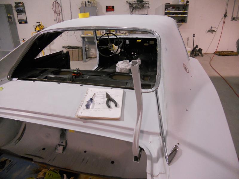

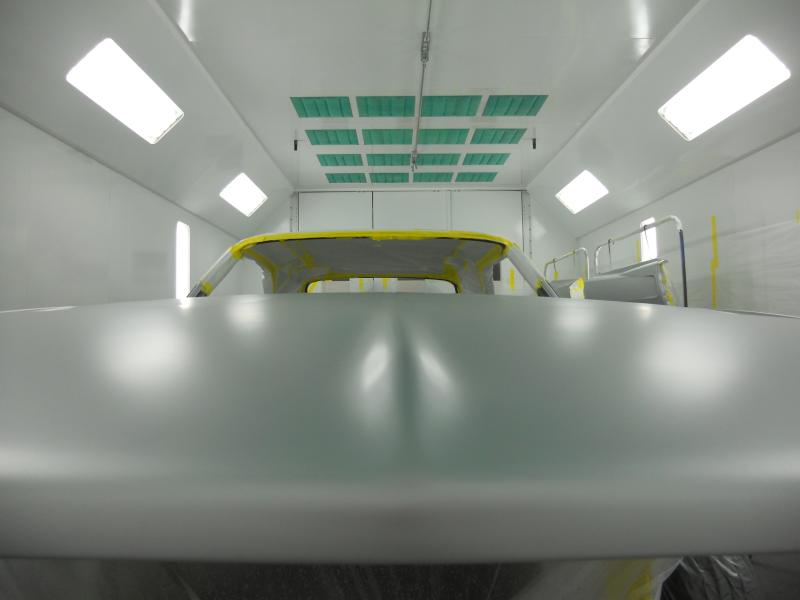

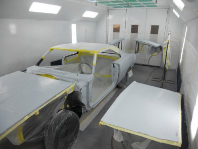

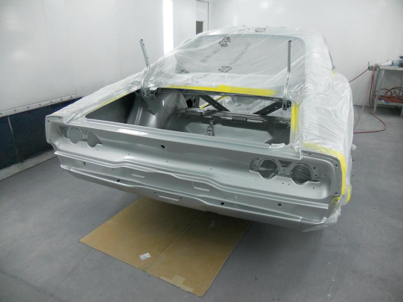

The filler work was then sprayed with DP epoxy primer and K36 primer. This is also when we finally had our moldings to check for clip hole locations. We checked the fit and hole locations against the measurements taken at the the start of the project. After a series of hand blocking/priming/blocking, it was ready for final primer and a mist coat of green base. The green base serves as a "tracer" or "shadow" coat for the last sanding for paint work. When all of the green has been sanded off with 600 grit, the surface is paint ready.

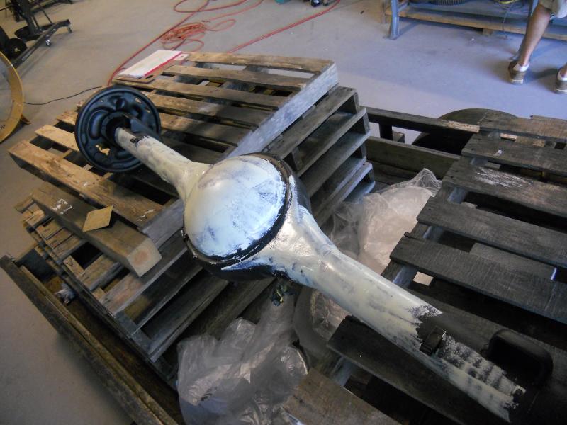

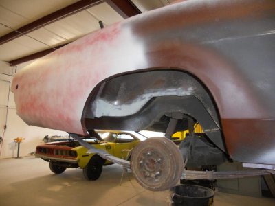

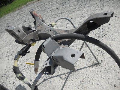

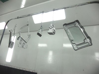

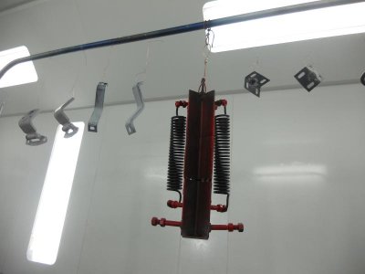

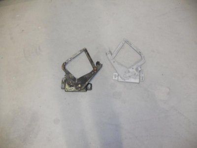

Here are some pieces after blasting them clean. Next step is black epoxy and filling imperfections, like rust pitting.

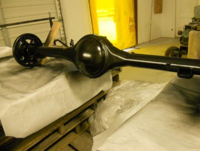

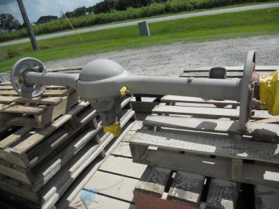

Had to say, the pallets are what i used with my leaf springs and rear end, they make a good home built bench for things like this!

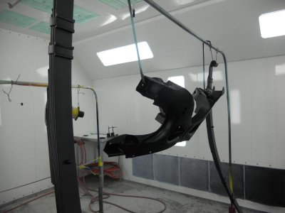

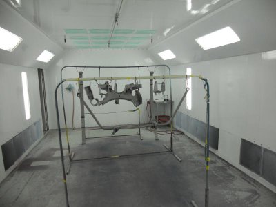

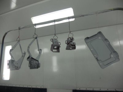

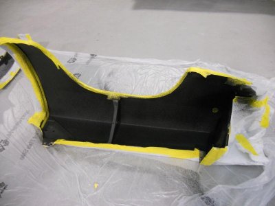

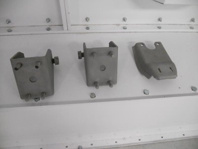

Nice to see how the pros do it! What kind of primer and or paint is going on the under body stuff, K-frame, etc..?

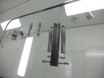

Generally all of those type parts get 2 coats of PPG DP90 black epoxy, followed with PPG Deltron single stage 9469 black. It contains a flattening agent, so it gives a little more gloss than the DP, but not high gloss. I don't like to use the light colored epoxies or gray high build on those parts because any nicks or chips from assembly or road exposure look really bad against the black top coat.
Next time I'll post pictures of some parts painted.

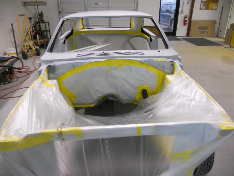

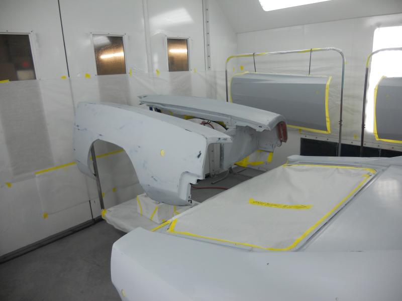

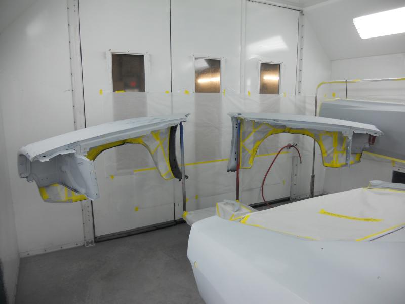

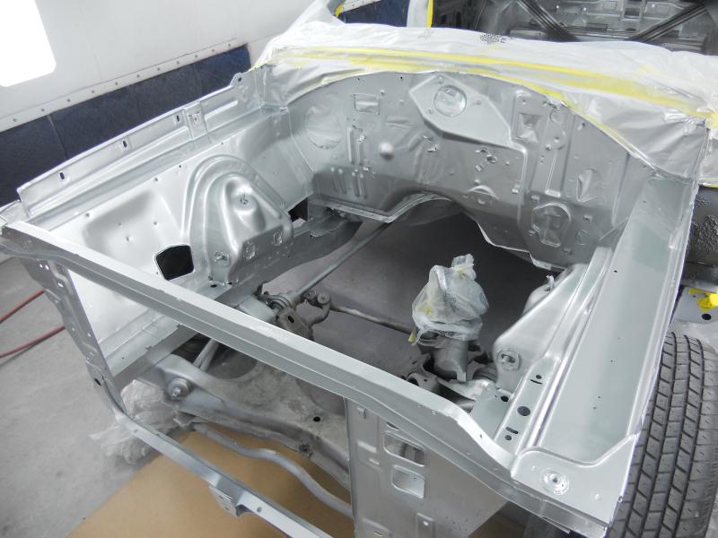

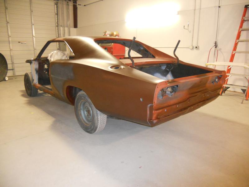

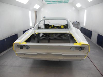

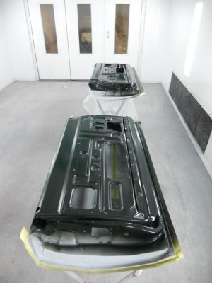

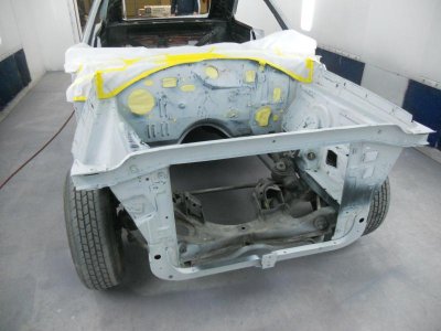

Here we have gotten color in the engine bay, trunk area and rear body panel, all areas to be masked off and covered when the rest of the car is sprayed. The same with the doors, hood and trunk. All have been finished on the insides and will be covered for exterior spraying that soon followed.

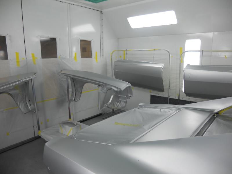

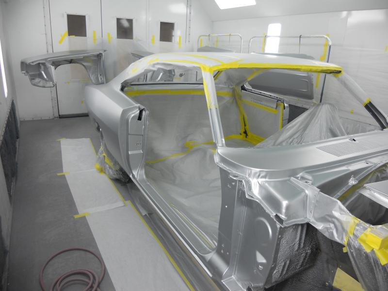

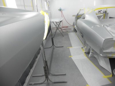

In base coat
I'll post the rest of the pictures later, don't have time now to load pictures of the finished paint work.
