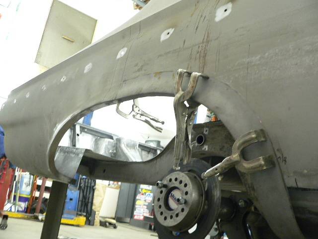

I learned to make my own as nothing was available. Plus the front of the wheel well was being moved forward 4".

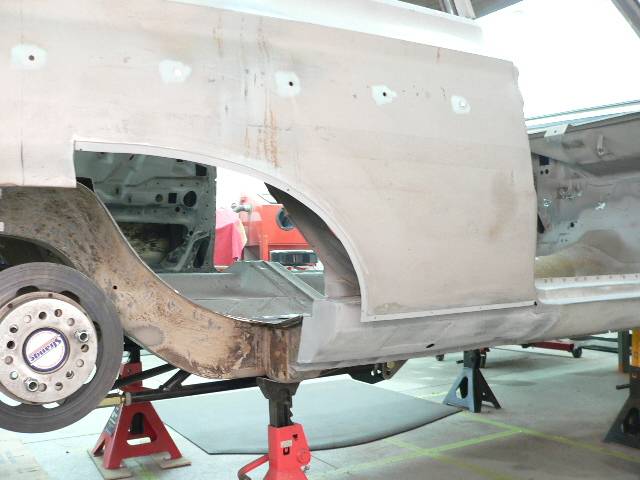

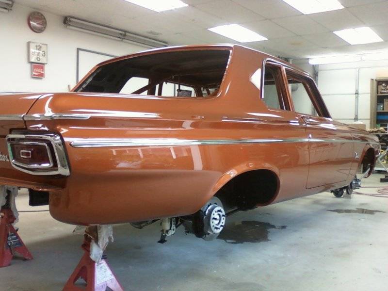

Autobody specialties was the first on offer those. But that’s a piece “easy” to build

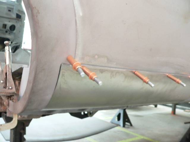

My car got quarters made locally by a shop then made to fit by the body man.
Lower fender patches were made by him

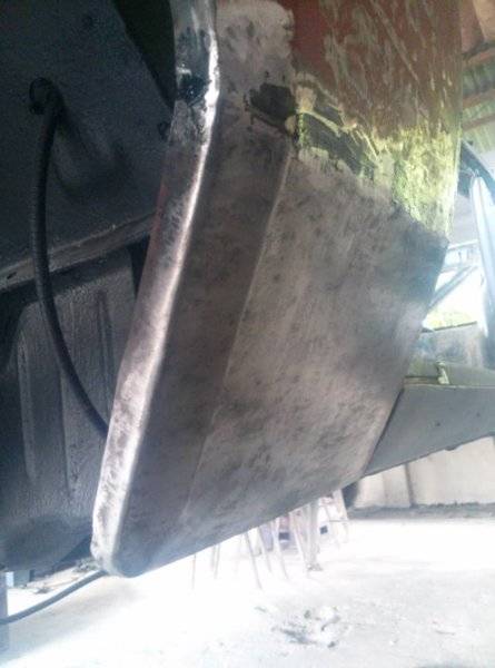

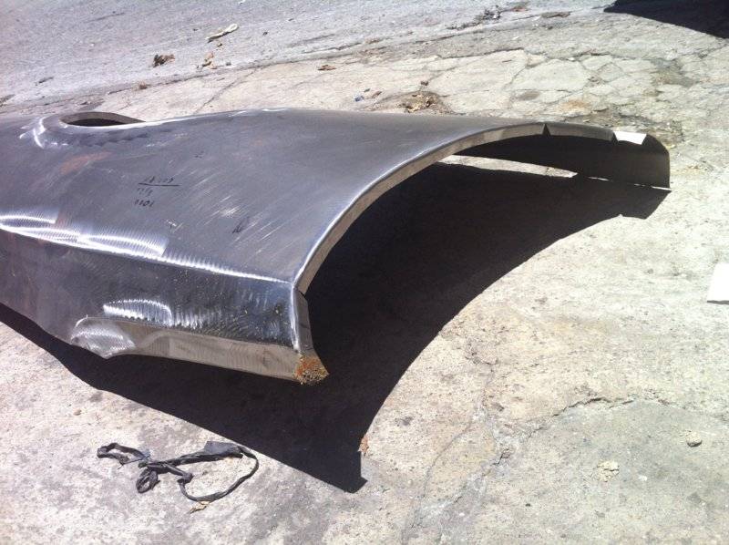

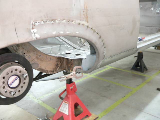

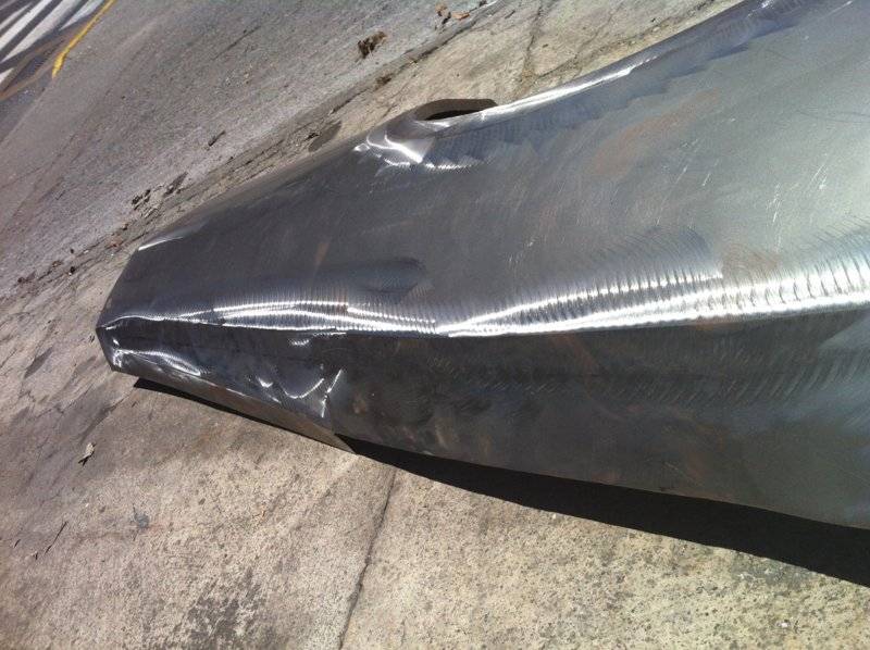

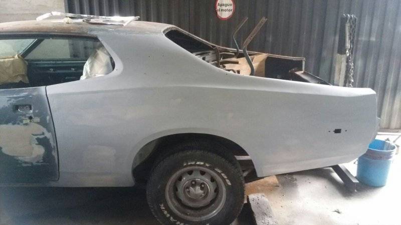

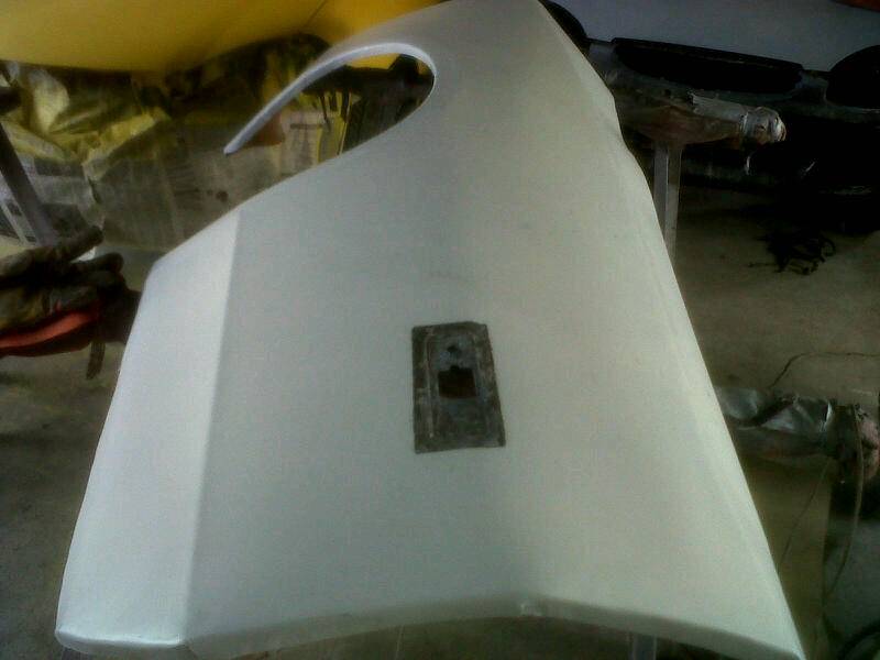

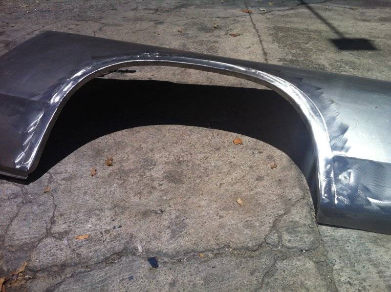

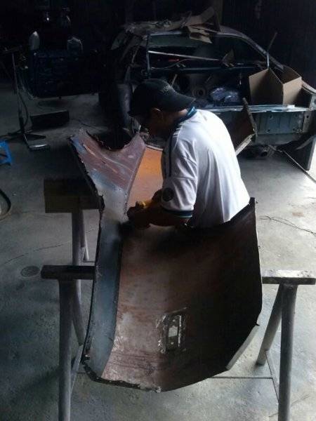

THE FENDER “DOG LEG” made in home.

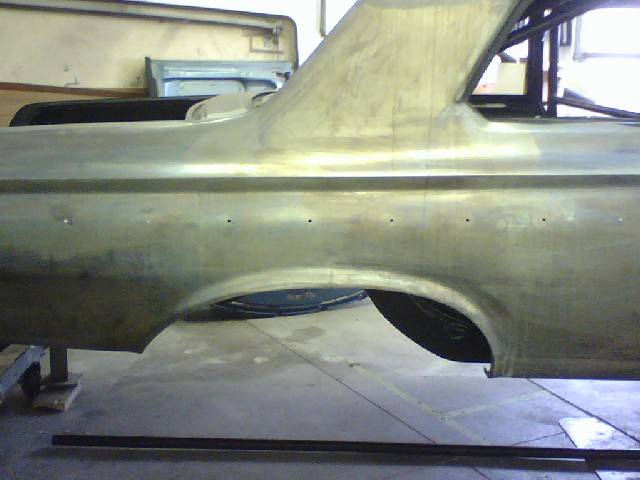

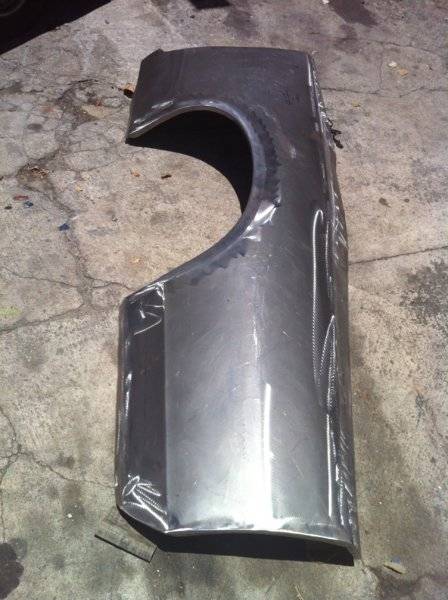

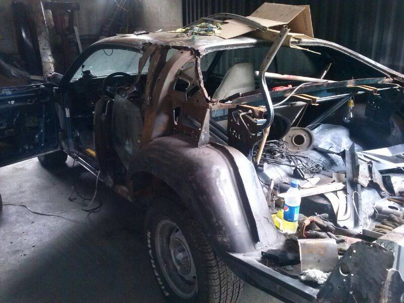

REST OF QUARTER PICS MADE BY A SHOP IN VENEZUELA... I got a NOS PANEL out of ebay in USA to ship it to Venezuela and get the shape correctly done. Both quarters were made the same.
Sidemarker area was cut from the original one and welded to the skin made

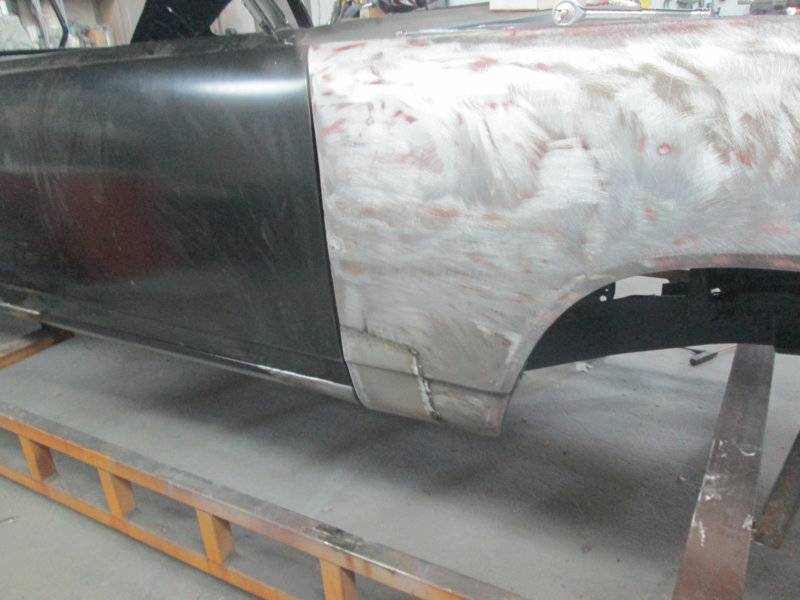

I ordered the lower doglegs from Sherman for my 71. I know they are different for the 73, but will give a few points to consider:
#1- the patches metal is thicker than the original fender. Alot thicker almost twice, and the 71's( not sure about 73-4) have an inner brace that the steel needs to be bent around 180* kinda like a door skin so it was very difficult to metal finish because of the thickness(surface height). It would have been so much easier if the metal was the same thickness(or somewhat closer).
#2- because of the thickness, the body lines were not "crisp" (angles not as sharp as original panel lines)
#3- most metal I've replaced on my 71(lots), was AMD or goodmark. These were the only from sherman that i used and the pieces weren't EBT coated like all others but actually had sort of a galvanized coating on them wich made it difficult to weld, smelled odd, and made me worry about the "parachutes" of gases being released into the atmosphere when striking the arcs...
These were cheep, but was buying other stuff from the source that offered these so I baught them. I should have chucked them & got other parts from another manufacturer, would've saved a lot of time & labor to make them look right.
These are important hings to consider, and nowhere did I ever see/hear feedback +or- about these patches. Live & learn... Thats my 2 pennies...
