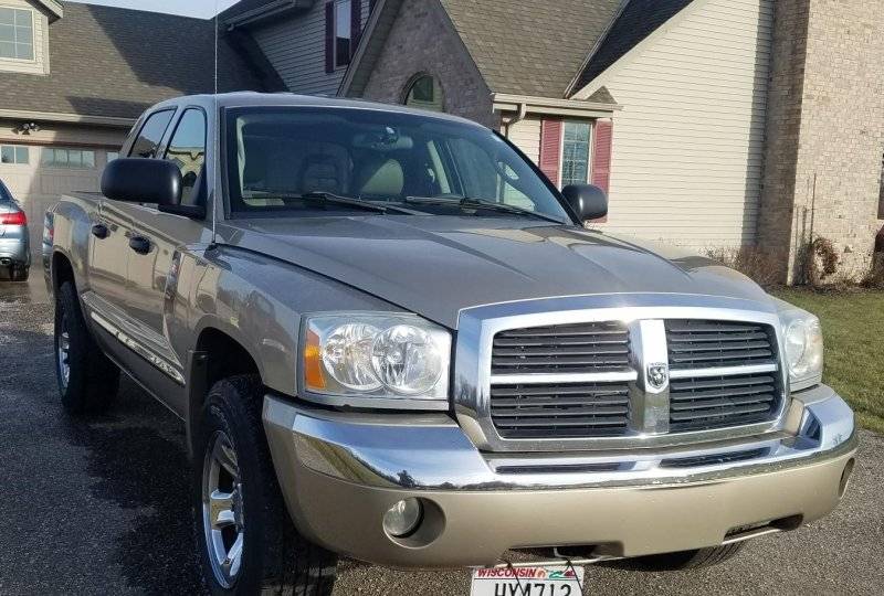

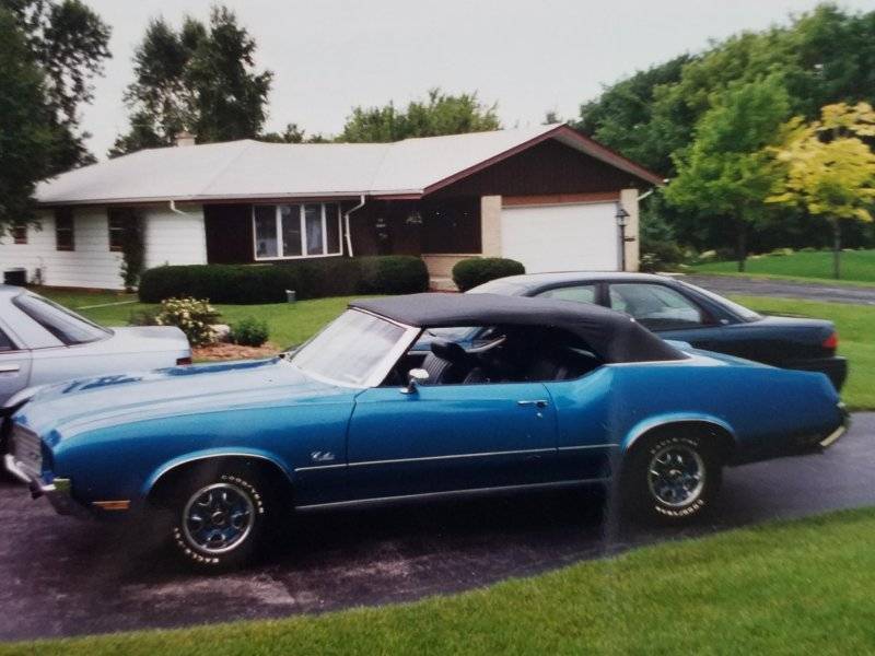

First resto we painted in the driveway holding for a good day. Only thing was one of those dandelion puff balls landed on the rear deck btw the window and deck lid after clear coat. Gently lifted it off and was noticeable if looking close for it. Dakota box and fenders were painted in the body shop before mounting those. The cab, hood, and tailgate are original paint. Most noticeable shade off are the repop fenders. Different batch used for those. Box came out pretty close. But, this is my daily and didn't see need for full repaint.
