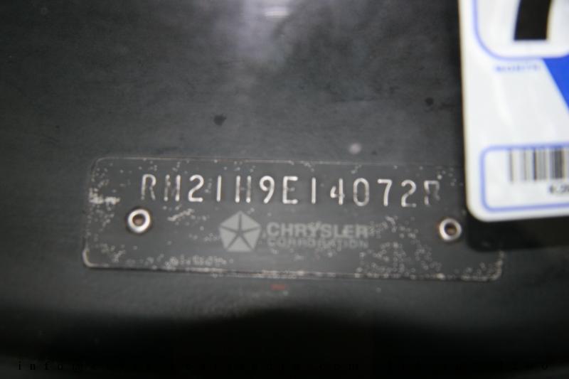

(Glhcarl) Does your rivets look like mine? Any similarities?
Searching google images of 1969 roadrunner vin plates so I can compare the rivets. I found this pic that appears similar to mine. What do you guys think?

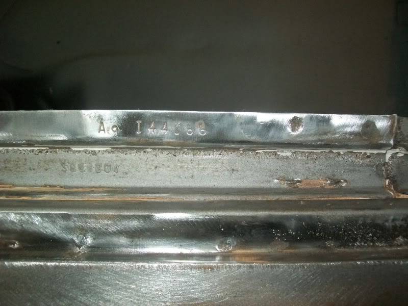

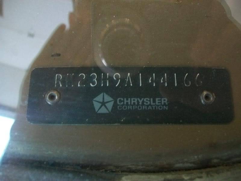

Dude I'm going to walk out to my 69 right now and snap you a few pics that i hope can help.
hang on.

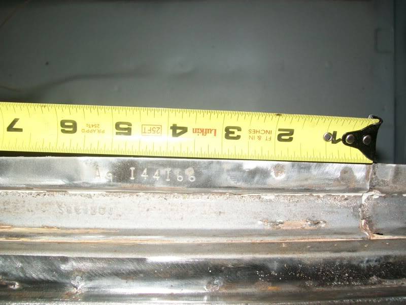

here's the trunk lip stamping, it's there man, see I couldn't find mine until we got the paint sanded off but we found it.

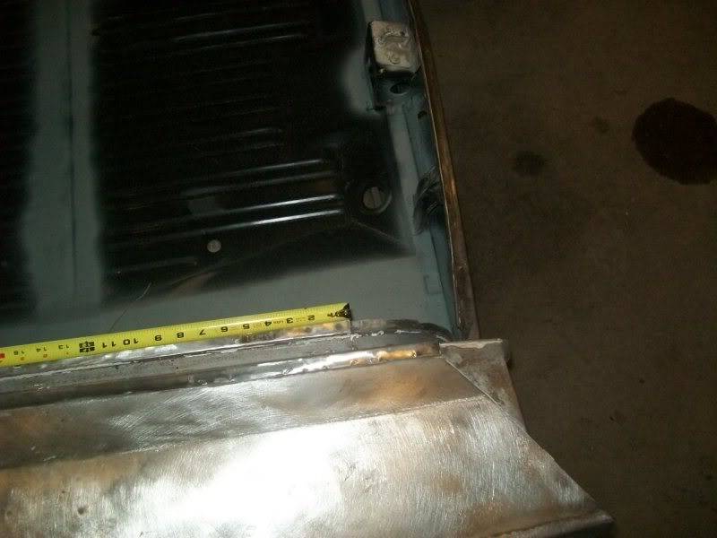

and here I'm trying to show you exactly where to look.
here's my dash plate, note the rivets, way different from the ones you showed for what ever reason.

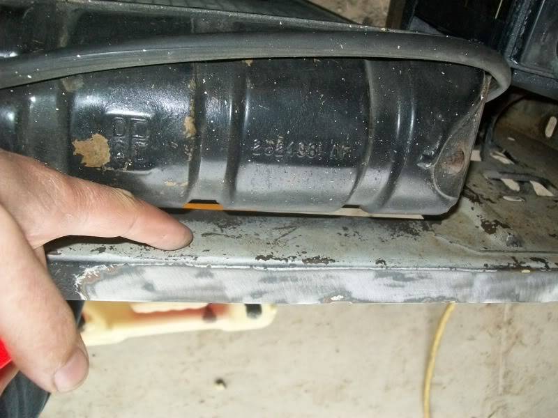

and of course the rad support stamping which faces the radiator tank on my car.

Thank you for taking the time to take those pictures and measure the location.
The seller just did a quick check for the trunk drip rail stamp. He said he could not see anything. But it may be there under a few layers of paint.

So true, without trying to sound like a dick, those look like aluminum hardware store rivets.
A guy really has to wonder why?
drag race history, dash plate rivets....

I hear ya man, but there is some personal ownership value to knowing the title does match the body.
I think folks look in that trunk lid gutter for the numbers but as you can see they are actually up out of the gutter on the inside lip right under the weatherstrip.

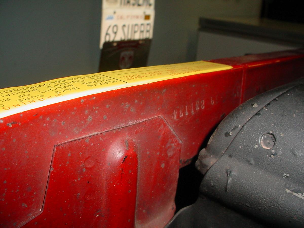

Radiator support VIN stamping:

(Welder 47) The rad support number matches the vin. But I guess the whole support could have been taken from another car and welded in place.

A few corrections to some othe the previous posts although some may have already been addressed
1. Yes the V.I.N. tag rivet are wrong and always brings the question why?
