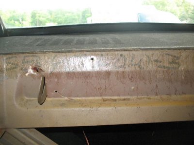

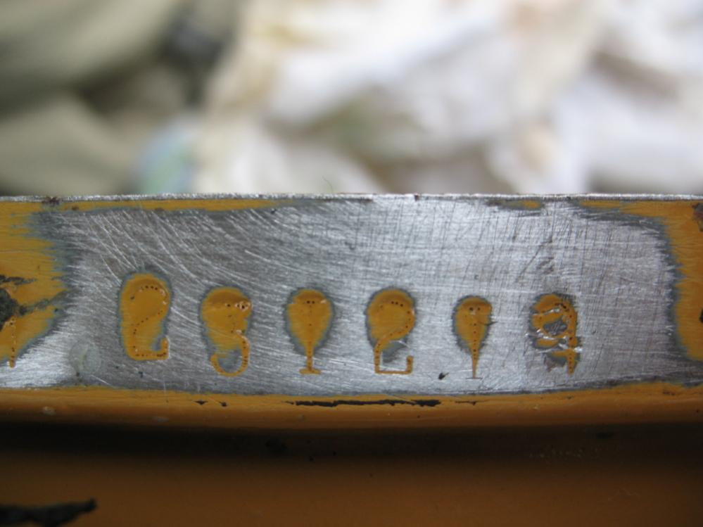

I went on Thursday to take another 180 mile round trip to check the trunk rail. With the help of the measurements from Dave, (Thanks again Dave!!!!!) the owner and I mapped out the location. It took nerve but the owner ran in the house to get 100 grit sandpaper because we could not see anything. After some vigorous sanding, it was discovered to be a matching number with the vin, fender tag, radiator support, and the title.

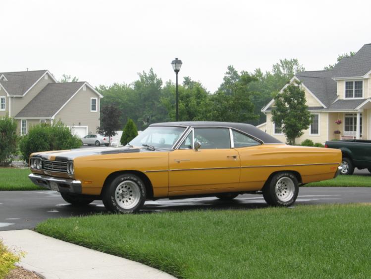

I picked her up today. A 95 mile trip home with a smile the size of Texas. Stopped of to get her some goodies. I was going to take her to the show on Landis ave. Vineland, NJ tonight but the weather is too threatening.

i dont know about the 69 b bodys but the 70s you have too pull the windshield too pull the dash when i did mine they didnt repop the rivots
i stripped another 70 rt and used that dash but i did put the correct vin on the dash before my glass guy came too reinstall the windshield and id be hard pressed too pull all the mouldings/windshield/ inside trime/ too put two rivots in/ mine are the same size painted black :icon_fU:

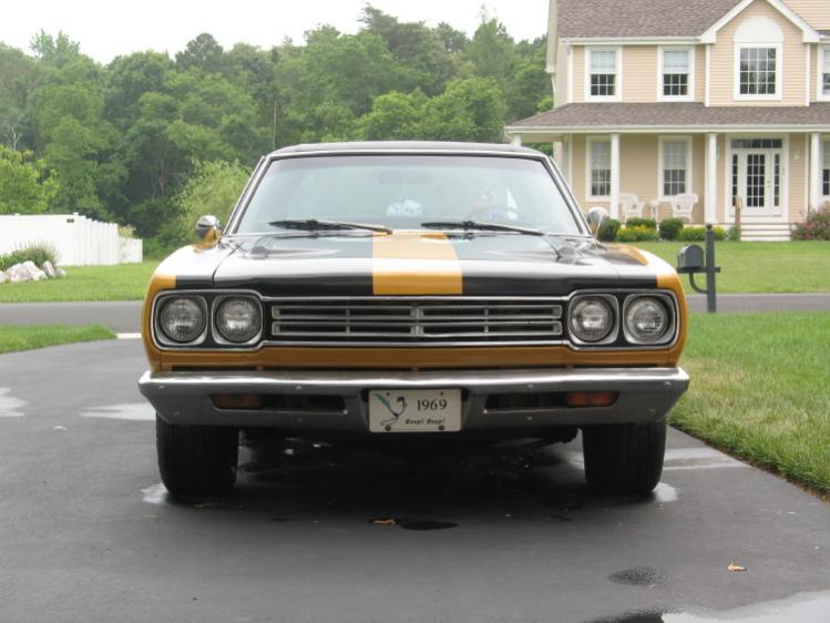

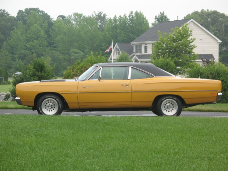

Nice looking car. I love that color - especially if it is original. It's too bad someone had to permantly attach that side molding instead of using the double back tape variety though. Enjoy your new wheels.
I'll bet the dash was out during it's drag race days, but they hung on to the vin tag. When they put her back on the road they found another dash, and used cheep pop rivets to reattach the tag. 45 bucks will fix that. 99 99 paint code I have seen on special order colors. I bet it,s a real roadrunner.
