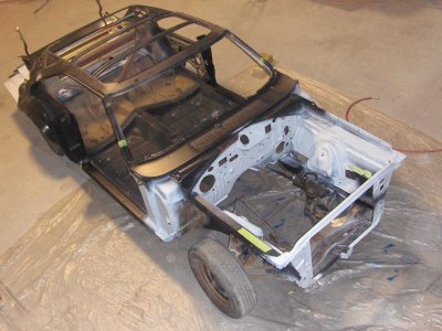

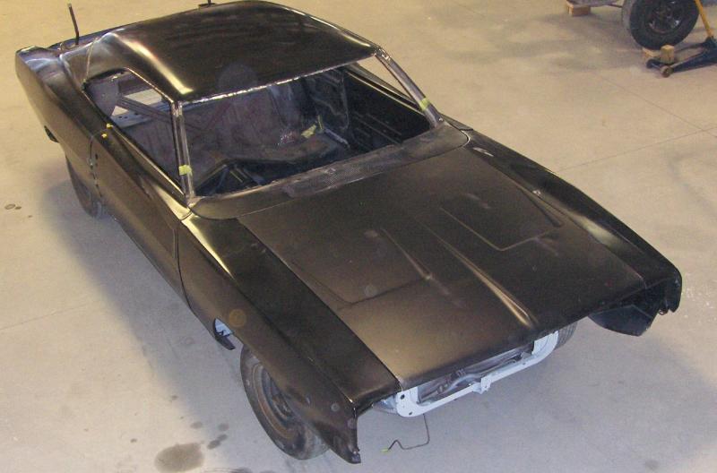

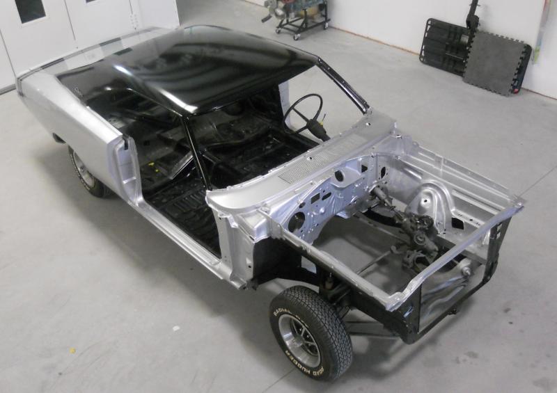

Impressive Barr's....been doing this for a minute or two haven't You. You ever done a top chop on a 68-70 B-Body? I'd like to do it to a 4 door...think the profile would just be wicked. I have come to appreciate the 68/69 Coro 4 door's Lines...i really like the quarters w/o the dummy louvers (don't like form w/o function) and the way the lines work coming into rear door really make more sense than they do on two door..w/ two door there is one upper line that virtually stops @ the b-pillar....on four door that line does a prettier fade into rear door, and the lower coke bottle line seems to be couple notches more definite and the mirroring of the upper & lower coke bottle is a couple notches brighter too, IMO...........but oy vey, the amount or work...i'd like to drive it once or twice before i cak, so with all the other crap i want to do, i'll probably pass, or farm that one out to a place that has a crew that is capable of handling that one aspect in a month. Major chunk of dough that i could use underneath for transplants, but Vanity is, ....well....Vanity.....the other thought i had that wouldn't be as much work would be to cut rear cowl and fast back the car with a shorter deck lid and put the tall boy on, i'd leave the nose 68 unmolested though, i like the air grabber nose cavity w/ honeycomb grille, even though it isn't perfect aero. Nice looking outfit You have Barr....bless you for having figured out how to survive @ this trade and it looks like You're doing nice, well thought out product. Bladevan chop.jpgchops 1.jpg
