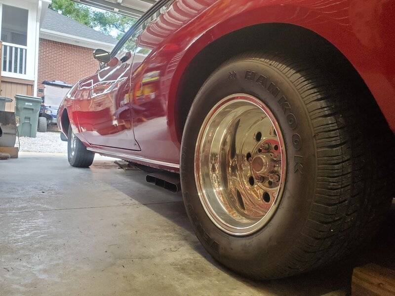

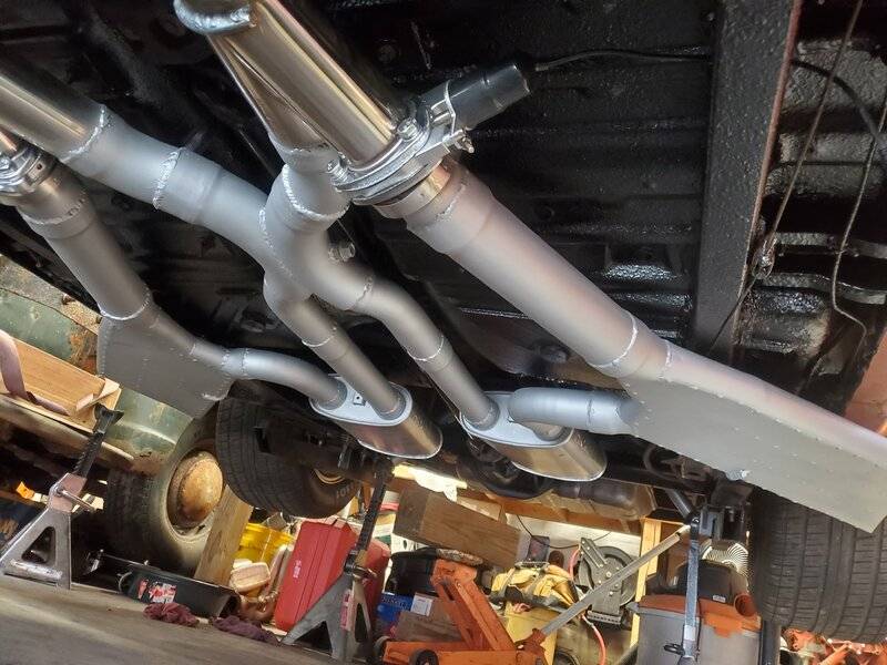

It does have some weight to it. I don't think it weighs alot more than an exhaust system that goes all the way to the bumper. I wanted something different and wanted both sides, loud and quiet.
It's back in now. There's a few things left to do before I let it down and drive. I do think it has a good sound right now but I will find out when I drive it.
I've always been a fan of straight pipes and have found ways to make them 'quieter' but need to fab one that 'looks' like the system has mufflers. So far with a straight on my diesel, it's passed inspection every time for the past 20 years and with no evidence of it having a muffler! Must be something with the turbo setup.....?

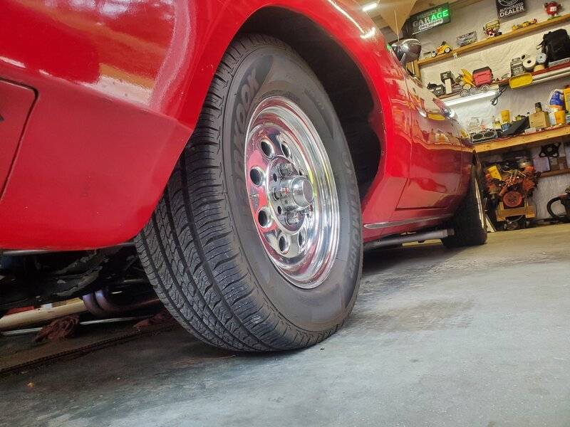

I will say that going thru the mufflers the car is not bad but when the cutouts are open it it LOUD. The tips act like a megaphone and magnifies the sound. It does sound really cool but it is loud. It's not too low and hasn't hit anything yet. I measured 4 1/2 inches off the ground.

Seems pretty quiet even with the cut outs open. I bet you’re getting some chambered sound muffling with the multiple paths the exhaust can take with the CO open.
I think this tips you made are acting like a chambered muffler. Both sound good. I’m sure it would be a lot of work, but I’d like to hear it straight piped with just those tips.
