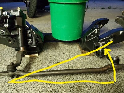

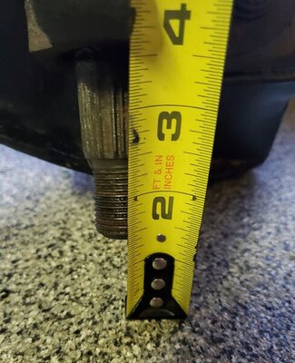

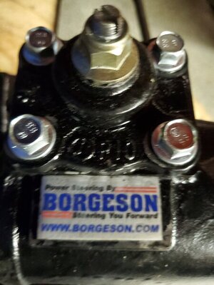

Guys i am over thinking this? Doesn't look right to me , I suspect an issue unless this is normal. I plan on calling borgeson tomorrow. Installing new steering box , pitman arm & idler arm. When I put it all together on the k frame, via torque specs. The draw bar / center link is almost 1 inch lower on the pitman arm side. So it looks "kitty wumpis" I scatched my head for while and think I did something wrong... I took everything back apart and reinstall the original stuff compared to new & took measurements, then installed 1 pc at a time. The new pitman arm very close and idler arm is too. Mounting the new and oem box. I see the borgeson is almost 1/4" longer where the splines start. Which may be the whole issue?? See bunch of photos below.
I marked how it wants to sit with the borgenson box. It's best example I can show, hope you get the idea...

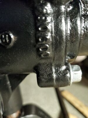

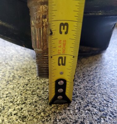

Steering box measurement.
oem in first photo,
Borgenson in second.
You can see its about a 1/4" longer.
These are both bolted to k frame , sitting on the floor.

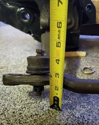

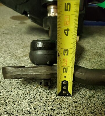

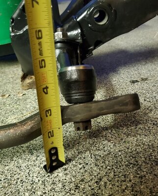

New parts , measuring from the floor you can see its off. Note the height difference from one side to the other is nearly one inch dropped o. The pitman arm side.
First pic is borgeson box and pitman arm side.
second pic is idler arm measurement.

Here is the oem steering box and pitman arm. Approx 2.0" to the floor.
I think the only way you should reference measurements like that is when it’s bolted to the k-member. Do that then measure down from the k-frame. Also the pics are kinda confusing and not clear what we’re looking at?
These are all bolted to k frame , the k frame is out of the car on the floor. I labeled what is in the photos accordingly. Hope this helps.
Have you compared the drop of the pitman arms?
I bet it is slightly off as well and together with the additional 1/4" lower spline portion is giving the observed drop on the driver's side.

Do you have the pitman tightened and torqued onto the borgeson sector shaft fully. Looks like maybe there is some more spline to go? Also as chargerst said, have you compared the bends of the two pitman arms?
It also looks to me like the pitman arm is not in the same spot when you are measure it. The arc or travel of the arm will make it go higher and lower as it turns from side to side. It is travelling on a circle (the sector shaft) mounted at an angle off the k member. Does any of this make any sense (I’m finding it hard to explain)
Thanks 4mulas for the input; i had used old and new pitman arm to end up with same measurements. The new pitman arm does have a pronounced curve, which i thought might affect it as well. but the height difference were eventually the same wither i had the new or old pitman arm in place. i do have that photo, but thought it unnecessary to add it as it was same height. it is made by different mfg (Proforged) vs the old one was Moog. i'm considering to pick up a Moog Pitman arm , just to eliminate that indefinitely .

is the mounting face parallel to the output shaft centerline? Is the distance between the output shaft centerline and mounting face the same on the old box vs. the Borgeson box?
well , i ordered a idler arm and pitman arm from PST. same results ! actually gained another 3/8" tilted off! i used pitman and idler arms that gave me best the most "level" bar i could come up with. I've also talked to Borgeson serval times, sent them all the photos, eventually they had their "management" review & they said it's fine like that and run it ....
Having really no choice at this point. Asides going a completely different mfg's steering box. I'm convinced the angle was caused by the box, EVERYTHING was replaced with different manufacture's parts , that was the only variable. like i noted, i've sticked the OEM box back in and it was level. :(

Hi. I experienced the exact same problem as you with the center link not being level on my 69 Charger. I spoke to Peter Bergman at Bergman Autocraft. He told me to shim two of the three mounting locations for the steering box about 1/8”. I did this and it greatly improved the center link angle. I have not driven the car yet, but I am assuming that it should be fine.
