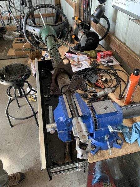

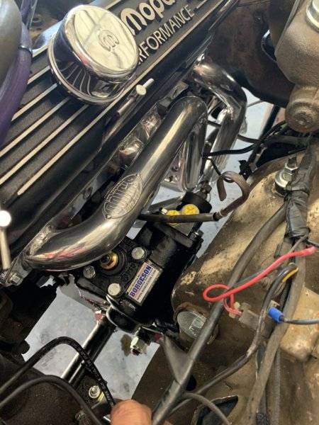

I just finished this mod. I honestly think it was super easy. I pulled my entire column, and to measure, cut, and install I had maybe 4 hours in total. I sandblasted and painted my column during this time too. The most difficult part was taking the correct measurement for the column. Borgeson directions are a little off. I measured from the top of the large hole in the firewall to the tip of the coupler (separate part you need to buy) then I added approximately 1.5 inches to my measurement. Cut it down with a saw, then drilled the three tap holes for roll pins and it was done.
I did decide to convert from a Saginaw pump to a federal style from Borgeson, and I’m having some clearance issues with my electric fans but all in it was an easy process. No lifting of the car was required, and I have Doug’s Headers.

View attachment 927693 View attachment 927694

I didn’t even realize that this was an option until after the install was over. I needed to pull my column anyways because I’m installing an Autometer Dash bezel and needed to sort out some wiring issues before I started. It seems like a lot of work, but it really wasn’t that big of a deal. My factory coupler was shot anyways, had tons of play and was seized up so I had to cut it off to remove it.
