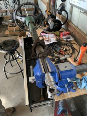

I just finished this mod. I honestly think it was super easy. I pulled my entire column, and to measure, cut, and install I had maybe 4 hours in total. I sandblasted and painted my column during this time too. The most difficult part was taking the correct measurement for the column. Borgeson directions are a little off. I measured from the top of the large hole in the firewall to the tip of the coupler (separate part you need to buy) then I added approximately 1.5 inches to my measurement. Cut it down with a saw, then drilled the three tap holes for roll pins and it was done.
I did decide to convert from a Saginaw pump to a federal style from Borgeson, and I’m having some clearance issues with my electric fans but all in it was an easy process. No lifting of the car was required, and I have Doug’s Headers.

Wouldn't it have been easier to use Bergman Autocraft's adapter so you wouldn't have to cut the column and all of that? That's good info on the Doug's headers because I run those too...
I didn’t even realize that this was an option until after the install was over. I needed to pull my column anyways because I’m installing an Autometer Dash bezel and needed to sort out some wiring issues before I started. It seems like a lot of work, but it really wasn’t that big of a deal. My factory coupler was shot anyways, had tons of play and was seized up so I had to cut it off to remove it.
