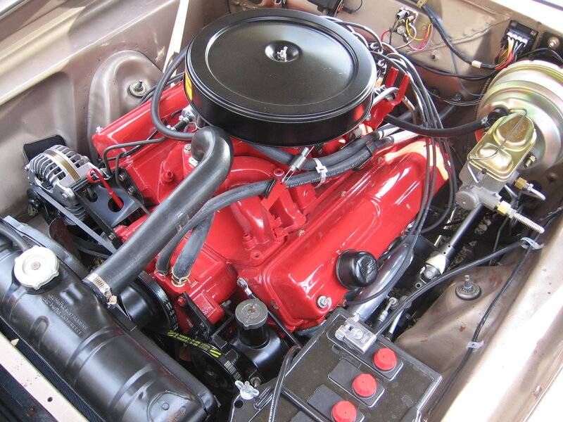

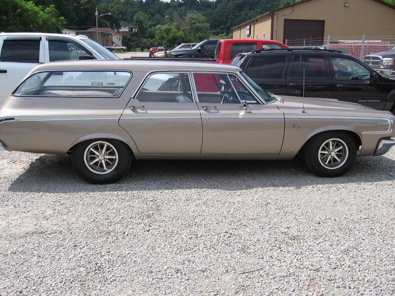

My buddy did his 64 wagon with tti's no problem. Loves it.
I got to drive it.Much better than O.E.
For the steering box the Borgeson is much smaller than the factory box.
His car is a poly 318 stroked to a 390 but that don't matter.
The wheels are Factory 15x7'' 80's Dodge Mirada/Chrysler Cordoba.
