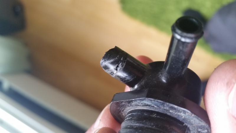

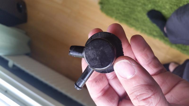

I guess your name is Frank, you almost tricked me into writing to you in swedish ;-) The brakebooster seems new, but the valve that sits on top has one connection broken, not the whole connection but maybe 1/2 - 2/3 of it, but the hose is on and the clamp clamps the hose but maybe when it gets hot it will swell and open a litle, small enough to make a hidious sound.
I think this could be it

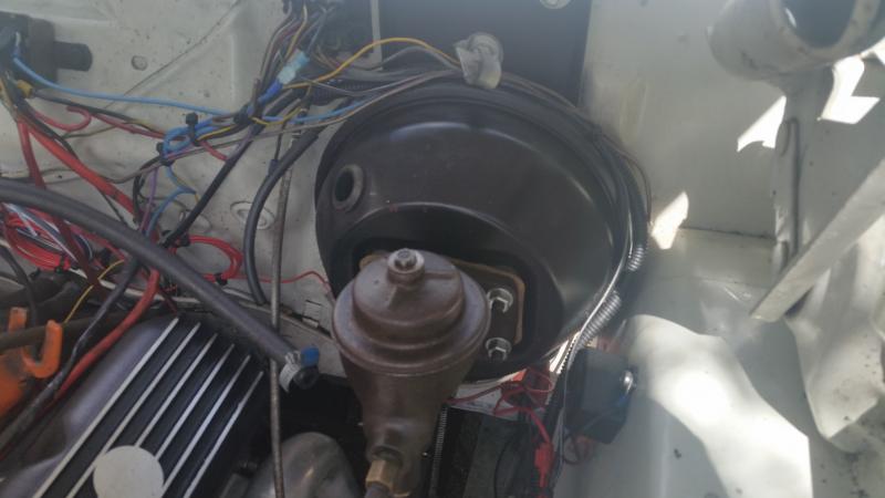

The booster with the large clamp contains a diaphragm and bellows inside, it should come apart without too much drama. Not sure about the crimped type. What does your booster look like?
Yes, that crack is bad! Hit it with some RTV.

It looks like this (the valve is removed by me)

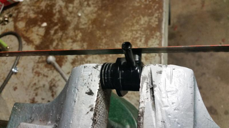

Cut connector just after the cracks

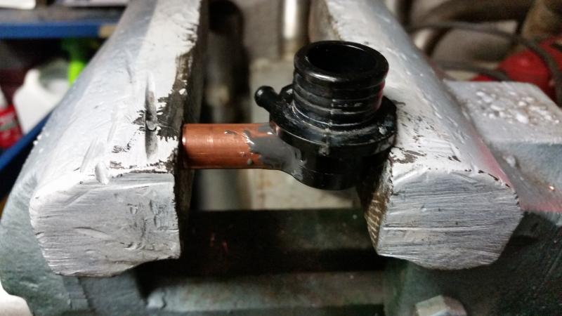

Cut 1" of 12mm cuppertube (10mm inside dia) and 2 comp high temp epoxi... just some finishing touch left..
