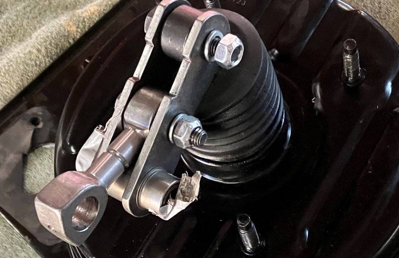

This isn't always true.
The multi piece linkage in the 1966-70 B body cars have bolts and nuts to retain the various parts.
If any of those three nut-bolt connections is too tight, the linkage will bind up and not allow the pedal to return to the top. This happened to me and before I figured it out, I changed to a different master cylinder.
Hmm, I have to check this. When I replaced the rod I remember making sure everything was tight. Thanks, I guess I have more stuff to check.

Ding Ding Ding, We have a winner! Thanks Kern Dog, you were correct, everything was too tight. I loosened everything and the brake pedal comes back up, I now have brakes! Its not the greatest feeling pedal but that's the way it was before I changed the rod. Its a little too easy going down but it stops. Thank God I don't have to remove the booster, that's a frustrating job.

I went back after I'd loosened up the linkage and made sure that the nuts were tight enough to stay in place but not too tight where they'd bind. To be sure, I put Locktite on the threads.
