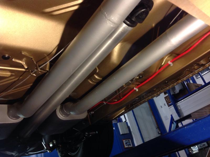

Here is a photo of my 64 Belvedere. The cables are under the TTI pipes
Interesting. On my 65, the cable fits best overtop of my 3" TTI x-pipe.
Have not started the car yet so not certain if it will rattle. Will likely wrap it like Eric suggested.
Those in the photo are 2 1/2''. It had the factory single exhaust and the cable was below.Put it back the same way.

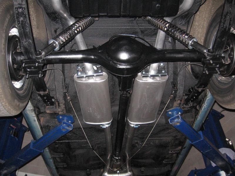

My exhaust manifolds are stock 68-69 HP 440. The pipe is 2 1/2" with X cross-over. The pipe bender did not get everything tucked up as close to the floor as I would have liked. My cable is above the pipe. Looks like TTI took this problem into account when they designed their system...............MO
On my 63 Dodge with headers and 2 1/2" exhaust (no X over) the cable is above the exhaust. The splitter is clear but one cable lays on the exhaust where it crosses going to the rear brake but no noticeable rattling.
My cables are over top as well. As far as rattling, I sure can't hear anything like rattling with all the commotion going on. Could yours maybe have some slack that you could adjust out?

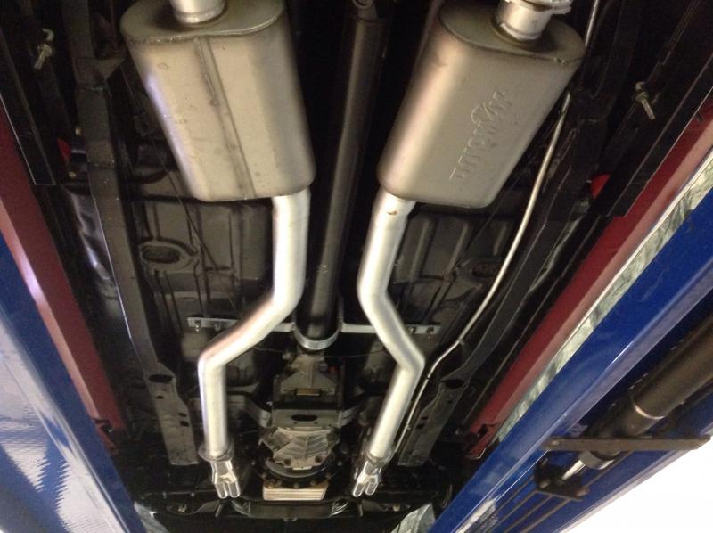

On my 67 Camaro I had this problem. With mine though, it would touch the driveshaft at the yoke. I solved it with a spring. But it was irritating for sure.
In the pic you can see it just to the right of the tail housing. 100% fix.
