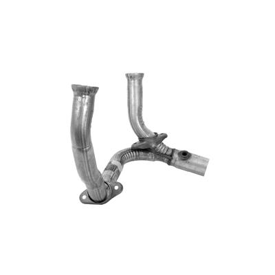

I doubt anything is plugged up. I think that Y pipe is so restrictive the exhaust blew the gasket from back pressure from the completely inadequate pipes. I found this on Summit, it is probably an OEM style pipe it looks similar:
Not exactly a performance part! Look at all the pinching!

Not kidding on the Y pipe, I think the 90 degree bend from the driver side pinches down to like maybe 1.5" OD. And it is full of those little creases. Wow.
1998 DODGE DAKOTA Walker Exhaust 40235 Walker Direct-Fit Y-Pipes | Summit Racing
