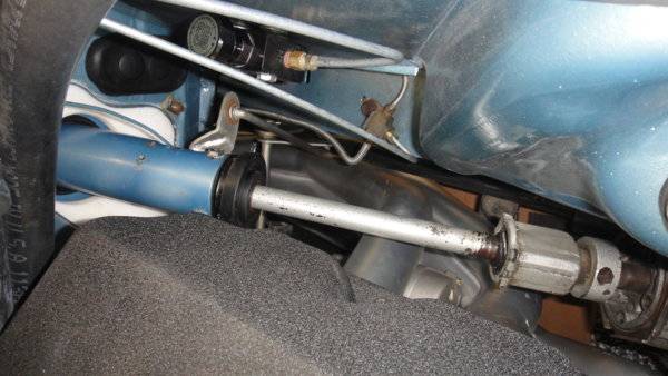

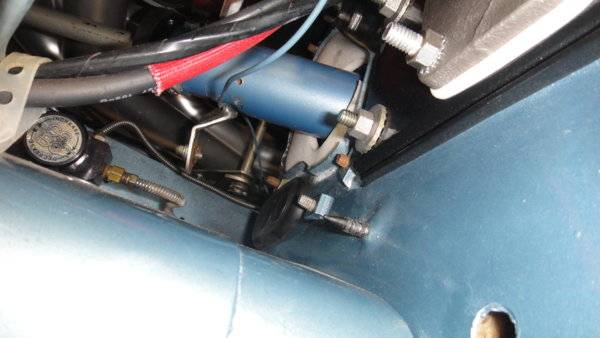

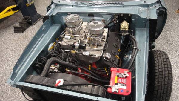

Adjustable Prop valves are about $35 at Jegs or Summit.Sorry,this is the best photo I have.You can see the knob of the adjustable valve on the inner fender below the master.
