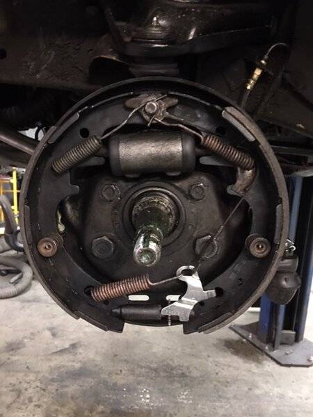

Need your expert help. I am having trouble adjusting my power drum brakes on my 66 Belvedere. I can see the front shoes moving roughly a 1/4 inch inside the drums when I have someone apply the brakes and someone rotate the tire. You can hear them clank around a little sometimes. I do have new shoes and wheel cylinders, re-used the hardware. If I adjust them up higher and take it for a drive, they are way too tight and hot as hell. In the records that came with the car someone wrote on a work order back in 2005:

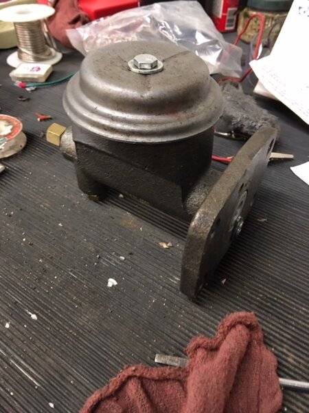

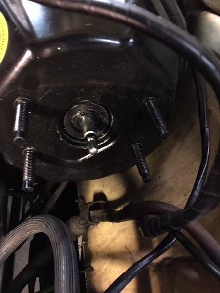

Checked and found valve stuck inside booster. Could not get new one. Removed and made rod for master cylinder . Bled system mounted master cylinder.

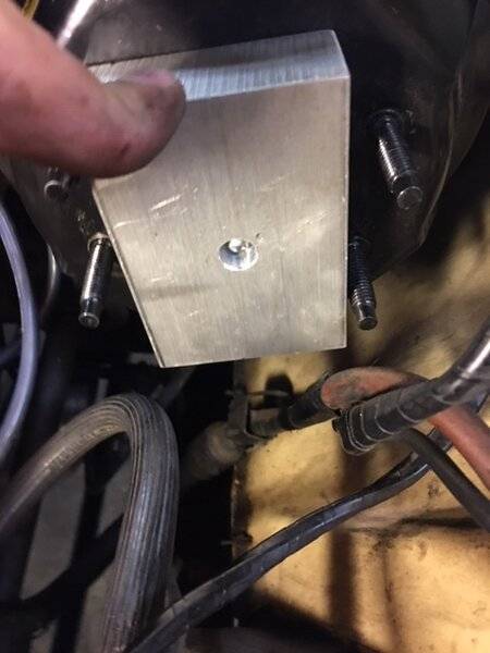

I thought maybe the rod was a little long going into the master, holding the wheel cylinders out and not letting me adjust them properly. What I measured was the hole in the master is roughly .915 deep. I took an aluminum block I had lying around that was 1.005 thick and dropped a hole in it so I could put it over the rod and measure the distance down to subtract the two numbers and find out how far out it protrudes, which is roughly .885. I say roughly because it is a rounded end and I did my best to be accurate. That leaves .030 clearance which I am assuming is ok? It has been a while since I have adjusted front drums and never on a mopar, but the slop just doesn't seem right. Stops great though. Any guidance would be greatly appreciated.

I think you are safe with the .030" clearance. Did you adjust the shoes out to the max and then back the adjuster of until the wheel rotated with a slight bit of drag? Every thing looks normal in your pictures. Were the drums machined?

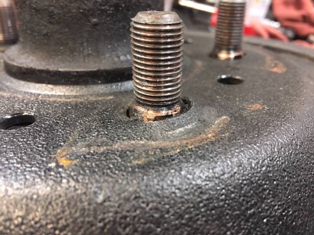

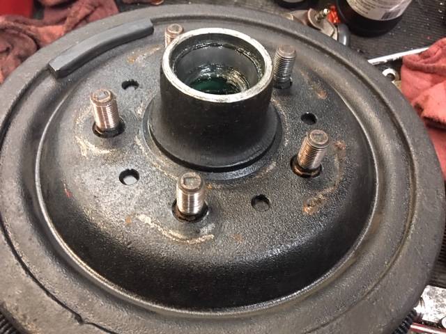

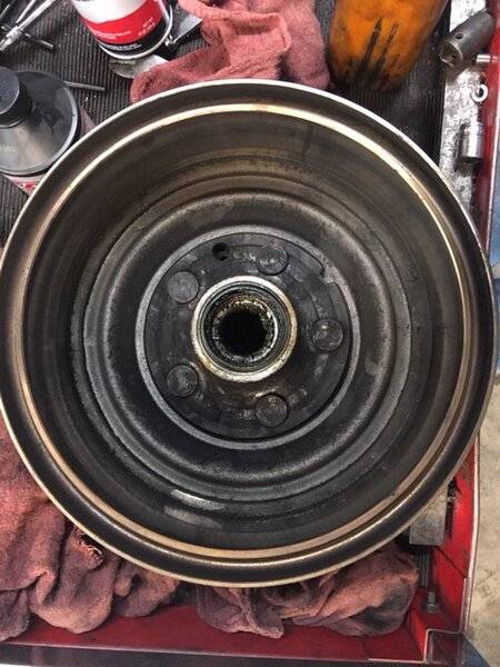

I did try adjusting them that way one time and when I came back from a test drive, I could hardly turn the wheel, it had really tightened up. I could just keep doing that ( drive, back down, drive, back down) and see where it ends up, but it seems like whenever I get them so they spin with a slight drag after a drive, they are moving that 1/4 inside the drum. The drums were new from summit last year, although they didn't seem to press on to the hub real great. The drum raised slightly around a couple studs (see pictures) when I pressed them on. Measurement wise, the ID of the drum measures pretty consistent at 10.005 wherever I measure.

Just a quick update, I found two things with the brakes on my car.
First, the springs on the top holding the shoes to the center pin where reversed. Shorter one goes on the front. I could not figure out why they kept adjusting up. Turns out the one spring was not holding the front shoe tight against the pin and the whole shoe assembly was moving, causing the adjusters to keep adjusting up. One of my coworkers noticed the spring coils were tight together after I was at my wits end. I was positive I put everything back the way I found it, and based on the other issues I have uncovered, there is some probability someone put them on wrong before me, but I can't verify it was wrong when I started so I am going to take the blame for that.
Second, I bought new Raybestos 2915R brake drums and pressed them on (see picture in #4). Turns out, they were not pressing on all the way flat against the hub, and I was getting a vibration when I braked at freeway speed. I mounted the drum on the hub and tightened it down, and put the assembly on an extra front spindle I had. I measured the run out with a dial indicator and it was way out of wack. The measurement at the bottom of the wheel studs where the drum would sit is .640 and the lug holes in the drum are .625. A .015 press over 5 holes, it will never sit flush. Be aware if you buy these front drums. I am drilling the lug holes out to 41/64 so they just slide over the bottom of the wheel studs.
