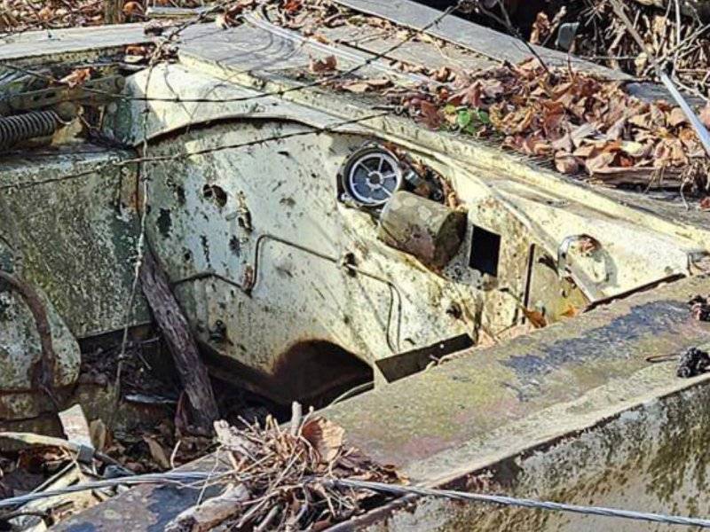

I thought it was the one following the seam in the firewall??
Here is the hump in the center of the firewall. The other style line goes straight across The firewall. It was made for Hemi with the heat tubes to the back of the intake. Then they put the hump lines on cars with other engines also.
They mention "right front" for the hump?
Difficult to tell from the photos. Thanks again for helping out.
