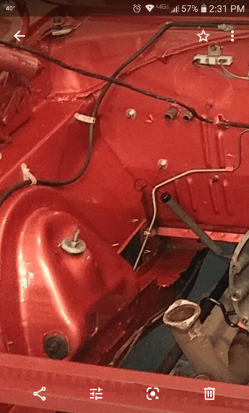

In the process of ordering the hard lines for my Charger. Car was equipped with power drums. My question is this, does the brake line along the fire wall route under or over the frame rail? Fine lines has a set that goes over and a set that goes under... since I didn't blow the car a part I'm not sure which ones to order. Off the cuff what's the difference? Possibly one for drum one for disk?

Mine has power drums and goes over the frame
We had that discussion before and at least in my case 69 the lines could be either way. Do a search and maybe you can get a better idea.
If you still have the inner fender splash shield for the right side, that will show if it went over or under the frame originally.
