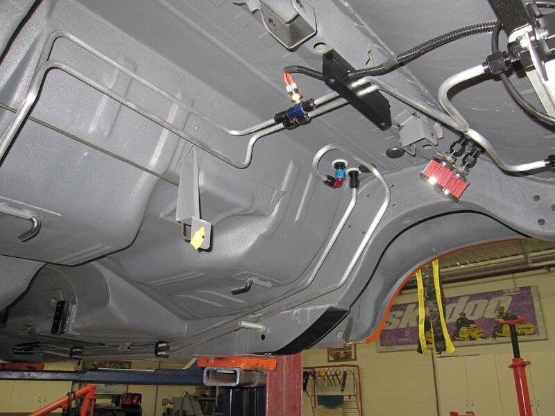

I prefer to build my own plumbing (I was a state licensed plumber for 25 years) and enjoy creating/fabricating.

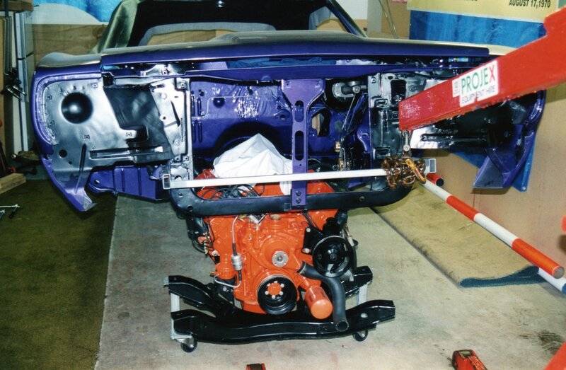

For reasons of damage while being shipped 10,000 miles, I opted to make my own for the GTX. I used the originals as a pattern, and also had new protection springs made locally. Lost a bit of skin putting it all together, but you couldn't tell it was hand made when the car was finished. I used a local Brake Shop to flare the ends for me. :)
