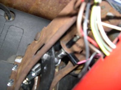

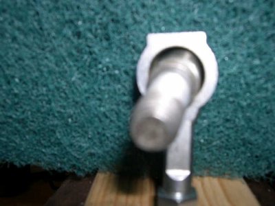

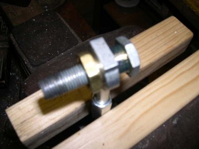

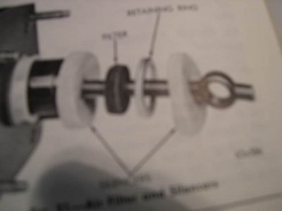

mrploww: The 1st bracket didn't pan out. This was a piece of angle steel drilled to attach to the brake pedal contacting the switch. We went back to more of the original rod looking in the factory manual and this seems to be working fine (a buddy who works at a machine shop made it up for me). The shop that did the install used an absolute pos rod that we couldn't adjust enough to have it return far enough to fully depress the switch. I've posted some pic's of the after and before that might offer you a description. I don't have my notes but we made the part of the rod that contacts the switch a bit longer (I want to recall around 1/4"). The other pic's posted here show the BS rod that westech automotive used; it had around 1/16" slop in it and put in an oil lite bushing to cure that. As it was I dumped that rod for the one we made up. I hope showing you the after/before pic's gives you an idea of what was done. PM if you'd like to chat more.
now that I see how the pic's are arranged in my post reply, the top left you see the new rod installed, top right is the page from the factory manual we reviewed to design the new rod (the shop never gave me back the original parts). The lower left is the rod the shop put in. Note the top is the part that was "supposed" to meet the brake switch and you can see it has little button end to do that (plus being too narrow for alignment to the switch) and also note the slop around the pedal bolt. The LR pic shows the bushing and we kept that for the new rod. In addition to this modification I had to put in a longer threaded rod. Took some playing around to get the adjustments right to have the lower and pedal travel reduced for braking action.
