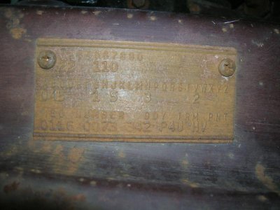

does it have a fender tag? all 426 street wedge cars came with the large brakes and sway bar on front. tag would show motor size.

Im learning all kinds of things about these car here on this site with all the knowledgeable people on here willing to share their knowledge. I posted a pic of the fender tag but I don't think it was a police car now or had the 426w motor. Even though it has the big brakes there are no sway bars on it. Thanks everyone, Bill
