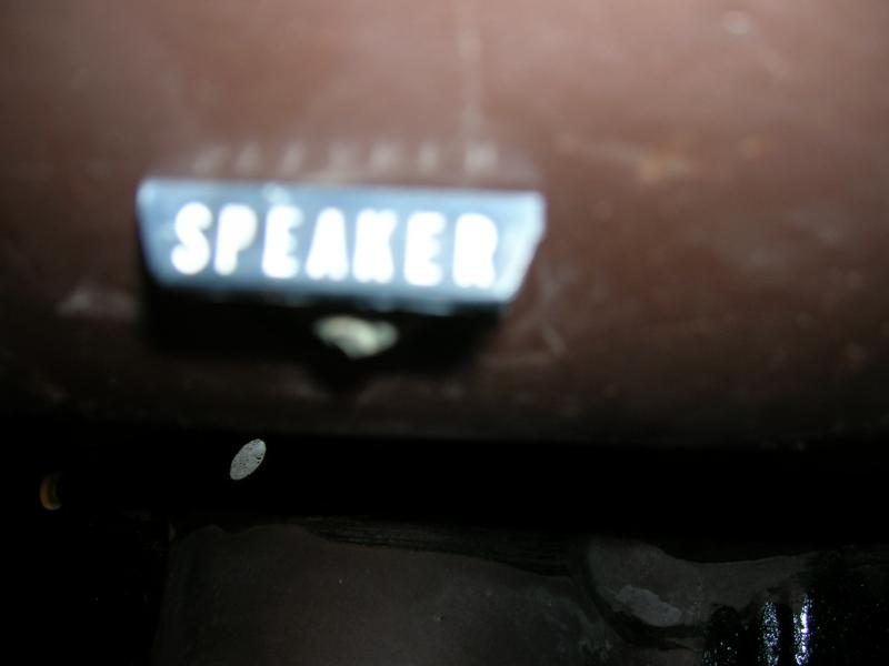

I recently bought a 1964 Sport Fury through this site. Car is solid as a rock. Has 3 or 4 different colors of faded paint on it but the main thing it is very solid. The first thing I usually do on a car that has been sitting is completely rebuild the brake system. I thought someone had just slapped a set of drums on the front just to be able to roll it around. The brakes are 2 1/2 x 11. That's the first 64 b body I've ever worked on with that size brakes. So I pulled the rears off (man, I hate tapered axles!). They are the same size! Went to the NAPA store and they looked it up in their book and said that was the biggest brakes available for a 64 b body. So now Im curious....Could the 64 be a Chief of police car possibly? I wouldn't think its was a regular police squad car because its a Sport Fury, a top of the line car. I got to looking a little more and found this little triangular shaped piece of plastic screwed to the dash (About 1 1/2x 1 1/2). I flipped it over and it said 'speaker' on the piece of plastic. So, Could this be a police car or maybe special ordered this way. But if it was special ordered that doesn't explain the 'speaker' tag. Anyone know for sure? Im really curious now. Don't know that this makes any difference but it came from California. Thanks, Bill

I uploaded a couple pics of the 64. It is a sport fury which only came in 2dr. Console shift. Suppossedly an original 361 car. Also note the 'speaker' tag.

Is the speaker tab for a reverb switch? I'm trying to remember if that was an option in '64. Seems to me I just read a post on here stating their '64 had a reverb unit. I'll have to check that out...
Thanks Goldencommando, just found the same info.
The switch for the reverb might have looked like this one? Just a "Speaker" tab would have been a switch to disconnect the rear speakers. You never get tired of learning about these cars.

Thanks guys, yeah, I hope the drums are in good shape too! I think the front ones are good at least. They are shiny black with no grease or grime so Im thinking someone put them on and drove the car very little. Don't know about the rears. Keep your fingers crossed. Never thought about a reverb switch. I bet that is what it is. Learned something. I do remember having a 66 satellite with reverb but this is the first 64. I think you guys solved the mystery. Thanks!! Bill

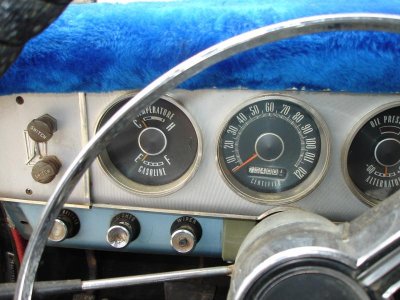

The VIN will tell you if it is a Police car. Here is a pic of a police dash in a 64 Plymouth alsoDSC02732.jpg
Notice under the odometer (certified), and the amp gauge shows +60 -60, the HD alt. This car had 11x2.5" brakes all around with sway bars.
