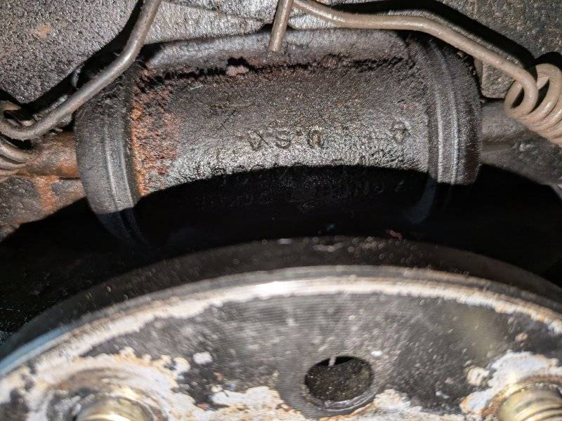

My '64 Nova (see my avatar) has an 8 3/4" Mopar rear end. I think it's a 489 case. It's time for brakes (drum) and I have no idea what vehicle the rear end came from. Are all 489 case brake components the same?
No. There are 2 different drum sizes (2-1/2” wide or 3” wide) and the parts are mostly different. The xxxx489 on the center section of the rear end wont tell you about the brakes. I’d suggest pull a drum and measure ID and width, then take some educated guesses at the auto parts store and match the parts up. Others will chime in. I’m no brake expert
Best to measure what you have. As said above there are different widths along with different diameters. so there are at least 4 size options.
Measure and a photo for us. All the hardware changed between 69 and 70.
As others have pointed out , Brake Drum diameter ( likely
10 “ vs 11 “ ) and Brake Shoe Width ( likely 2 1/2 “ ) are the critical measurements…
A picture of the wheel ( all as is — mounted ) will tell me instantly what you have……

Looks like 11x2.5's. Many of the mid and full sized cars use those. I'm putting that stuff on my 67 Coronet wagon. I ordered up drums, shoes, cylinders, hardware for a 70 Coronet rear. Just so you have a starting point. I'm curious to see what axle bearing setup you have. Tapered Timken rollers, the best, or aftermarket Green units which are ball bearing and suck.
