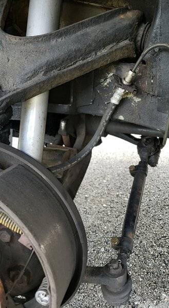

I'm going with a collapsed hose on the right side. As stated the self adjusters are side specific. Also hard stops in reverse get the most action from the adjusters.

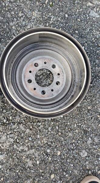

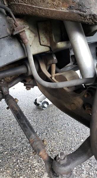

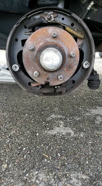

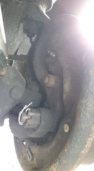

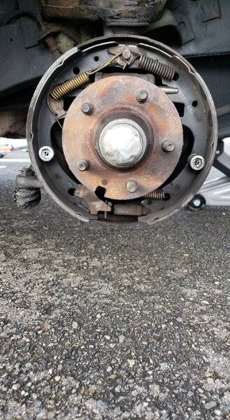

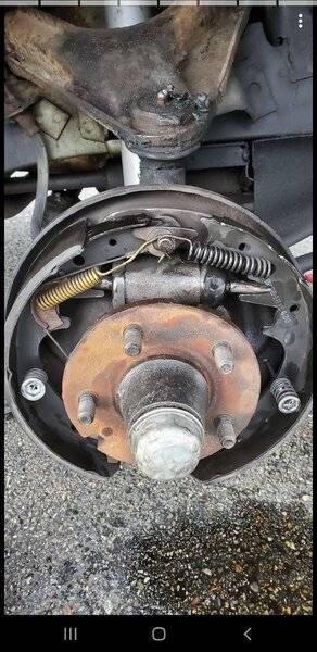

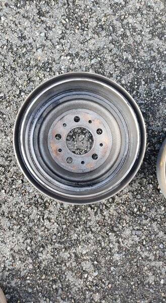

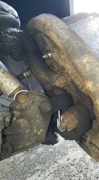

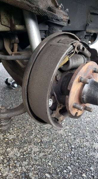

Here are pictures... about to attempt swapping assemblies...
Snapchat-1641789643.jpg Snapchat-1254861248.jpg Snapchat-431828387.jpg Snapchat-1717663436.jpg Snapchat-1186375138.jpg Snapchat-1726378452.jpg Snapchat-995897989.jpg Snapchat-1348858703.jpg Snapchat-906965808.jpg
STOPPPPPPPPPP !!!! Generally drums are swagged in place on front hub assemblies. All you need to do is try swapping the drums, reset the brake shoes and try again!
Drum and hub are usually swagged together, why we had you swapping complete assemblies. In your case all you need to do is swap the drums side to side and see if your issue goes away. Shoes need to be readjusted both sides to a slight drag before test drive to see if your pulling issue goes away.
Must have popped the seal off... best way to reseat it? Do I have to remove everything? How bad did I **** up?
Good reason to have someone with some experience to help you. Just an aside, I hope you have a jackstand under there somewhere. If the swage on the studs is not removed and/or the lug holes in the drums are not large enough to fit over the studs protrusion the drum will not seat flat against the hub. Get yourself a quality torque wrench and a service manual. "Calibrated wrists" come with experience...Wheel lugs should be torqued to fsm specs. Do you still have the original drums ? If so compare the other side.
So who pushed the brake pedal with the drums off??? At least you know there's no fluid flow issue to the right side.

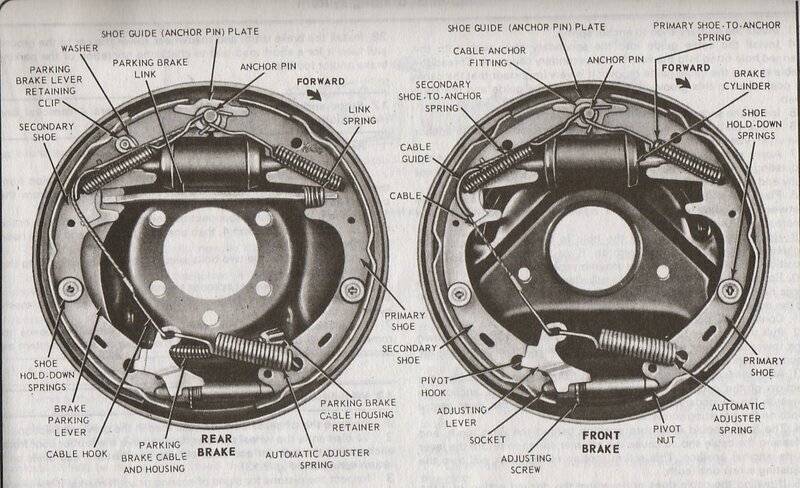

ALSO, now that Leo posted that FSM illustration... your "brake" shop swapped the forward upper spring for the adjuster lever spring on both sides! Large diameter spring belongs on the auto adjuster lever, small diameter/longer spring belongs on the top of the forward shoe! Could very well be the entire problem. Two different spring pressures, so your front shoe wasn't being forced out and only the rear shoe was due to the lighter spring..
