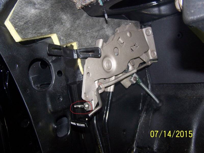

With an Ohm meter. If it reads open (zero ohms) between the stud and ground, it is ok. I doubt there is a problem with it since you lifted the wire off and still have the light on. I bet your emergency brake is not releasing all the way causing the problem. You should be able to tell right away if it is not pushing the switch in when released. Here is a pic of the switch on my car. You can see it is pushed in breaking the ground contact. Yours will have a wire plugged into that switch going to the light.
