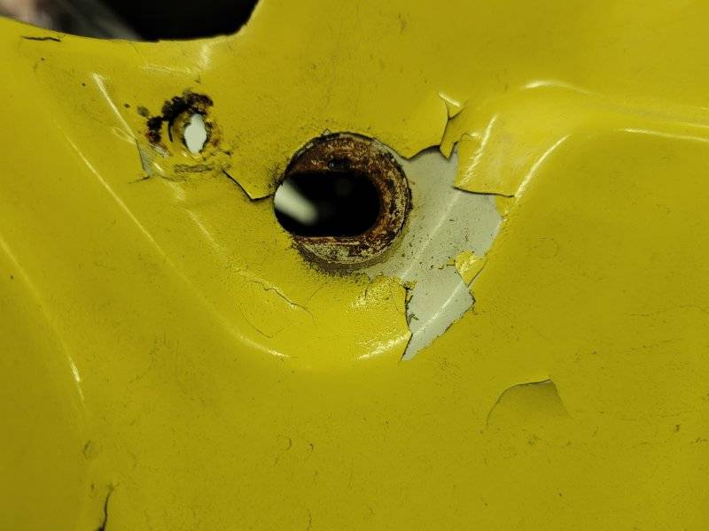

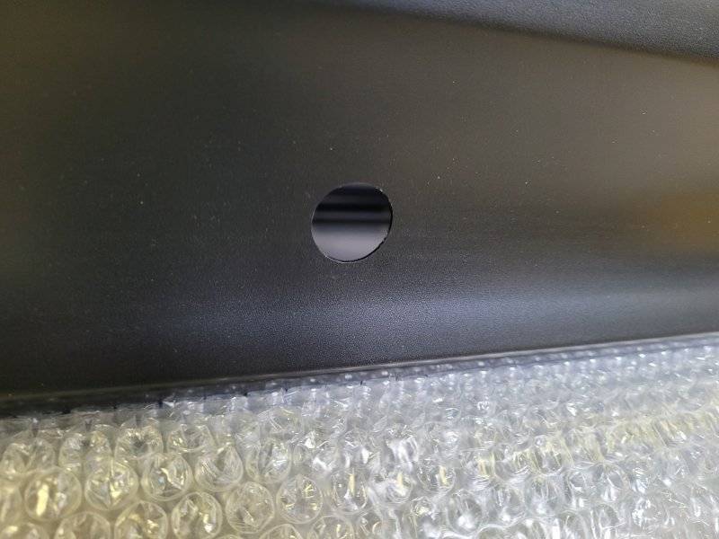

Lock pull hole on original door.
Lock pull hole on reproduction hole. Will have to see how the chrome bezel and window sweeps sit to determine if it needs to be moved inboard and then welded up a tad.

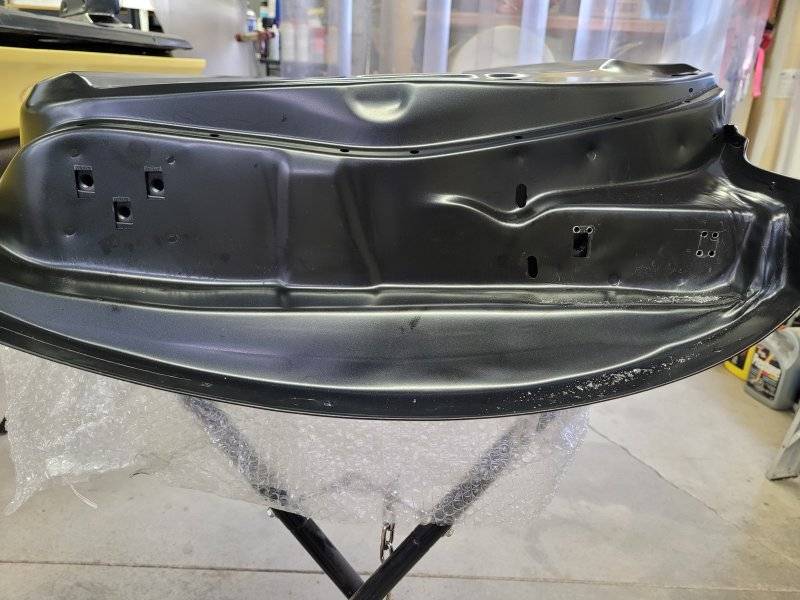

Original door skins of course spot welded to the interior shell. Nice wide overlap flange.

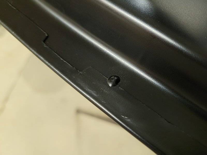

Reproduction door skins MIG'd in place. Will need to be dressed/cleaned up before paint.

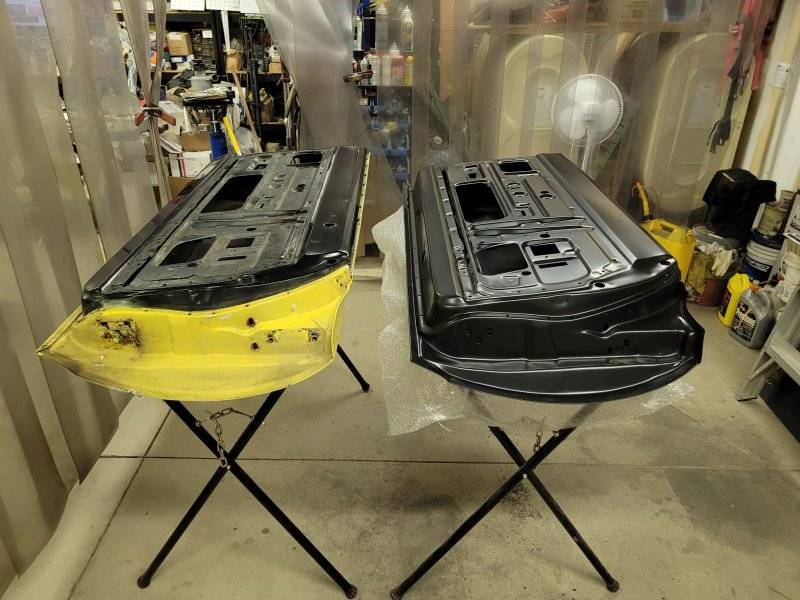

Side by each for a full comparison. Then I have to test fit every original door piece before I deliver the car and door to Body by Biggs.

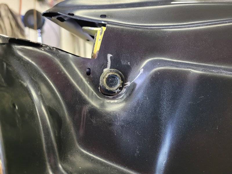

Upper hinge bolt hole is missing on the new door shell and it appears the one that they did punch is too close to the outside of the door. Threaded "bolt" plate that is behind said holes seems to be in the correct place... so it should all work out.

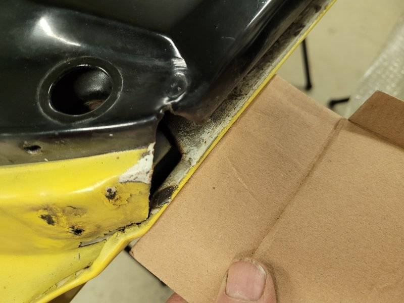

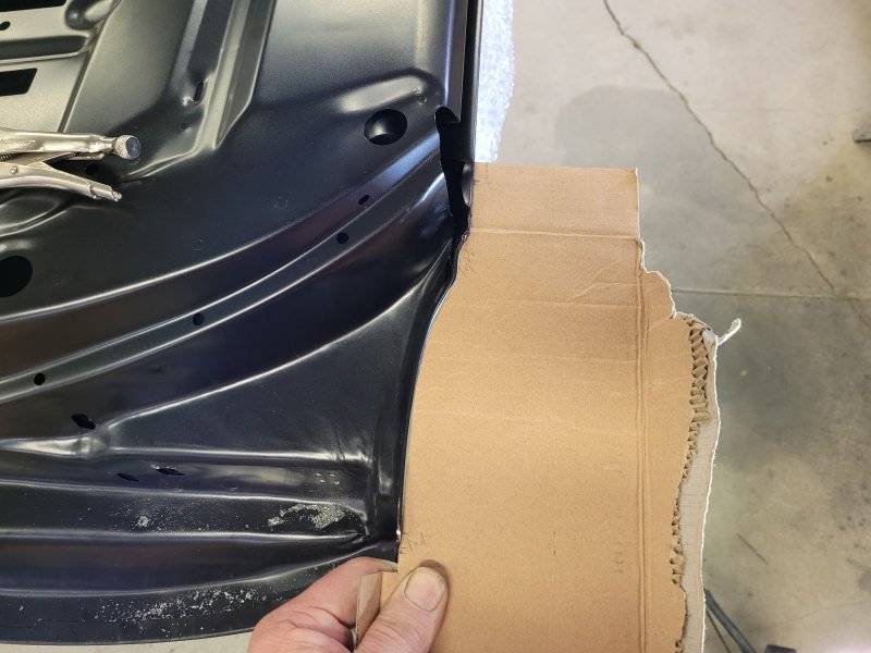

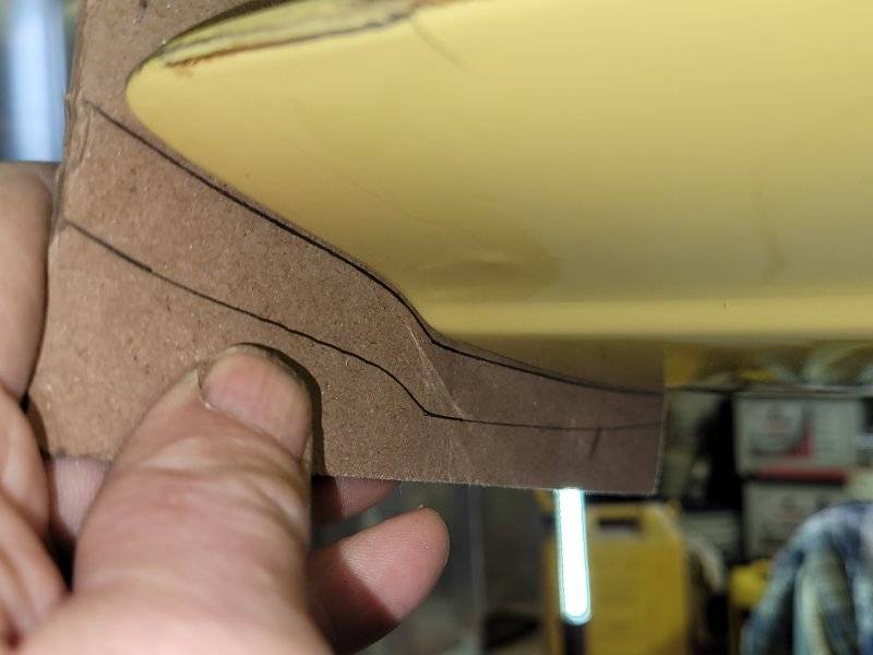

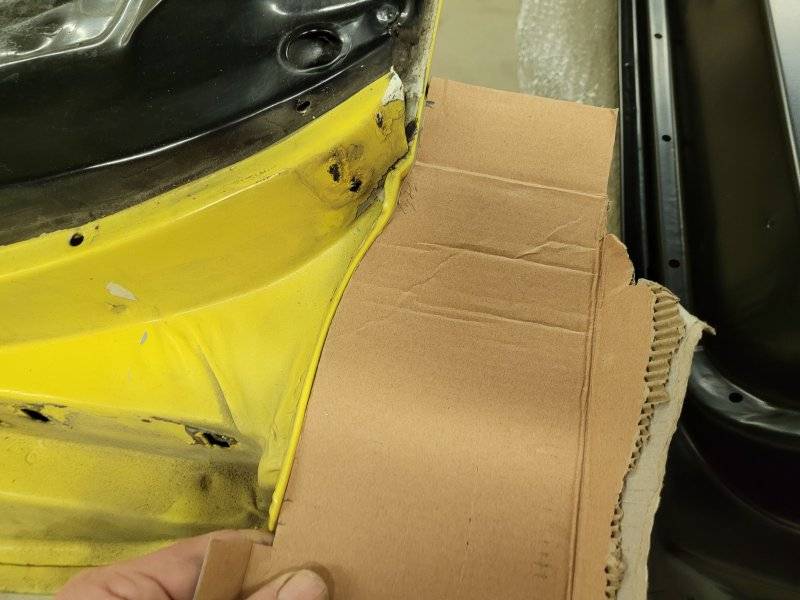

Pattern off the door at the A pillar and windshield cowling area.
Damn close on the reproduction.

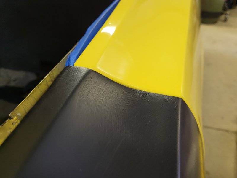

Need to dolly the area up a bit where the window frame slides in, as it needs to be straight and that'll bring the "detent" up into place.
Original is nice and straight.
Reproduction dips down... SHOULD be an easy adjustment.

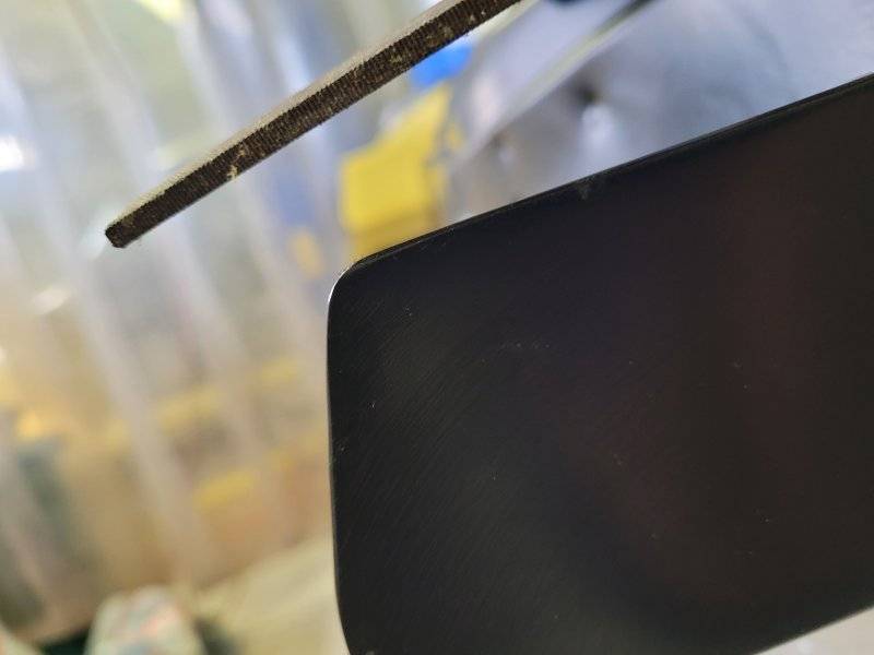

Cleaning up and radius'ng corners.
A tad closer to factory shape.

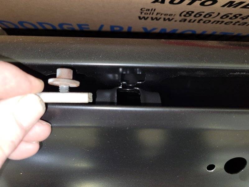

Test fit of the vent window A pillar attach bracket.

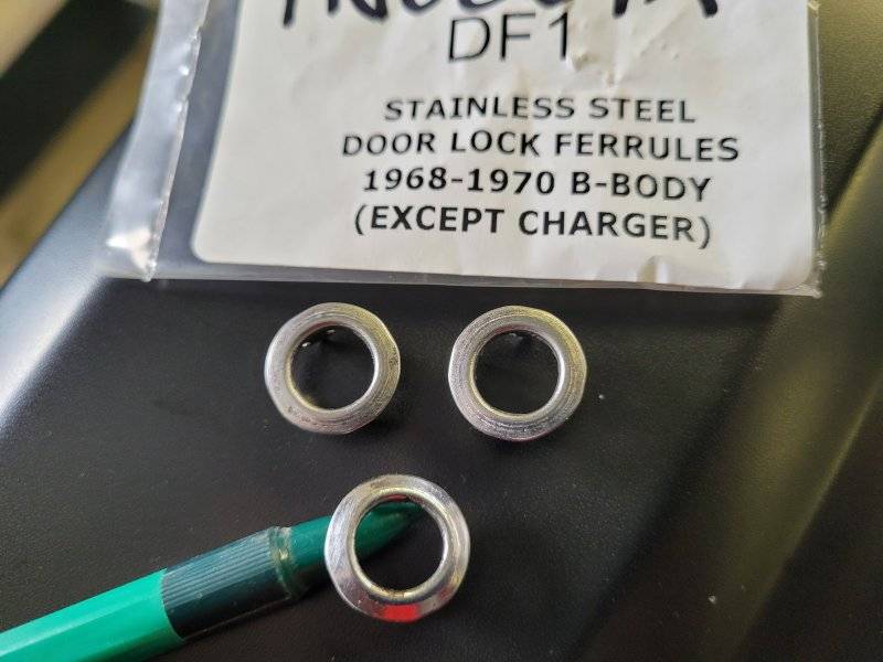

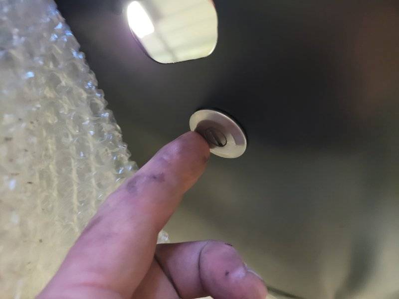

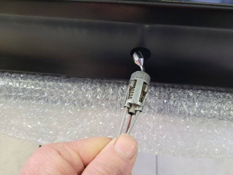

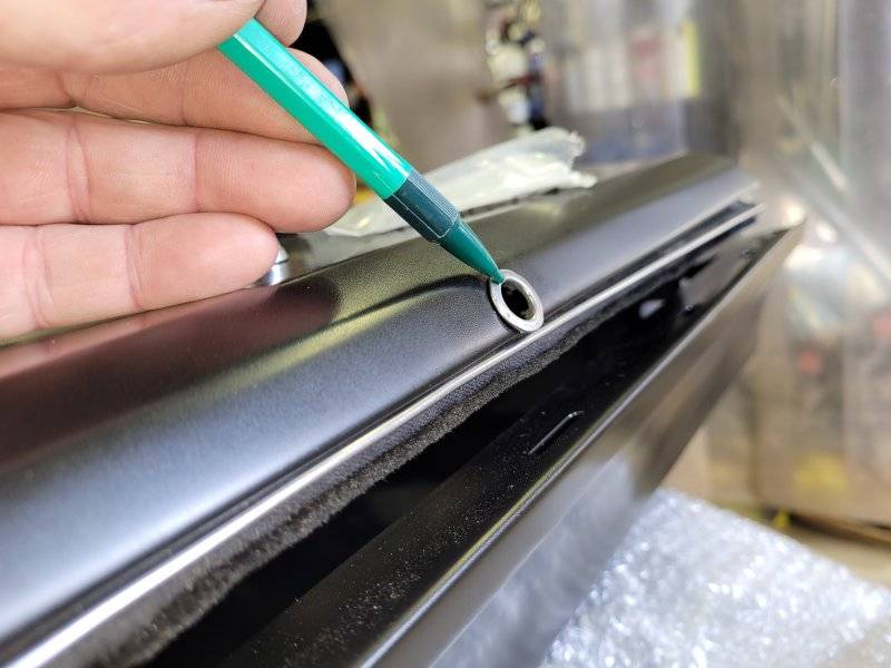

$32 for these POS reproduction ferrules. Pressed flat, not domed like the original on the pencil.

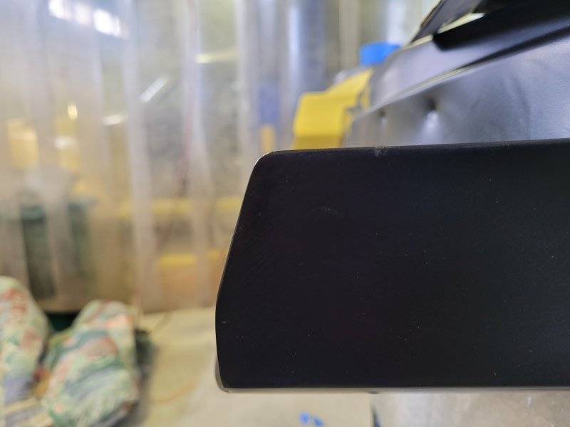

Making sure all the notches are in the correct place for the window sweeps.

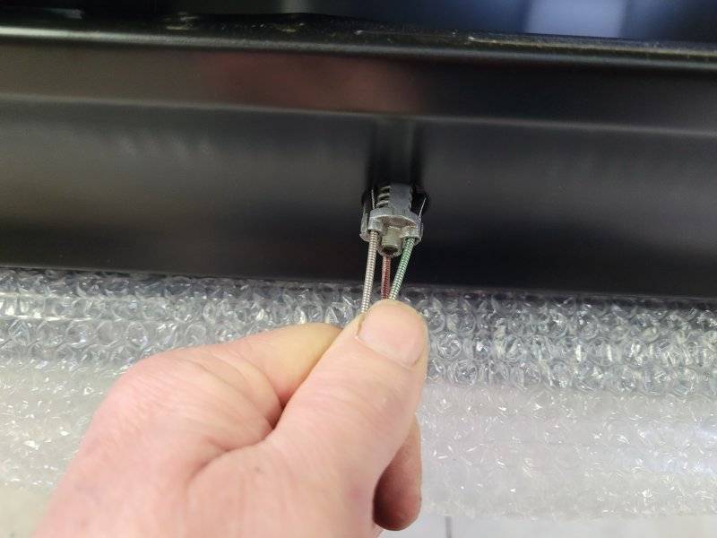

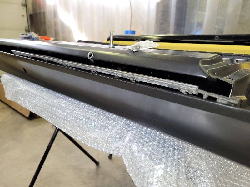

Window sweep in place and ferrule loosely in the lock pull hole. It'd work, but I can make it a tad better I think.

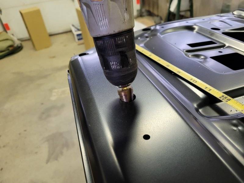

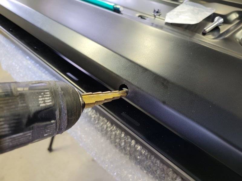

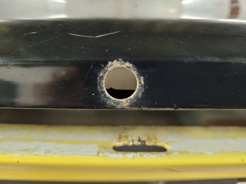

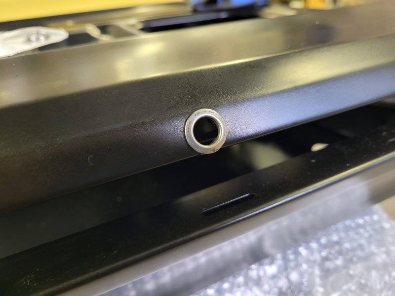

Unibit to hog the lock pull hole a tad inward on the door panel.
Now I can get the ferrule centered. That'll look fine once it all goes together and no need for any welding. Need to find an OE ferrule though, as these repros are junk.

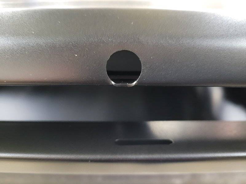

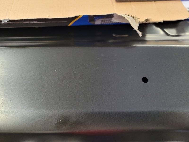

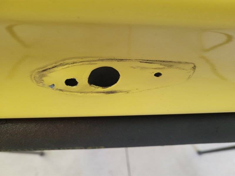

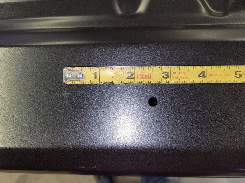

Weird but the only mirror hole they put in the door exterior skin was for the remote control. I have to drill for the mirror mounting stud and screw
Control head actually fits through.

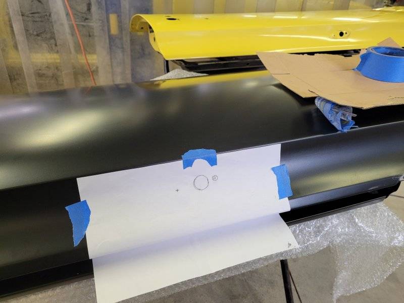

Need to take a pattern off this for the mirror mount and transfer it to the new door.
New door with hole for mirror remote only

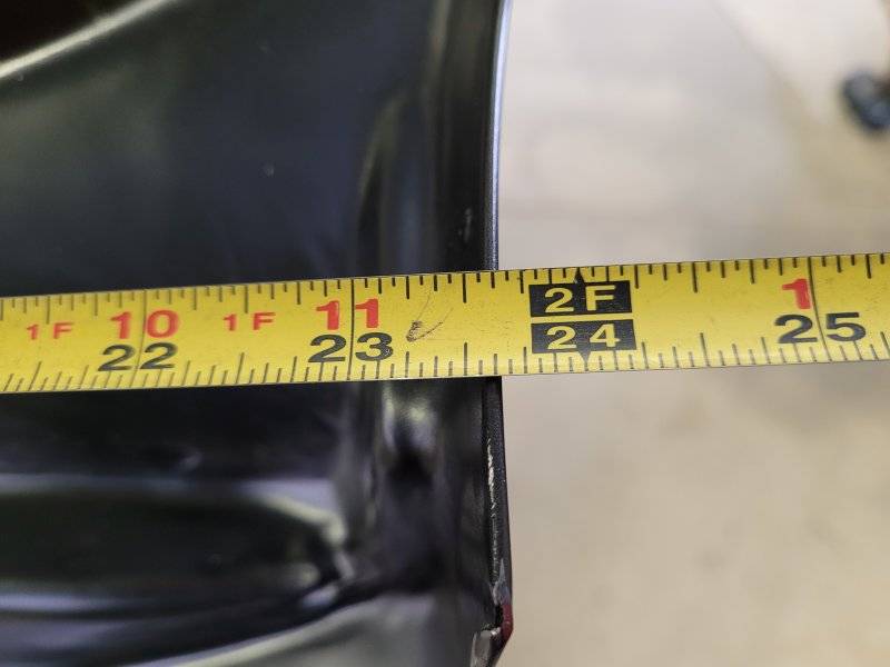

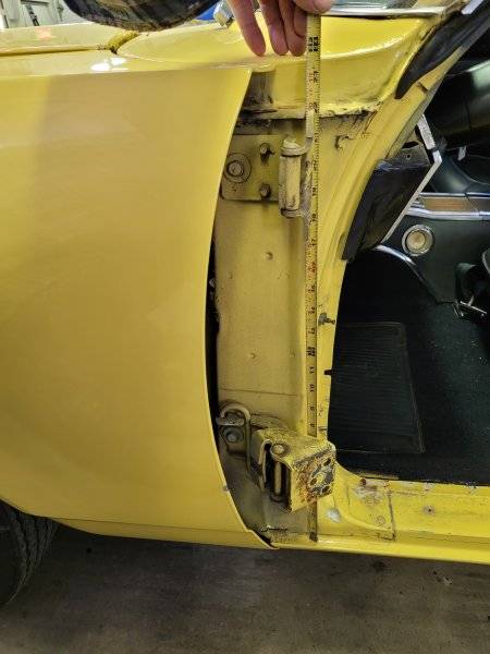

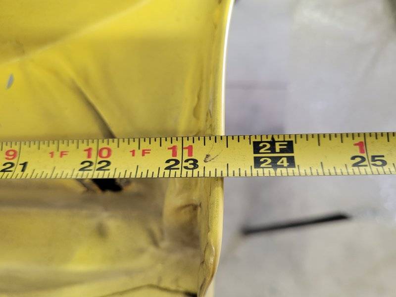

Hours of measuring, and comparing. No wonder it says "test fit everything before paint, painted items cannot be returned" on the box!
OE door height 23&15/32nds
Reproduction door 23&21/32nds. 3/16 taller than the OE. Probably meets original factory tolerances!
It'll fit, now I have to figure out hinge placement to make that a 100% true statement.

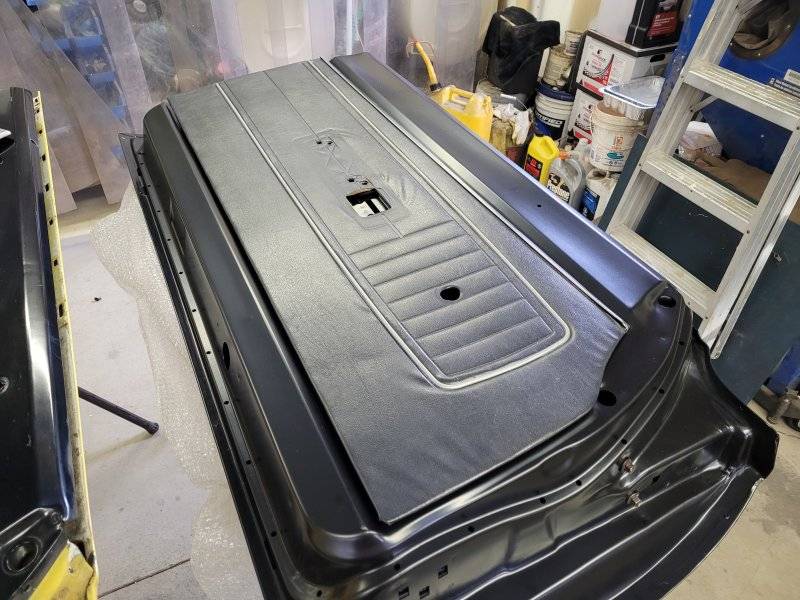

Door card and stainless trim test fit.

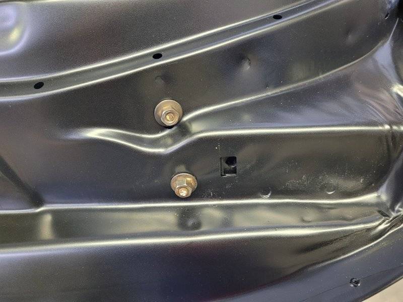

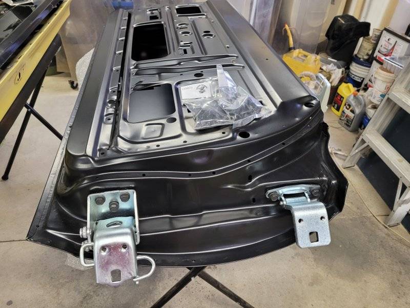

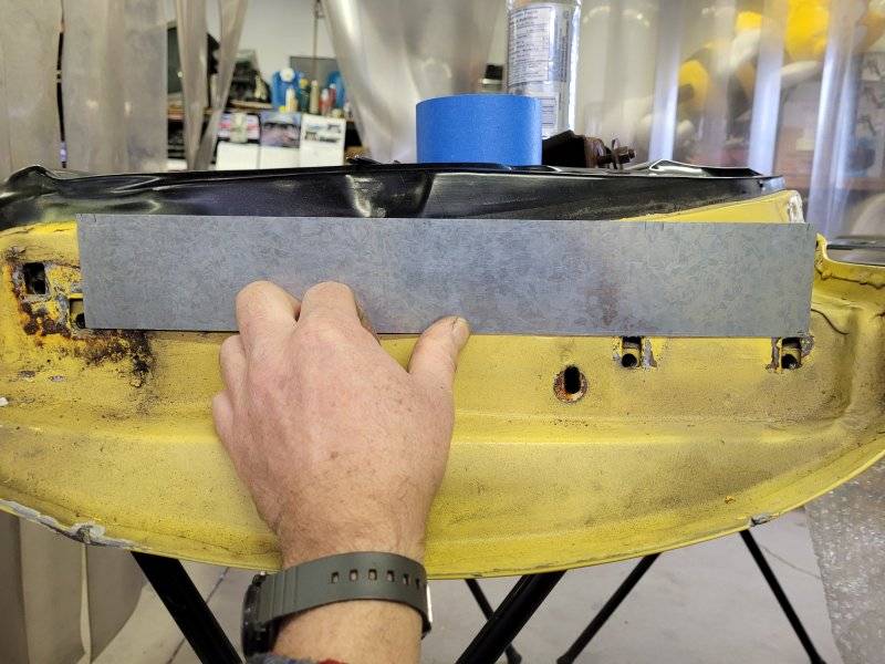

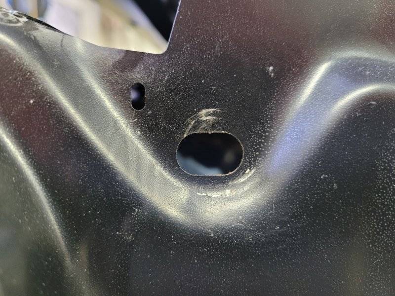

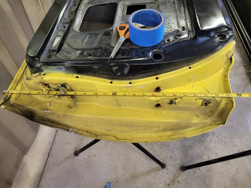

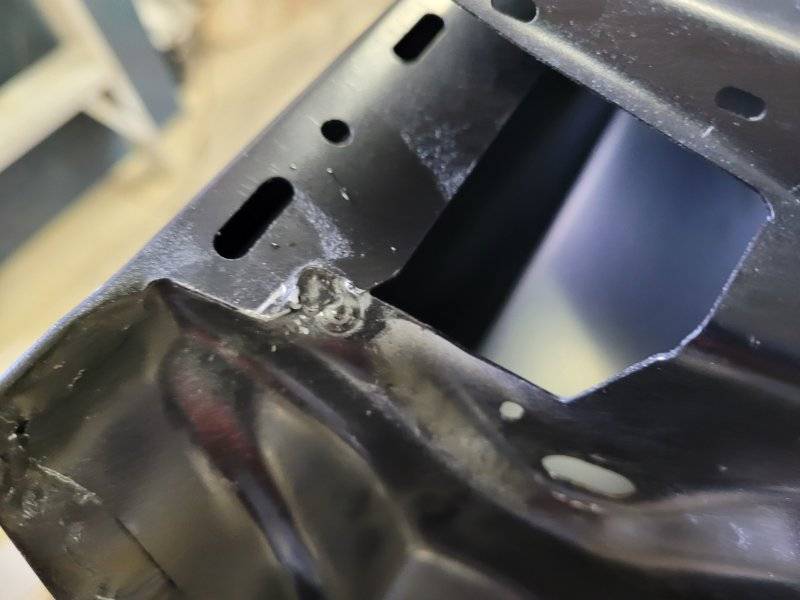

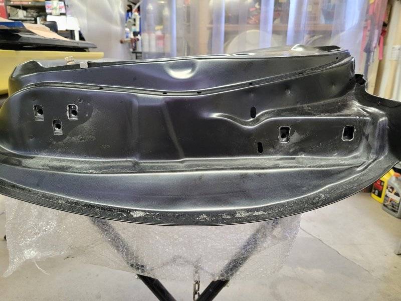

On the OE door the top hinge slots inner ends line up perfectly with the lower hinges outer edge of the slot.
You can see the misalignment of inner parts and punched holes, and the missing upper hinge slot all together.
Hinge hole slots marked for correction and existence!
Hopefully I've got adjustment needs covered.

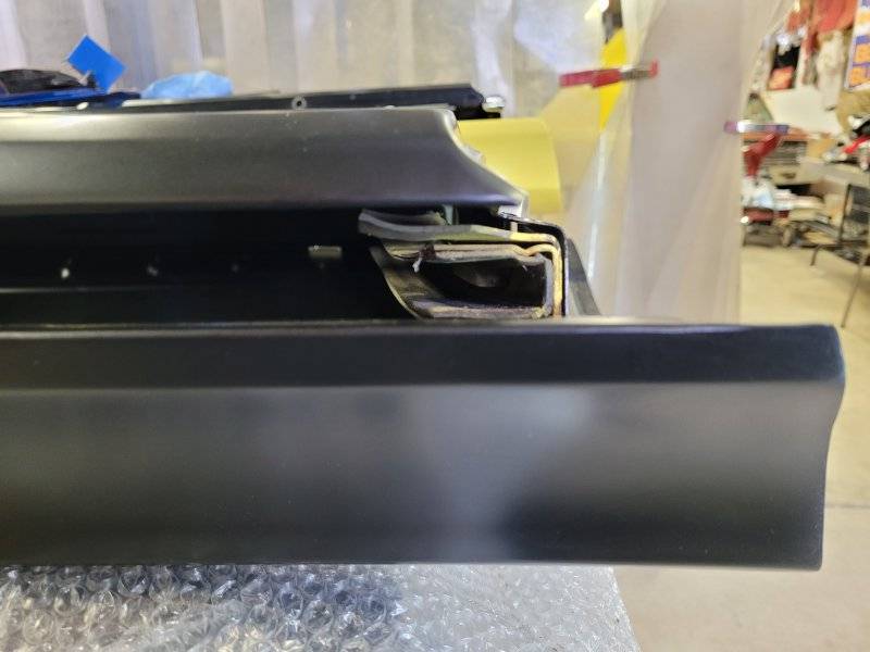

Doors top edge to windshield cowl profile tweaked to the pattern I made yesterday.
New hinges test fit.

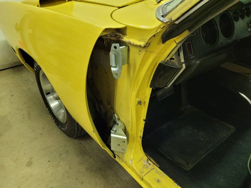

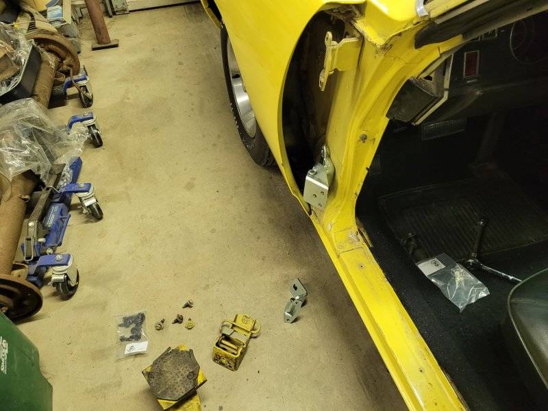

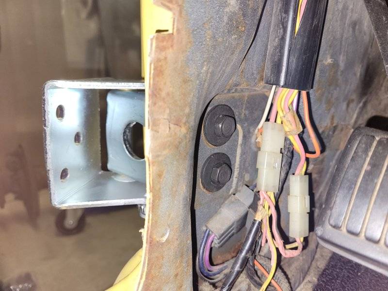

OE hinges coming off and new ones going onto the A pillar so they're ready for George to test fit the door for body and paint.

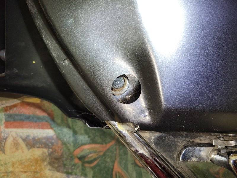

2 bolts inside and one outside on top and bottom hinges. Kick panel removed previously to access.
Both new hinges in place and lightly snugged.

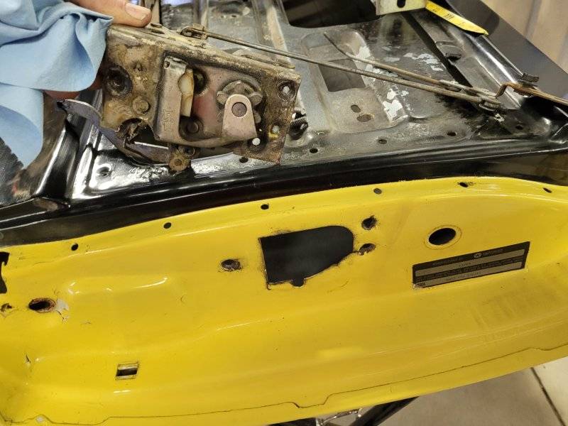

Next up, test fitting the door latch.

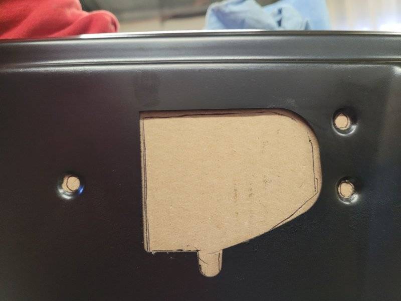

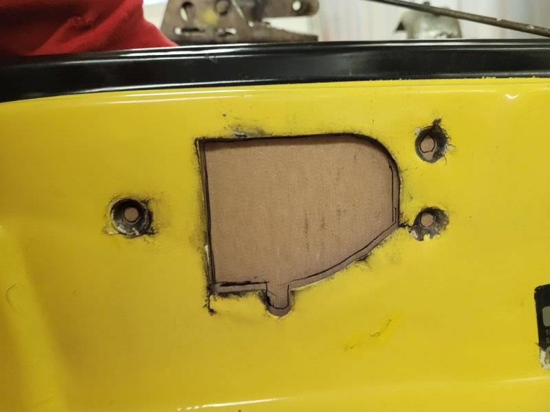

Screws didn't line up on the new door, so it's pattern time again.
New door is close, just needs a lick off the opening beside the 1/2 circle/slot.

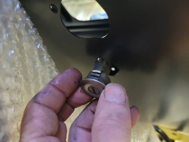

Fit check on the door key lock tumbler.
Amazing... something else fits! LOL

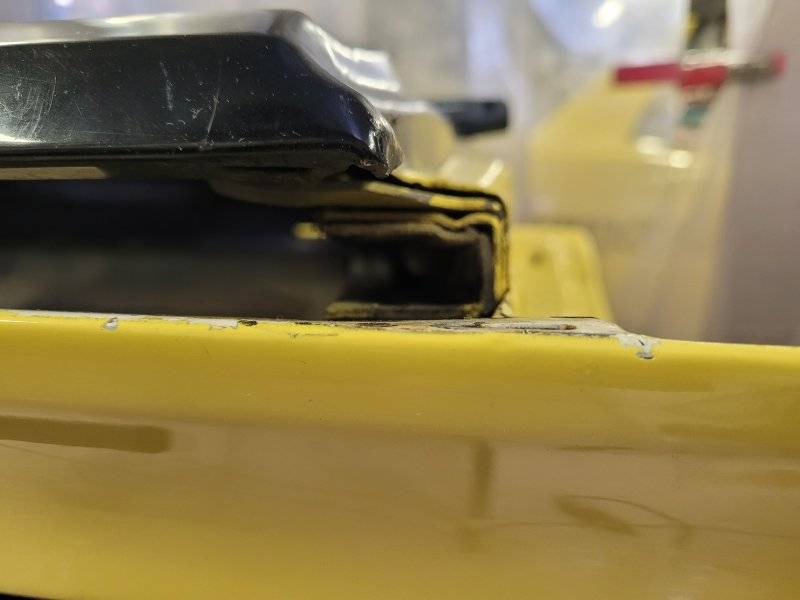

Check the position of the lower body line from the fender to the door & the door to the quarter...
Inner shell was obviously spot welded together, I wonder why they chose to mig weld the outer skin on?

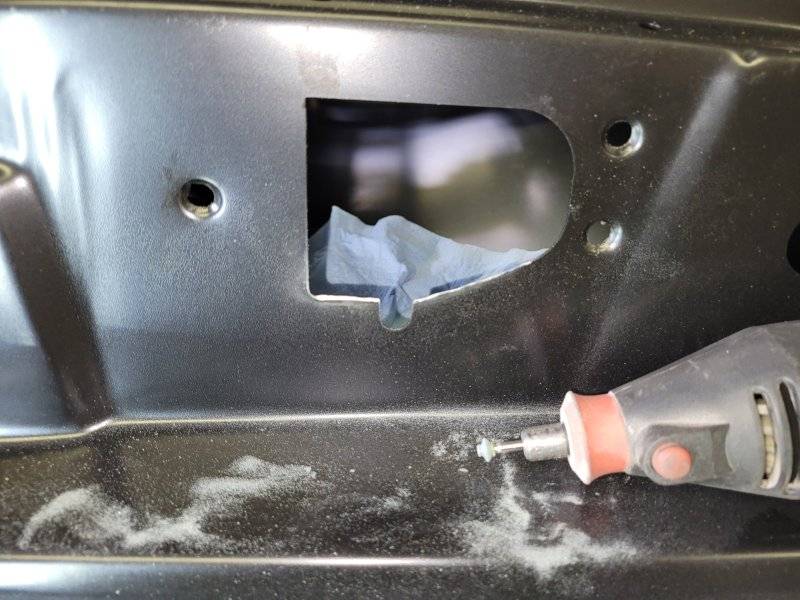

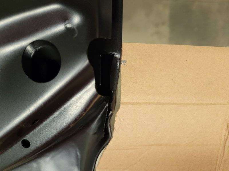

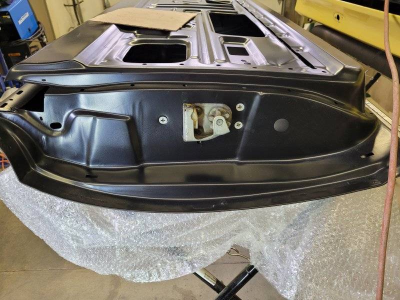

Ground out the latch pocket a tad.
Fits perfect now. I just hope it's in the right location in general.

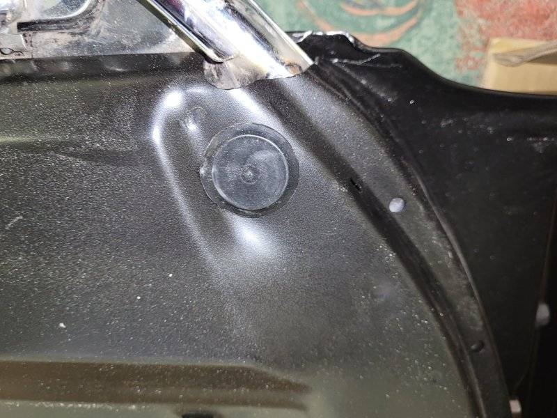

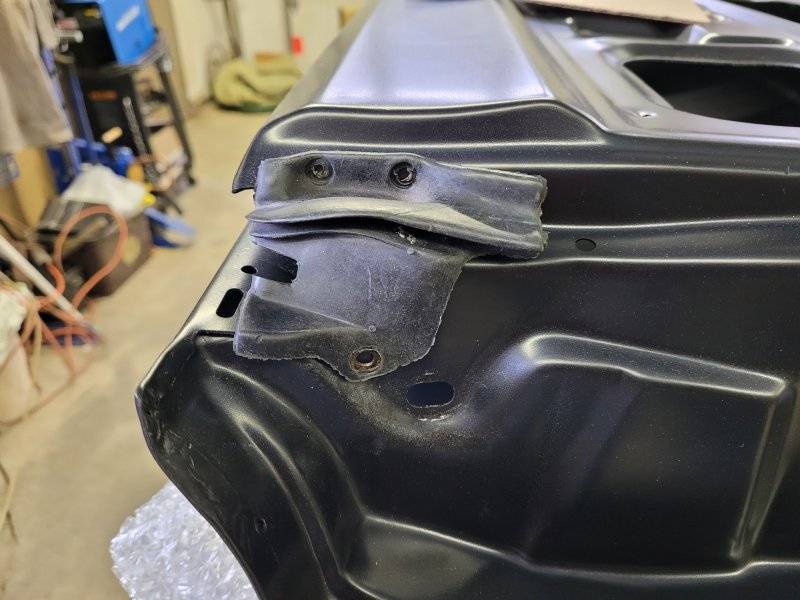

Cleaned this ugly up a bit and then remembered that area has a seal.
Seal covers it nicely.

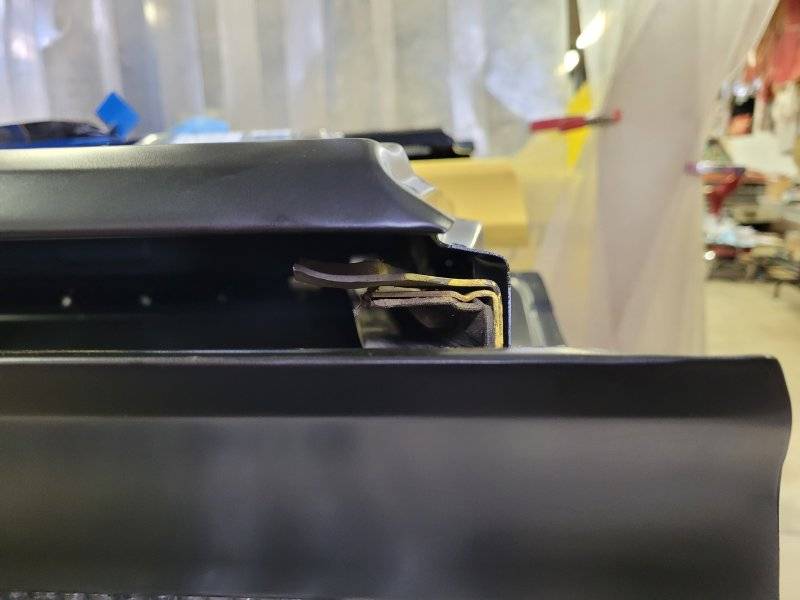

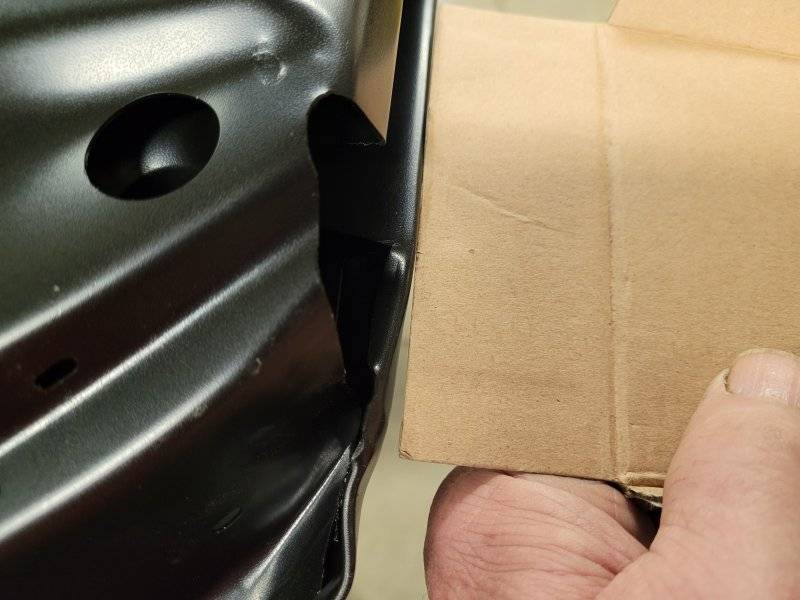

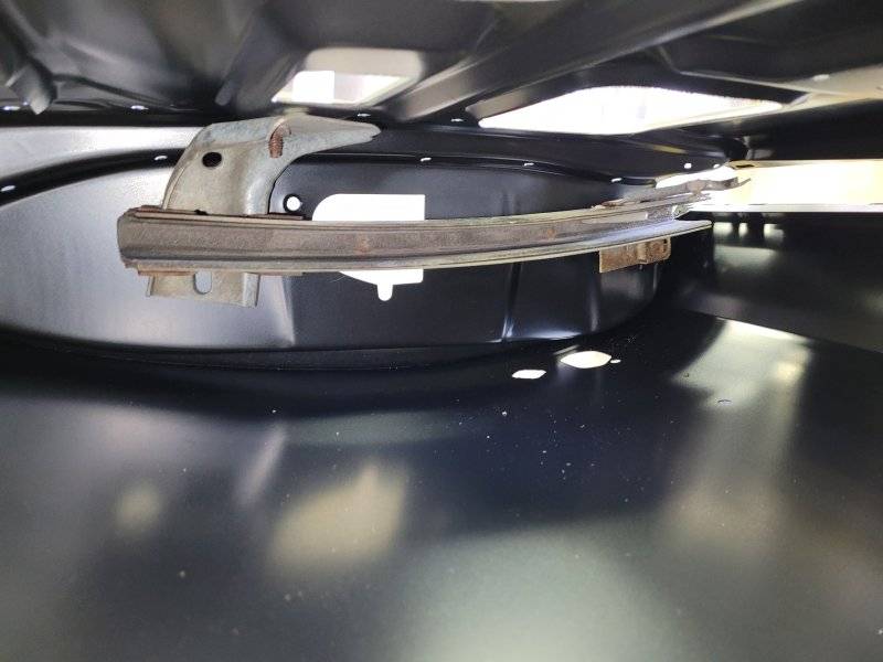

Gave more thought to the windows rear channel/track fitment. Thought I'd better look at how it fit the OE door. Nice clear path for the window to slide in and out.
Put the track back in the reproduction door... glass ain't gonna go in there!

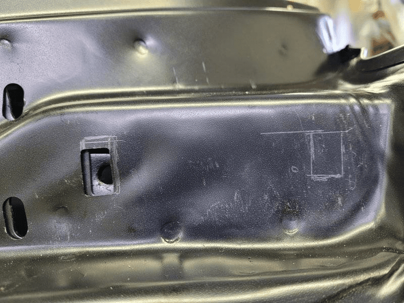

Reproduction slot is over a 1/4" lower in the pocket.
No choice but to hog it out and will probably need to weld in the production slots lower edge some.

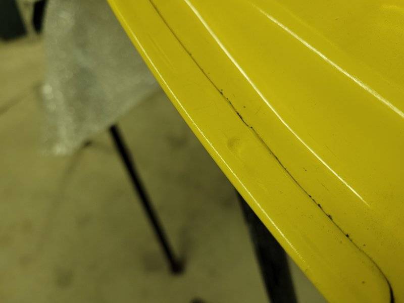

Took a profile off the reproduction door to check body line. Spot on to the OE door.

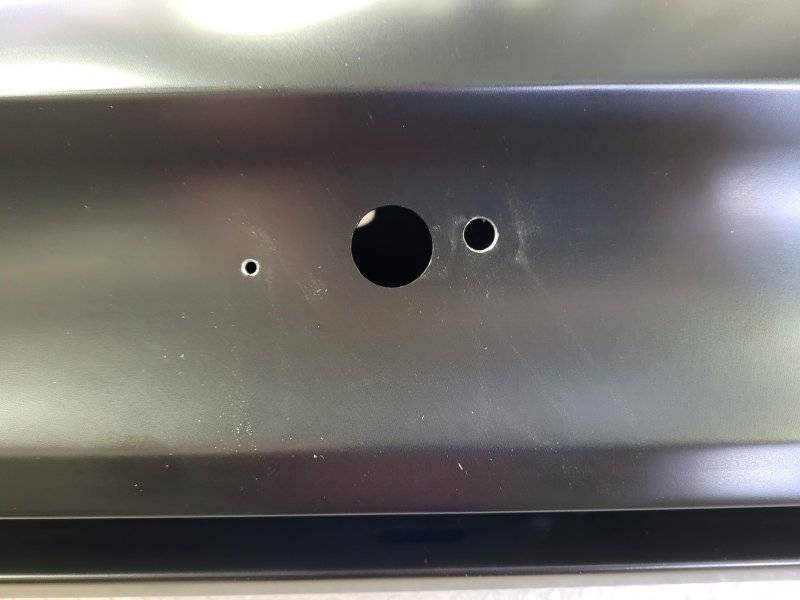

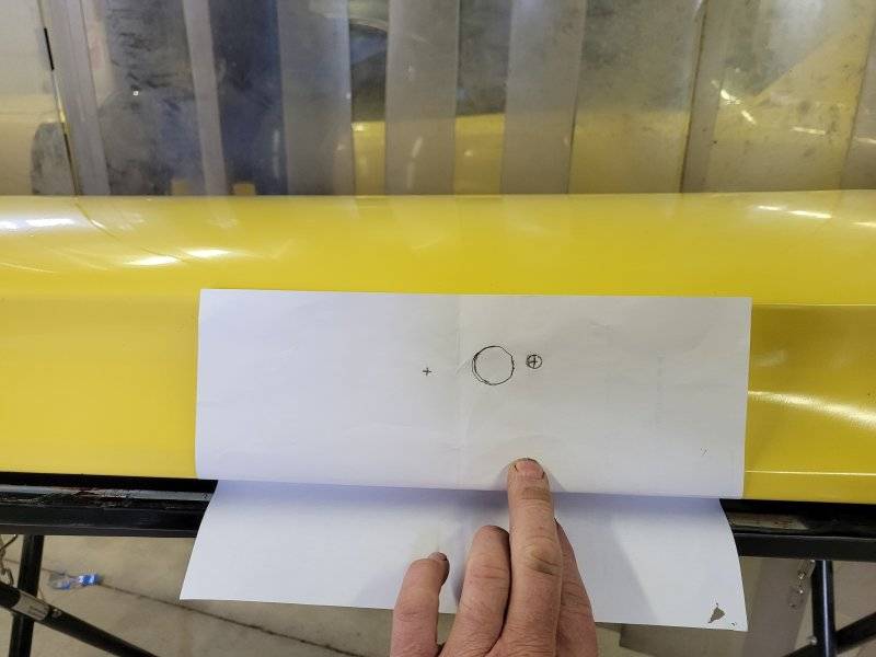

Locating the remote mirror control head hole for drilling. 2.5" over from the Allen key hole and centered on the flat face
3/4" Unibit to the rescue.

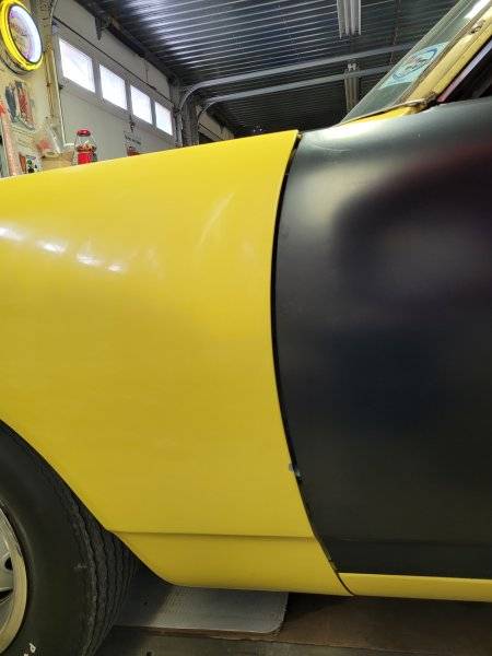

I set the door up in place and took a shot to show how nice the profile matches the fender. Hard to hold and take a picture, but I didn't scratch anything... lol
Rear of door to quarter panel is a perfect match. Thank God something is correct...

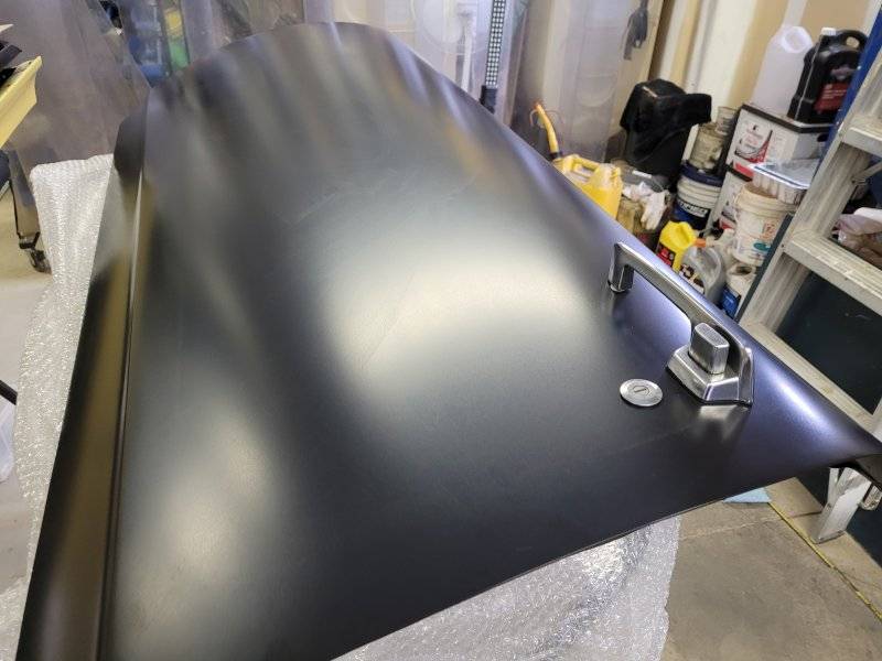

Door handle and lock tumbler test fit.

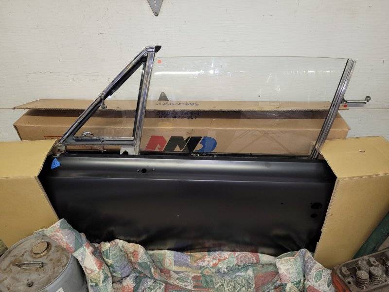

Time to trial fit the vent frame and door glass.

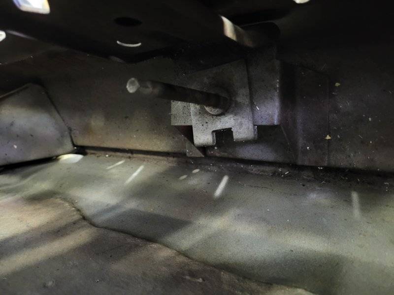

Almost forgot the lower track "foot" post from the old door.
Track foot post out of the OE door.
Where it goes.

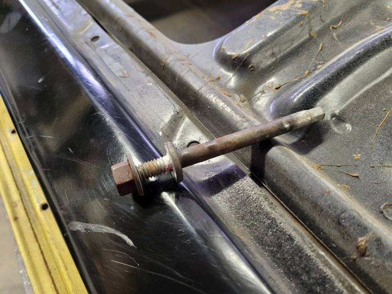

Allen keyed socket head screw and it's attachment block.
Drops in here to hold the vent frame.
Vent frame and door glass going in as an assembly.

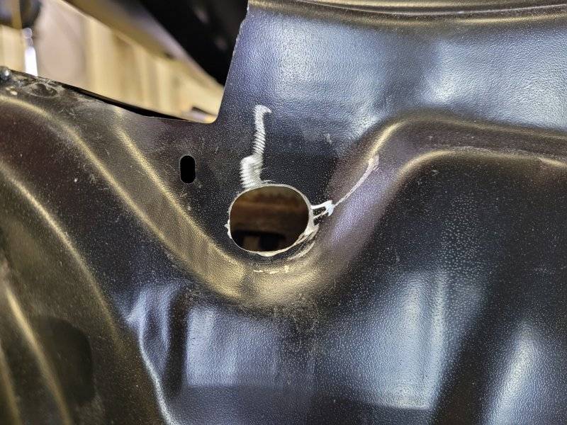

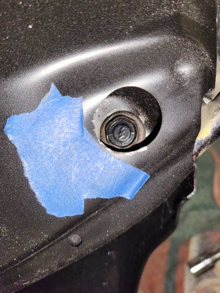

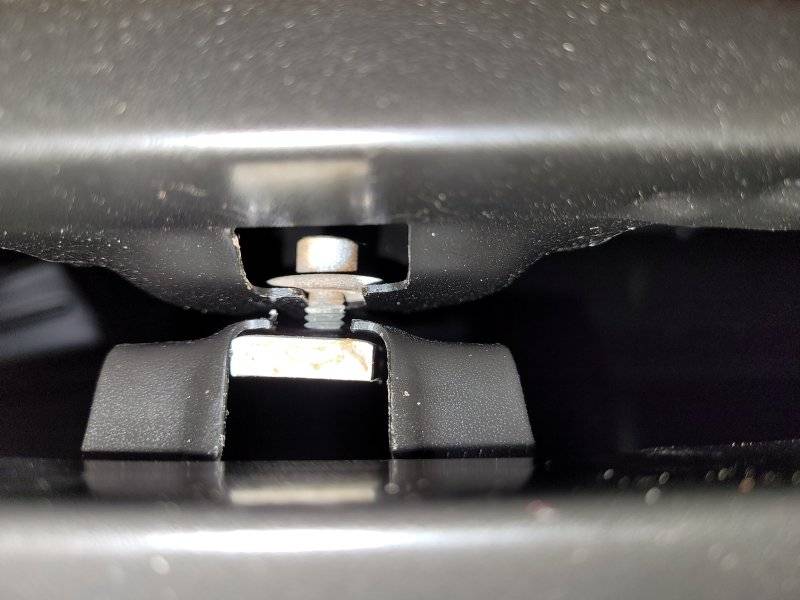

Top bolt hole punched too high up the door. Can't get a socket on the forkin bolt.
Another grind to fit, making sure I leave enough for the cover plug to hide it.
Perfect.
