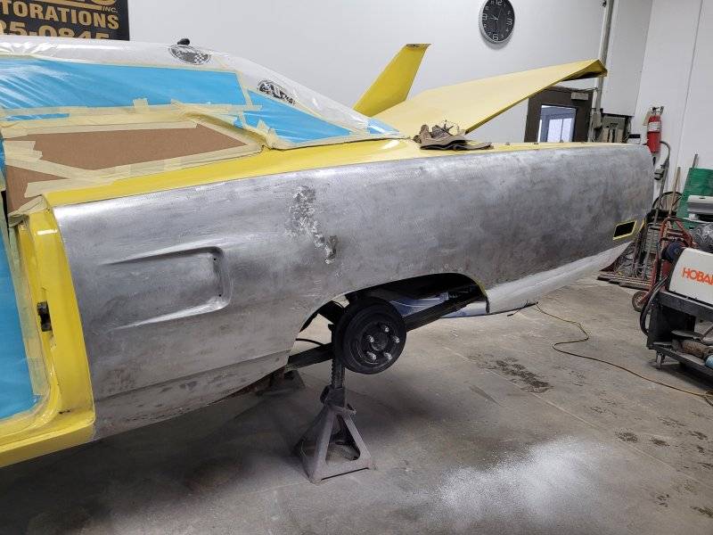

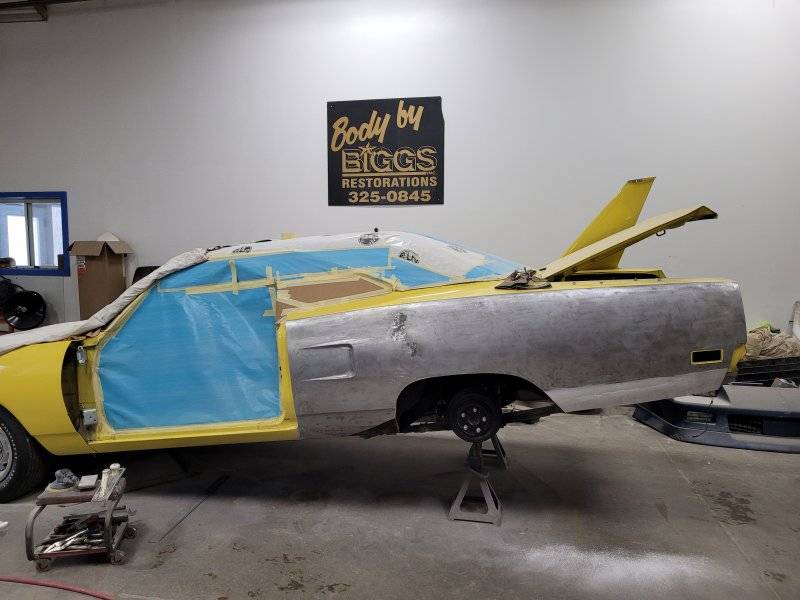

Insurance is probably expecting a scuff and paint, but there is absolutely no point in painting over an unknown substrate. I'll probaby be out of pocket, but I wanted to know what was under the paint.
I am actually quite surprised it's this clean, found some dents that had been filled and some swiss cheese starting on the lower rockers.
Pin holes just starting along the lower 3 inches or so.
There's been a "cancer" bump in this spot since I bought the car 33 years ago.
Swiss cheese cut out to good metal.
Dan did an amazing job of making the replacement section and butt welding it into place so smooth that you can barely see the joint.

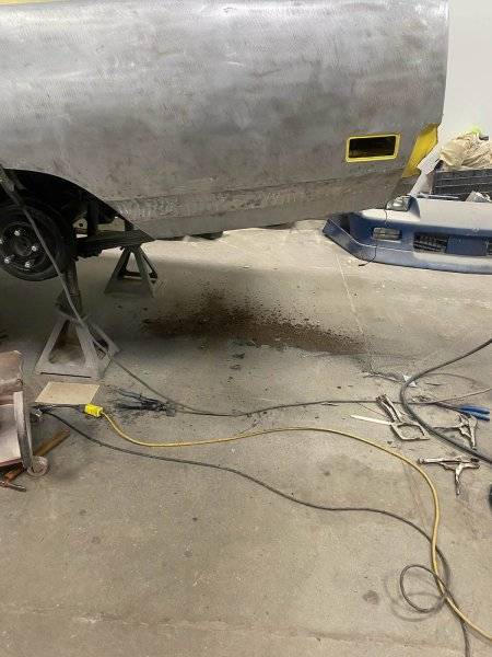

Skim of bondo for the butt joint, dent behind the scoop that was found filled pulled out damn near flush and the lower rocker cut out for replacement in front of the wheel well.
10AM today, break time. Metal replacement in front of the wheel well next today and then some body work and door fitting.
