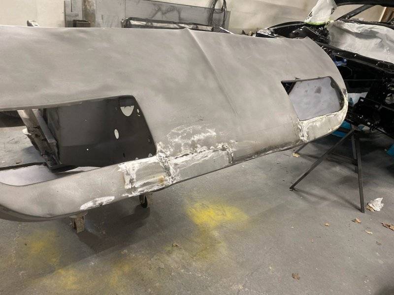

Some more amazing metal work by the lads at Body by Biggs!

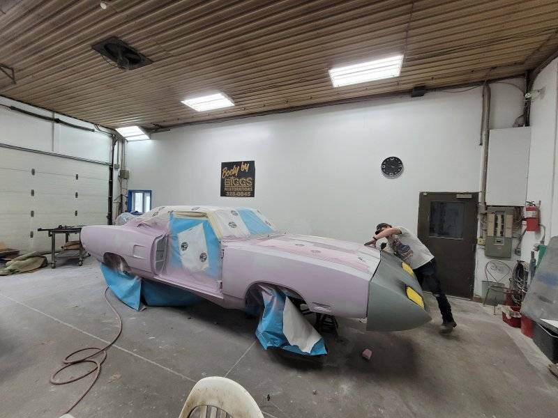

Nose looking good! Just needs some grinding, a skim coat and blocking.

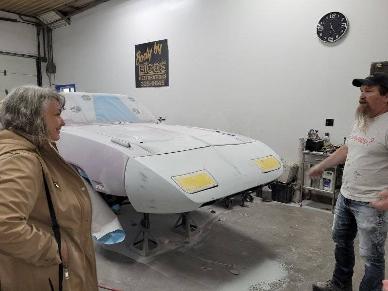

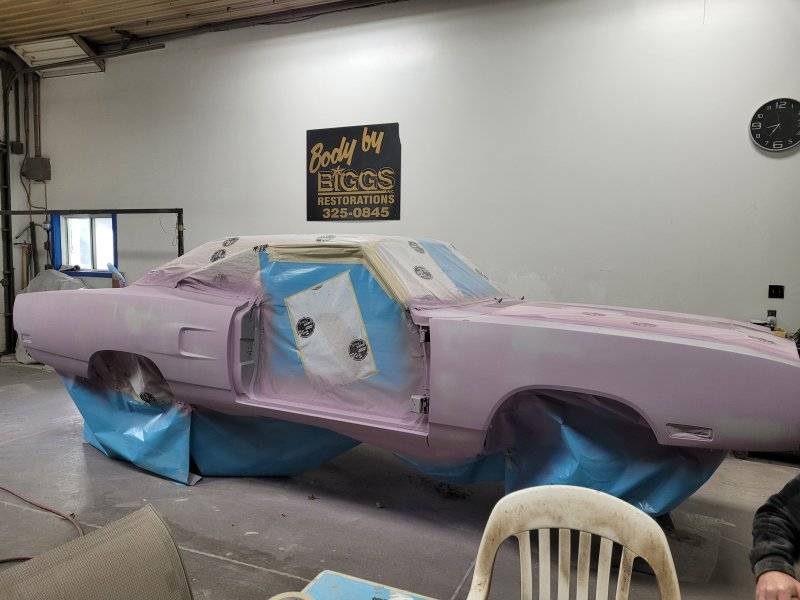

The lads surprised me this morning, apparently we're doing a colour change to Panther Pink...

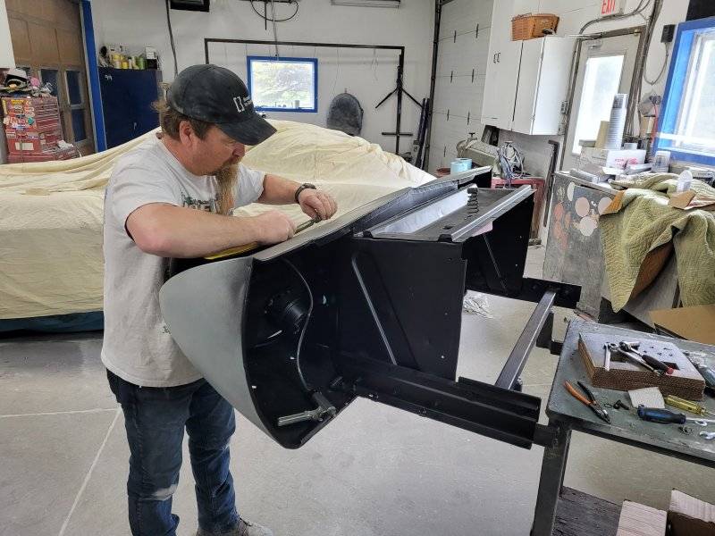

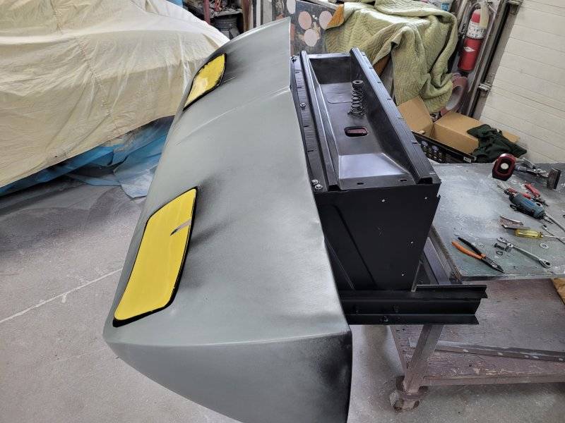

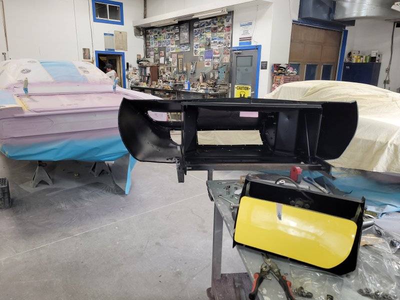

Putting the headlight buckets together and into the nose to see what body work needs to be done to get a smooth fit on everything.
NOT a fun job, but we got'r done.
Dan filing a little bit off the headlight pods plastic lid to straighten it up.

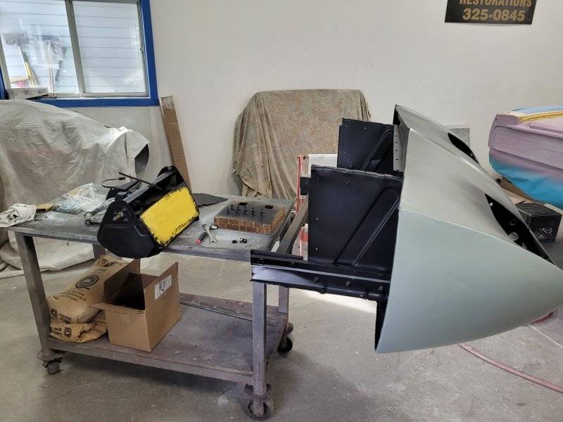

Best fit we can get for now by moving the buckets around, time to put it on the nose as this thing flexes so much it needs to be anchored solid before going any further.
Body pretty much ready to block out.
Farting around with nose alignment to the fenders.

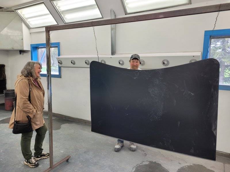

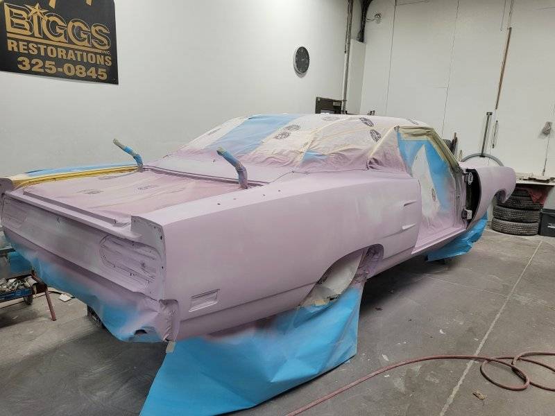

Trunk lid had a bit of rust around the top to bottom seams so a bit more mission creep and I gave the go ahead to fully blast it and repair the "swell" on the inside of the rear lip. Also full of acorns and mouse ****...

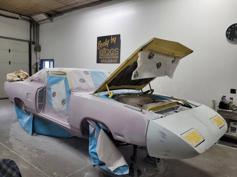

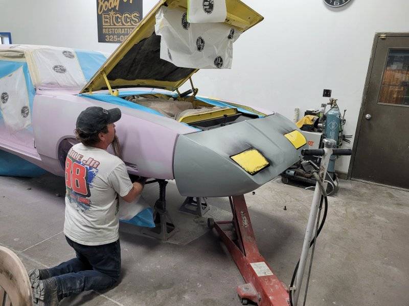

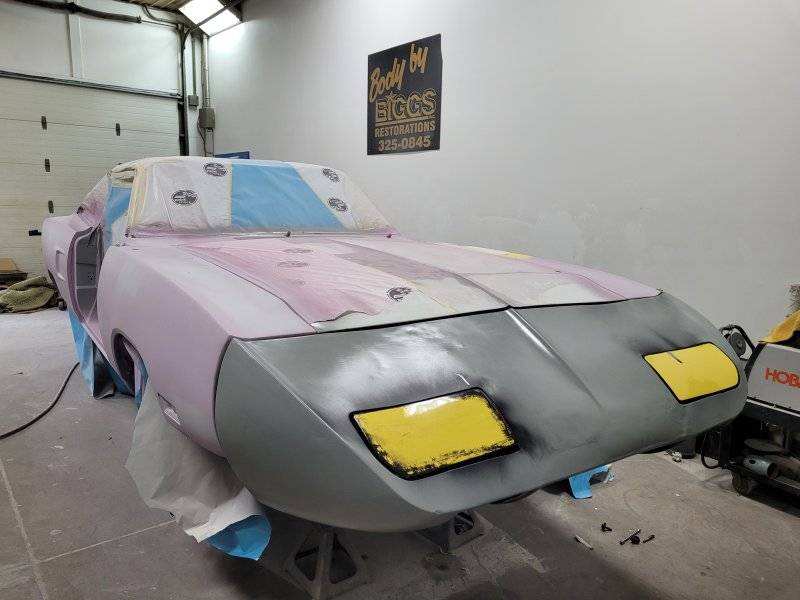

Dan did a beautiful job dollying the nose metal back into place and a skim coat of filler to block it for clean lines.
A ways to go, but we're getting there.
One of the better nose to hood and fenders fits I've seen!

44 years of putting up with me, but still nothing surprises her going back to the day I fixed a Healey bus on a highschool trip, somewhere on the way to Washington DC in '79. Door and trunk lid in epoxy ready for paint.
