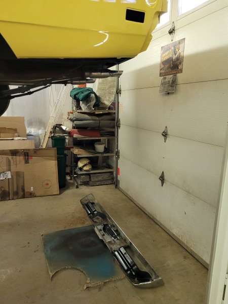

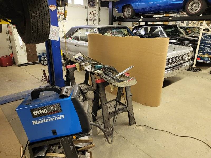

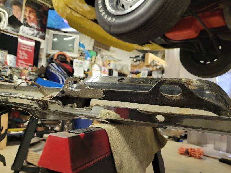

Break out the spark machine..

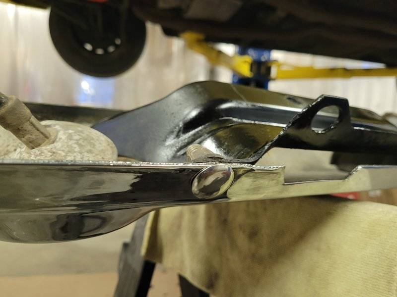

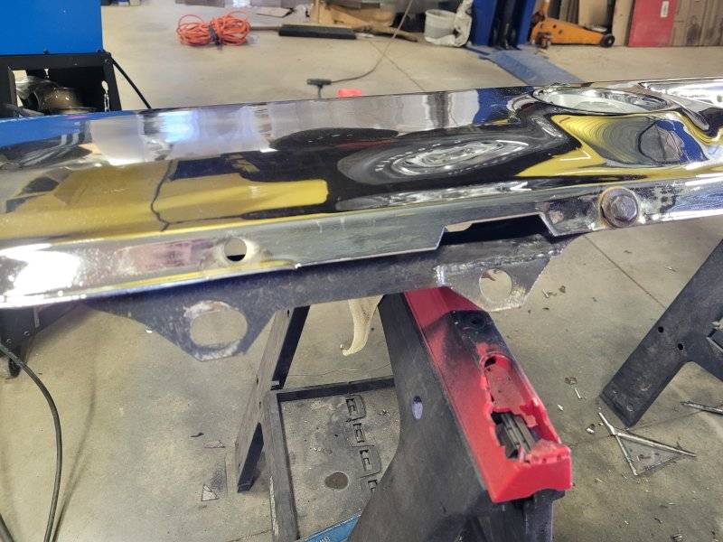

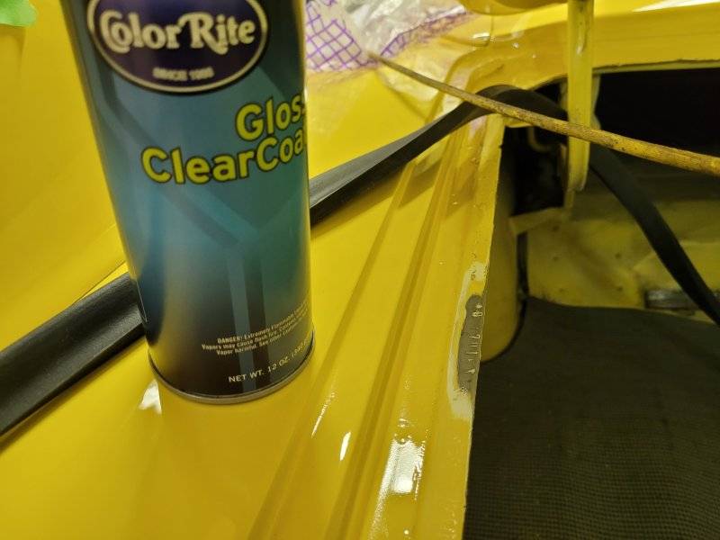

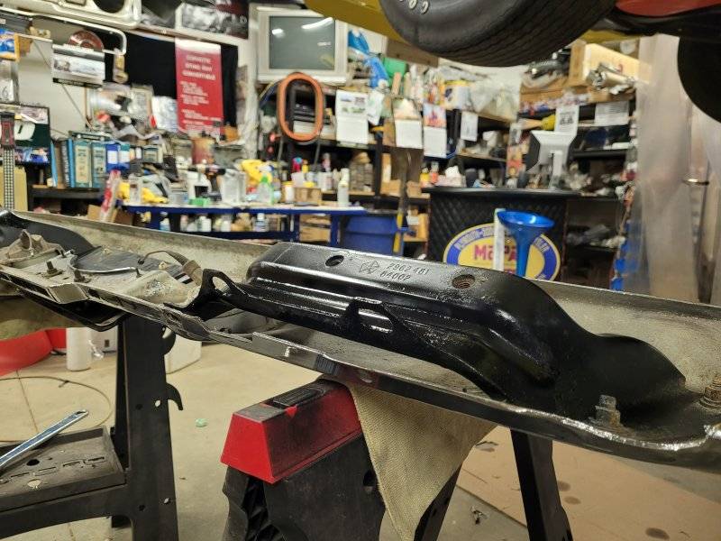

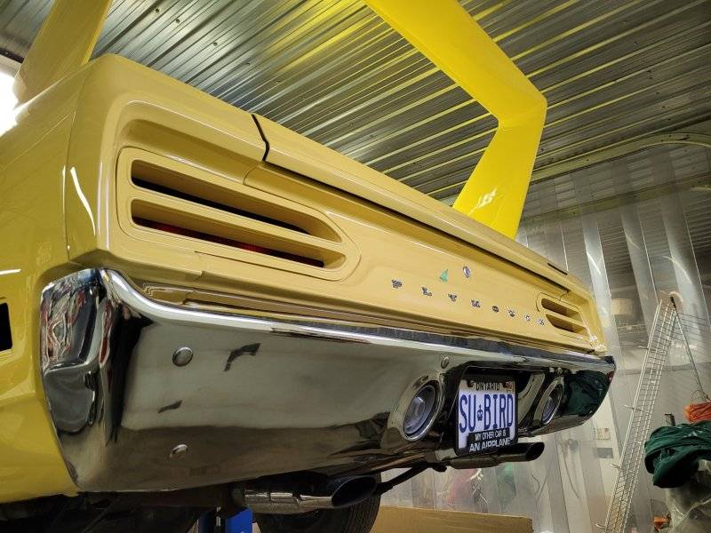

A few quick beads, that'll work. Note the incorrect bumper bolt.
Welds cleaned up. Hole oval'd a bit closer to OE.

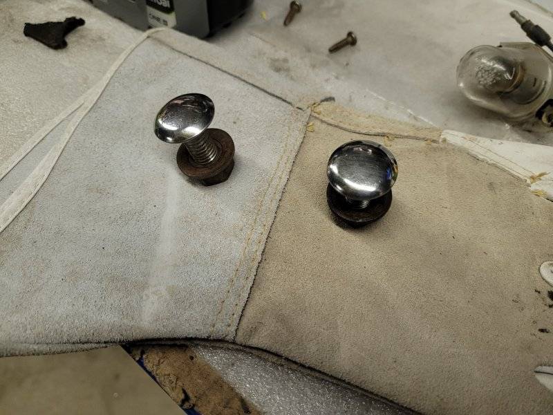

Found a couple of old bumper bolts for the lower edge.
Quick paint so she don't rust.

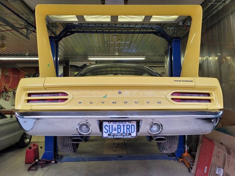

Like I said, reassemble, not a restoration.

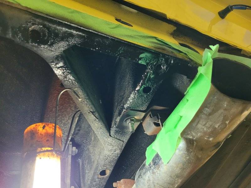

Ready to MIG that nut into the frame rail.

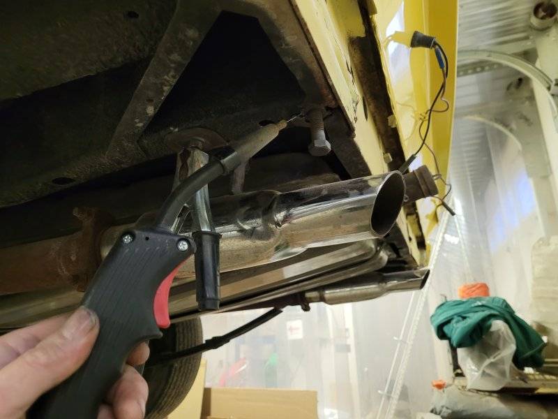

Step one before welding on a full undercoat car. Air compressor on and ready to blow.
Nut welded in, frame cleaned up and a quick paint.
New bumper bolts into place.
