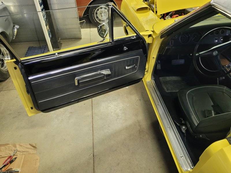

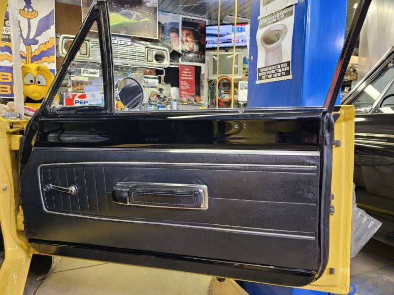

Front arm rests and backing plates.
Alcohol to clean up the chrome and scubbing bubbles for the vinyl arm rests.
Passenger side installed, along with crank handle and door release handle.
Drivers side done.

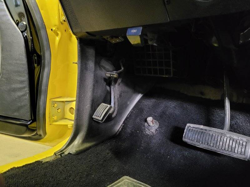

Passenger side kick panel installed after running the new antenna cable up to the radio. Note the near mint original heater box and part # stamp. Not reconditioned... original !
Drivers side in. Guess I need to clean that grease pencil off the hinge mount area.

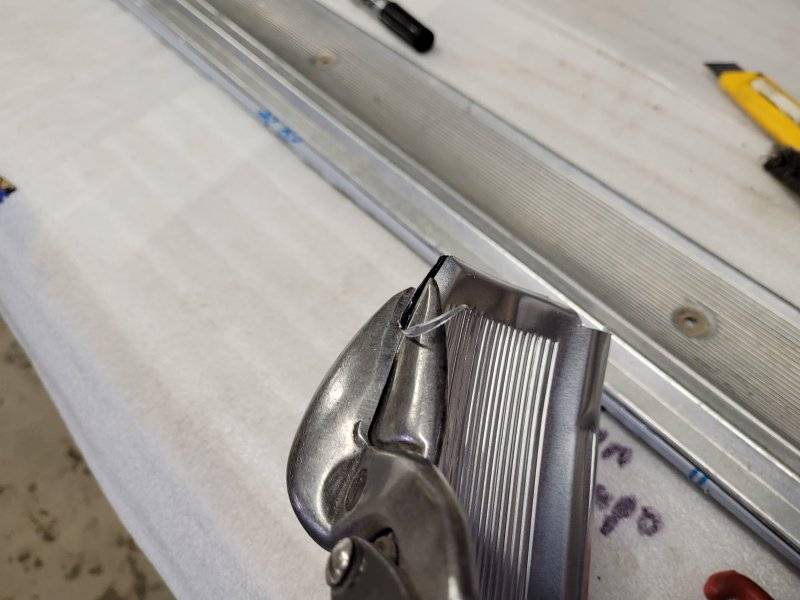

OE sill plates are pretty good, but she deserves new ones
Like everything else reproduction, never an install "as bought" item.
A bit of trimming to a more correct shape.
Passenger sill plate installed.
Drivers side installed

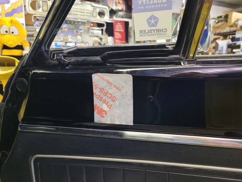

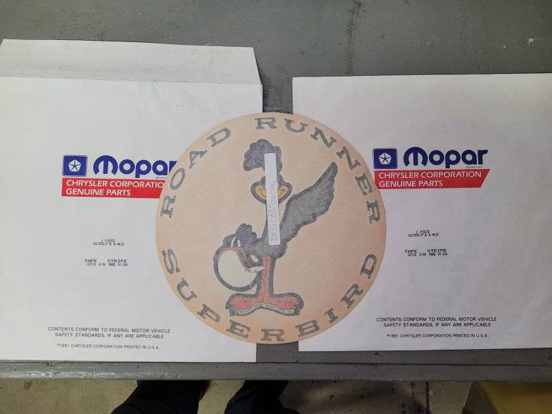

Guess it's time for some dish soap and water to remove Jake's wax job and to float some decals into place.
Two small birds...
One goes 3/8" from trunk edge.. so mark and cut.
Area de-waxed and cleaned with alcohol. Sprayed with soapy water and squeegied into place.
The other on the passenger door interior.

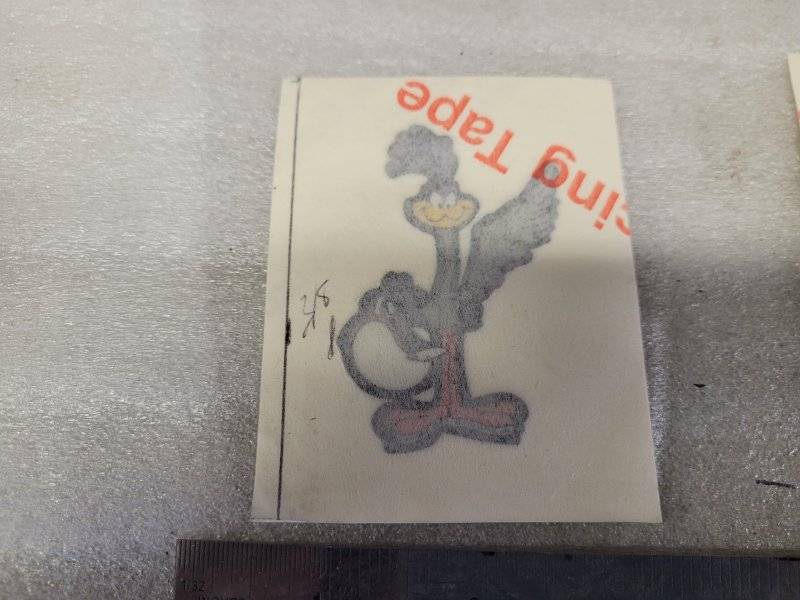

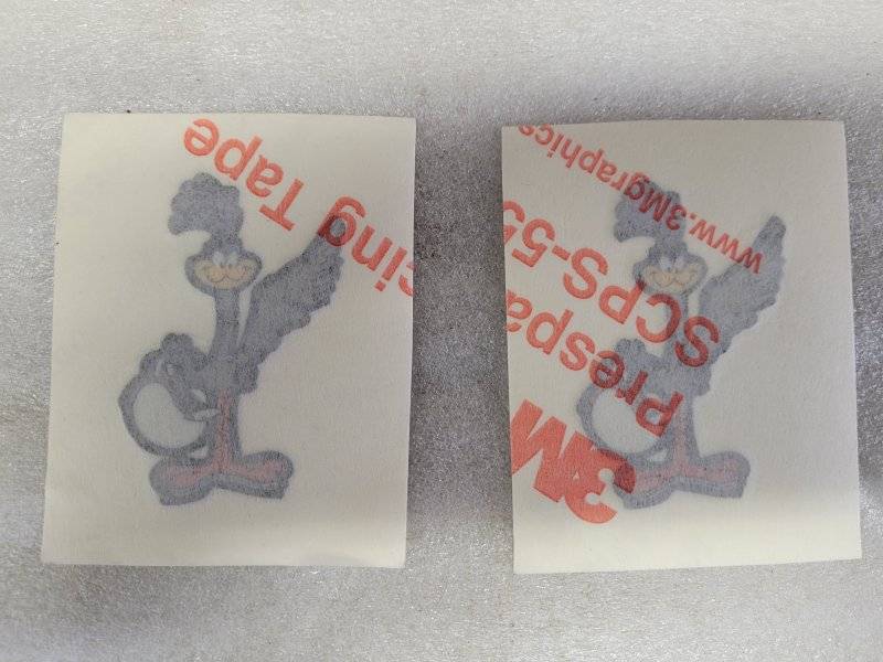

30 year old NOS wing upright decals from my good friend Jerry Hall in Alabama
NOS vs reproduction. Not keene on Mike Mancini's choice of soft clear vinyl as the carrier backing on the repro.
Reproductions. I also have two sets of NOS Plymouth decals (one I had and another courtesy of Moparsaver!) and a set of 34 year old reproduction nose decals to bail me out if need be

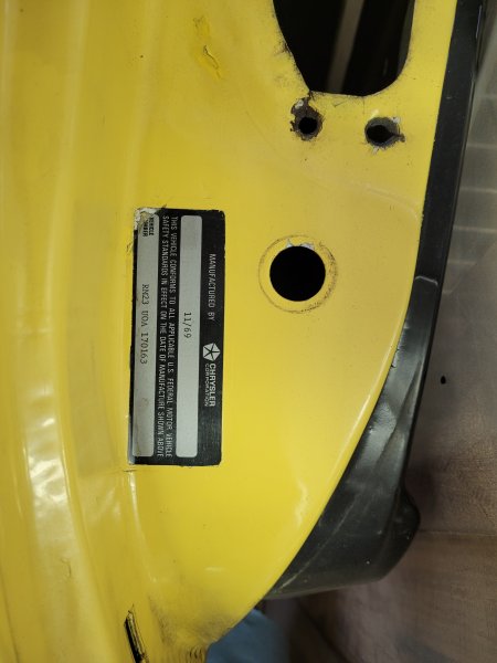

Original door and VIN decal.
New VIN decal.
Placement as close as I can duplicate.
She has an identity again.

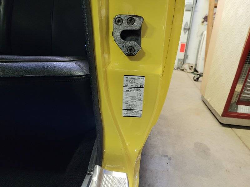

Tire pressure decal.
Took almost 3 hours for the glue to set up before I could peel the carrier paper.

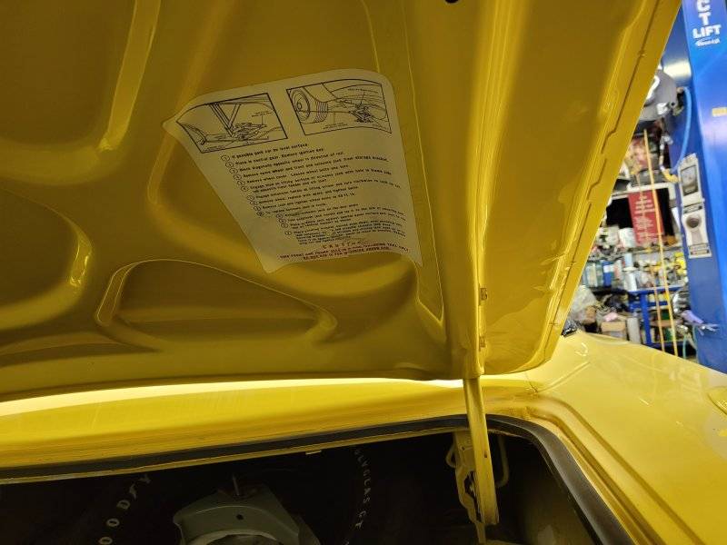

Roadrunner Superbird...
Nose jack instructions in. Still haven't been able to obtain a bumper jack decal.
