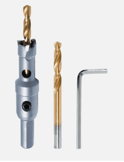

Broke the pilot drill bit for a 1/2" hole saw, need replacement

Is there a source for these short little bits? I'd hate to buy the whole tool again because I broke a bit.
You should be able to buy one at most hardwire/big box store. It they are too long a cutoff wheel can fix that!
Mike
And if you find one without the flat, it's no big deal to grind one in.
Not helpful in your bit quest but maybe down the road, look into adding the Blair Rotabroaches to your arsenal. The individual cutters can be had on their own when needed. Can be had on Amazon too. I have three sets of their cutters ranging from 1/4" to 2.5". Love them.

Found a set of 12 "jobber length" Drill Hogs on eBay. I'm not sure they are as long as the PowerTec bit, standard size appears to be 2 5/16" "flute length." I guess, as long as it sticks out a little, it will work? I can drill the pilot holes separately if need be.

Buy any old 7/32 single drill bit (but a quality one, maybe Hansen) cut to the length you want , grind a flat or two in it, done.
(I have drilled tens of thousands of holes with hole saws in 1/4" steel, changed a bunch of pilot drills in my time)
