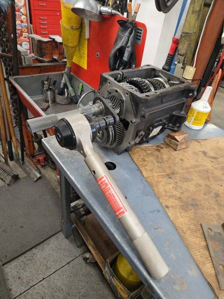

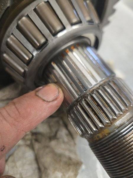

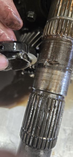

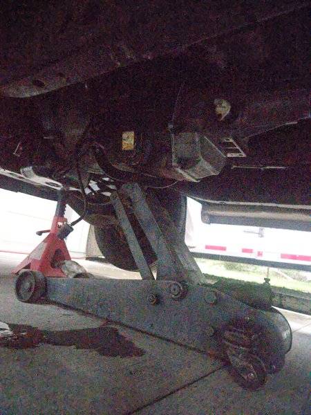

Driving along on my 8 hr trip home 2 weeks ago. Coming down the very steep hill on I-75 into Cincinnati. Traffic coming to a halt at the bottom of the hill. Truck isn't stopping. Pedal is firm. Fortunately it was on an edge lane. Pulled onto the shoulder and missed the cars ahead. Had a pretty good gap as I don't follow close. Might've been able to stop but it was damn close. Drove slowly thru Cincinnati as the issue was no trailer brakes. The rig weighs right about 20,000 so not good. Found an exit and started duag. Fortunately an easy fix. Poor crimp at the fusible link power feed at the underwood junction box. Had a spare brake box in case. Then about 2 hours later the truck goes into neutral. The dreaded NV 4500 5th gear nut has come loose, again, 6th time. Drove home in 4th. Got it jacked up in the driveway and pulpit out. By now It's quite familiar. Ordered up a new output shaft and 5th gear. New design so hopefully this takes care of it. The last time I even welded the nut to the shaft.. Didn't stop the failure. The darn trans weighs 200lbs. Of course dropped the counter gear smashing my finger assembling it today. Fabbed up a fixture to hold the trans to the bench so the nut could be torqued to 300ft/lb. Made a fixture for the floor jack last year when it got a new clutch. Went back.in pretty easy. Started raining so x member, driveshaft, fluid and shifter tomorrow. I feel pretty blessed being able to whip this out being 70. 90 degrees today too.
Doug
The press fit shaft is not available. A few rebuilders use the full spline slip fit shaft with Locktite 620 sleeve locker. This shaft also features a split washer that fits into a groove in the shaft held in place with a 2nd coned washer. The rebuilder I watched said this works extremly well with excellent service life. Stating units he's done this way and disasembled required a puller to remove the 5th gear that had been sealed with 620.
