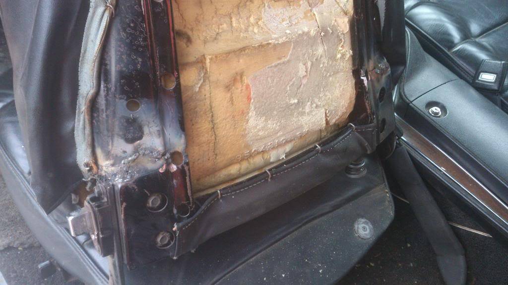

72 charger stock buckets, the driver side bucket seat back where it meets the push button to allow the seat to go forward, is broken right there, and the seat flops backwards quite a bit to the point of no support, anyone ever repair this with some kind of fashioned brace, or just save my pennies for another?.
I had a 1973 new back in the day. That seat broke in exactly the spot you referred to. I tried having it welded several times and it always broke again. In addition the them splitting on the bottom, another common problem, I ended up getting new (used) seats for the car. Cordoba seats in fact from a yard. Tracks are exactly the same.
My drivers side bucket broke in exact same spot. Welded frame and painted, still fine. That was over 25 years ago
Thanks, I have spare aftermarket seats, but prefer to fix mine, will give it a go. I like the oem seats, even if not as comfortable a new ones.

You are missing the stop c/w spring located at the top of the seat pan. It's probably best to buy another, or pick up at a swap meet
Nope, not missing the stop, after removing the seat cover some, the entire metal back was broke in two, using a lot of wet rags and water on standby(don't want my next thread to be "how I burned up my charger") started welding the plate, almost done with one side and a light tack on the other to hold it place, will have to finish tomorrow, was down to my last welding rod. It's already tough as hell only partially welded, after I finish it, I might add some metal plate bracing, it will be hidden by the plastic seat back.

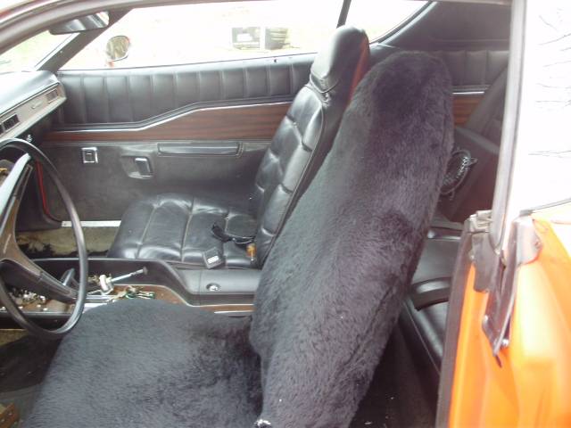

All welded up, pretty sturdy as far as I can tell, the shape of the seat back prevented me from adding any support pieces on the outside of it, but when I get a new seat cover and everything has to come back out for a complete dis-assembly, I'm going to weld in a couple ribs to prevent it from happening again, I'll weld them on the inside, in the meantime, it's fury seat cover time made from the finest Bigfoot hair in the world.
