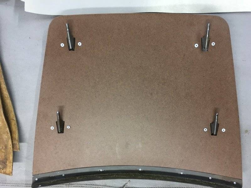

1969 Roadrunner Bucket Seats-Can someone post a picture of what I need to connect my bucket seat back to the seat base frame? Is there any hardware/washers/clips needed? Thanks

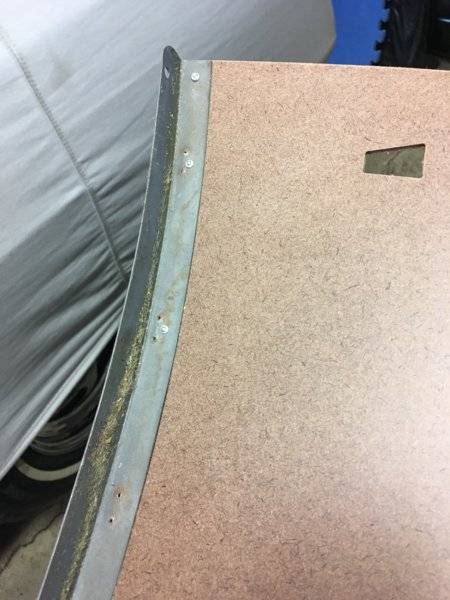

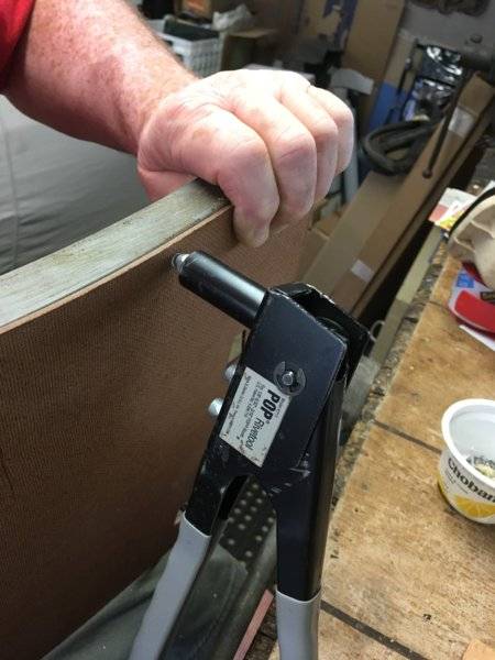

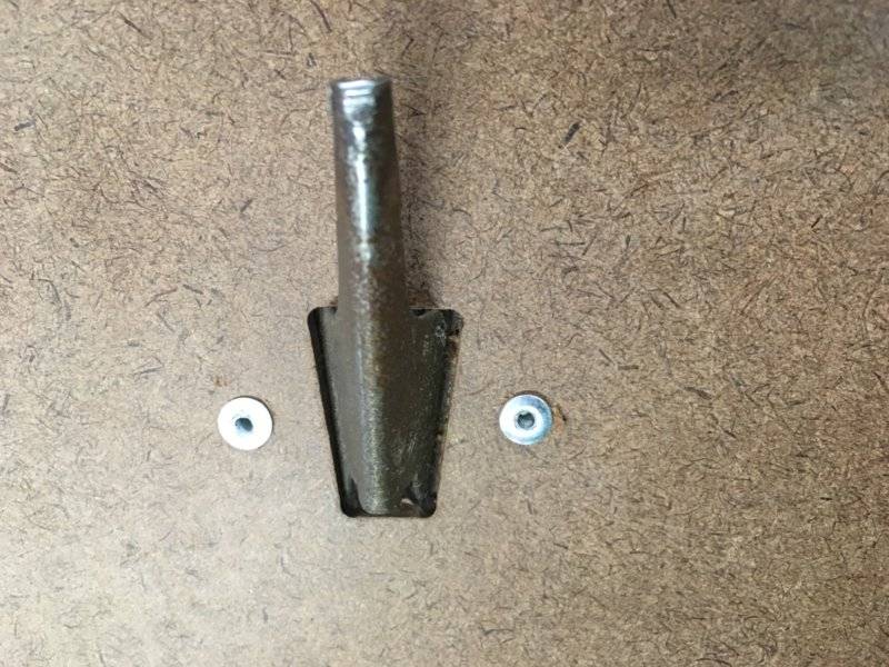

I just did this. You can pop rivet the bottom plate and the 4 hooks. I don’t know if anyone repops these, so you may have to find donors or someone selling them. Good luck

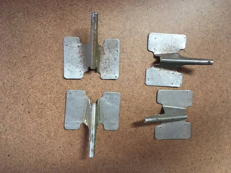

Thanks, but I'm looking for where the metal hinge pieces connect the top of the seat back to the base. They're metal pieces male and female.
The lower clip on the removable back "catches" on the bent bracket above my hand in the pic on each side. The upper bracket "catches" on the straight bar where the seat cover is hog tied to the frame. Then on the bottom lip there are two screws on each side that attach the removable back to the frame bottom.
