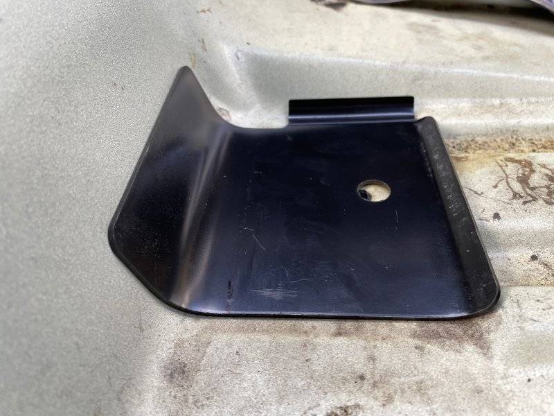

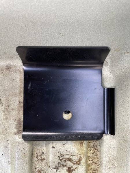

I was trial fitting the AMD bucket seat support plates and found one of the holes way off. The bracket itself slid right into place, but the hole is obviously off. Kind of hard to believe the factory floor dimple would be off. Anybody else encounter this.
Sorry to disappoint you but the factory ain't perfect.
And neither is AMD.
Put the seat in, make sure it fits in factory holes, then make the stiffener hole line up. Ta- da.
Those AMD braces are not a good reproduction. Thinner, smaller, and like you found out, the holes are off.
Yessiree. Fit the seat bottom in with the tracks and the factory holes are in the perfect spot. The AMD bracket hole location is incorrect. Gonna weld it up
and correct it. Thanks guys.
