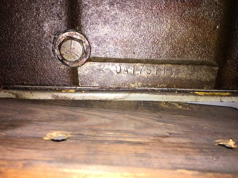

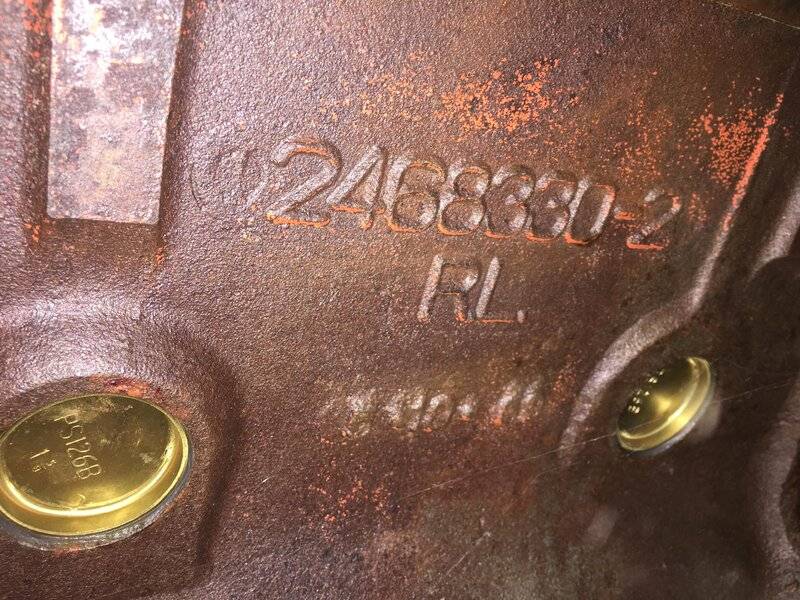

What is the date code of the block and intake manifold?
The cars scheduled production date is just a guess, when the paper work started. In the case of some cars like the A12 cars it wasn't even that. It was just a number. You need to go by your engine build date if you want to get fussy with date correct engine parts. In the case of your 70 hemi it would be on the oil pan rail at the back of the engine
Where on the block is the date? The number that is stamped on the body is stamped on the block near the bottom

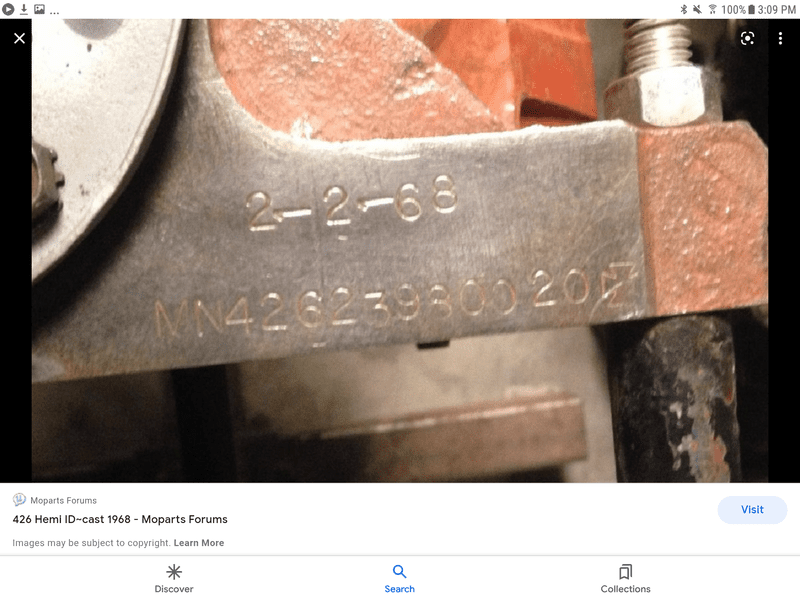

It is under the starter beside the oil pan. The assembly date is the first four digits after the 426. It is a 10,000 day calendar date and may differ from any other date stamped there, as is shown in this case.
It is under the starter beside the oil pan. The assembly date is the first four digits after the 426. It is a 10,000 day calendar date and may differ from any other date stamped there, as is shown in this case.View attachment 1284458
I do have a photo of that number. I am going to go over to the car and get a few more clear photos tomorrow. Thanks
When a virgin sand casting is made, there is the casting part number, then a hyphen, then a 1. My uncle told me that on V-8 engines, it's a -2 because of the 2 banks. After a couple blocks, one of the cylinders will collapse. It is rebuilt, and the number is changed to -3. After another cylinder repair it becomes -4, and so forth.
