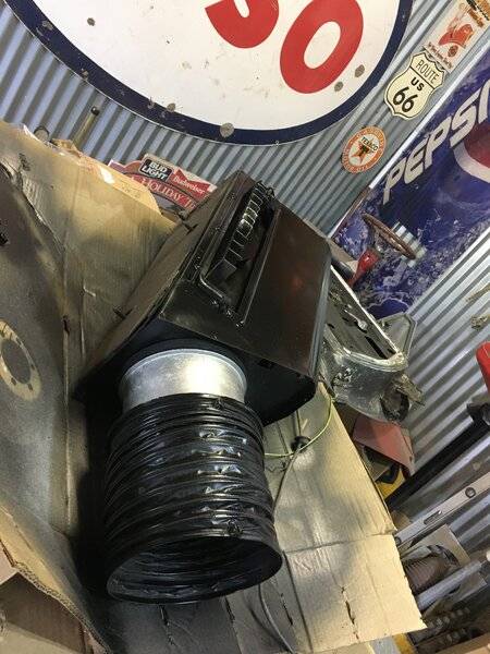

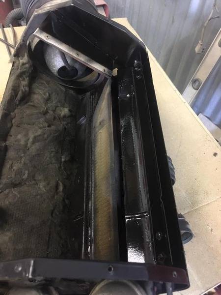

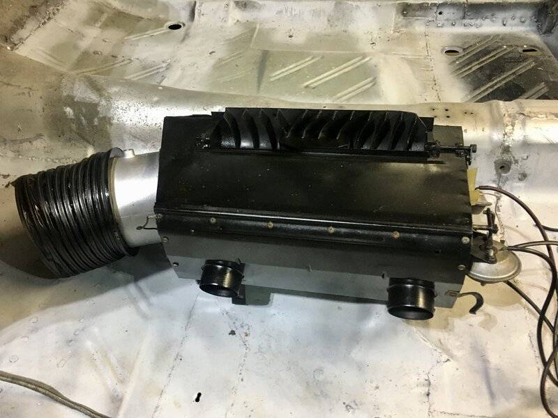

That box is nice and lite huh? Mine old one has the a/c evaporated unit in it also. I made up mounts so I can put a Restomod Air unit in mine. Once you are done welding/grinding the cowl area, get some of the inner frame rail spray from Eastwood or others to hose that metal down for protection. They come with a long straw that includes a multi angle spray nozzle so it can coat whatever it hits. Going to do that on mine when the time comes. I got very lucky as my cowl has no issues like yours top or side.

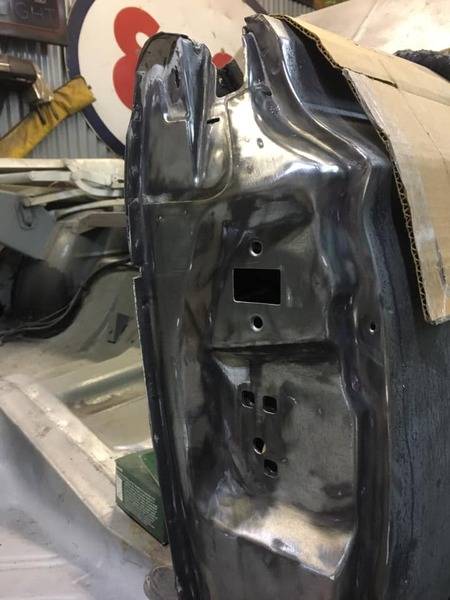

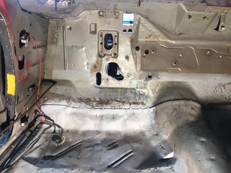

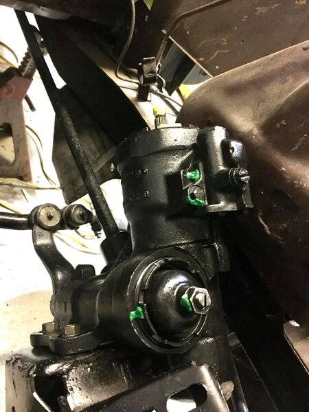

I've already gone through several quarts of Rust encapsulator, Frame paint, and several cans of the internal frame coating with the nozzle... I've done the insides of EVERY frame component,insides of the rockers,in between inner and outer fenders.... If I haven't physically stripped it and then coated it.....Then i've sprayed it with something !! I'm trying my damnest for no rust to come back through anywhere from the inside....
More progress today, but quit at 5 to go to the racetrack ( Bowman Grey Stadium).Great night for racing...perfect weather !!

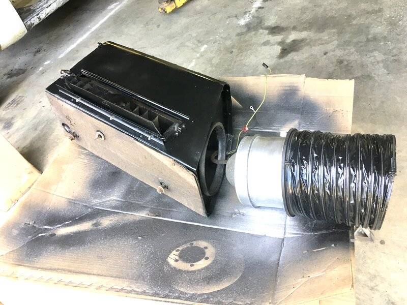

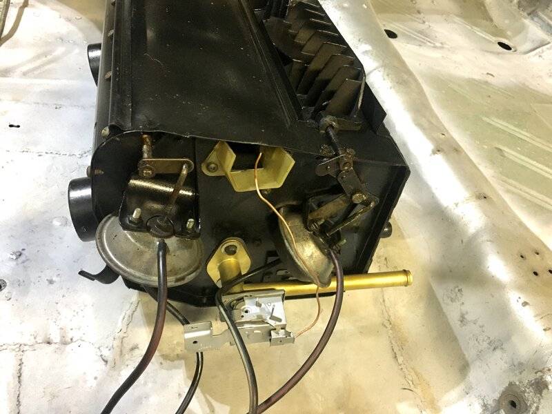

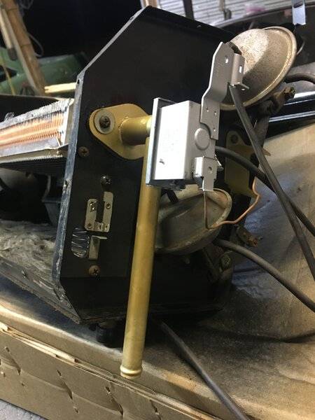

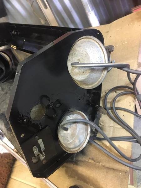

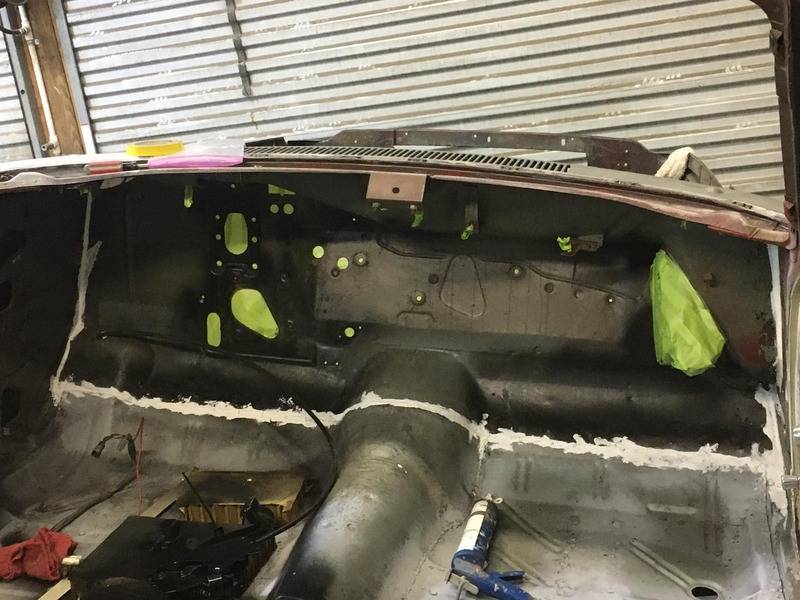

I was working on the heater Box, I have the core out and looks like everybody is recommending Glen Ray for this Recore...Also, Joe at Heatervalves.net to rebuild the valve .... Is that still the consensus ?

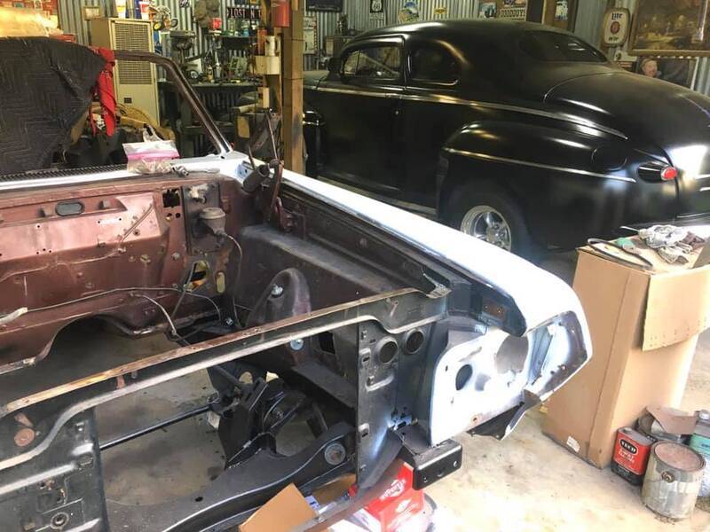

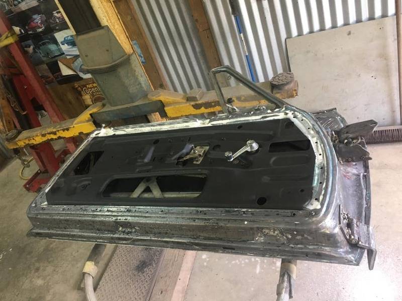

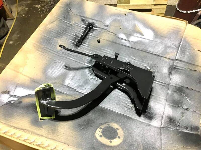

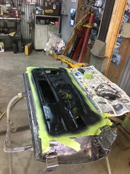

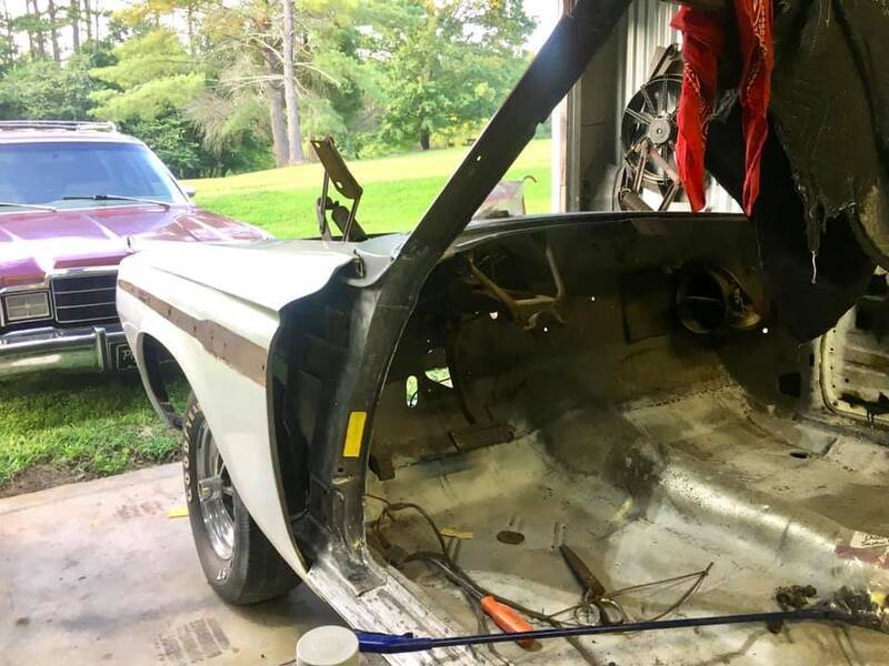

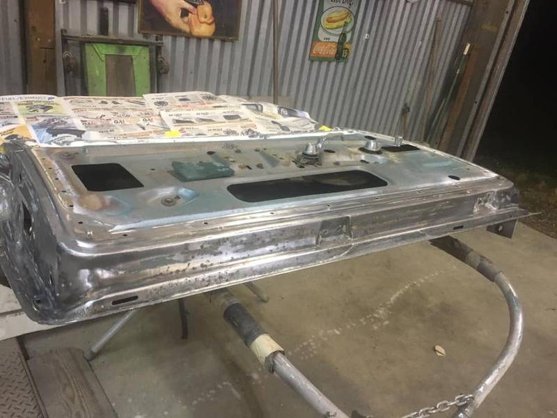

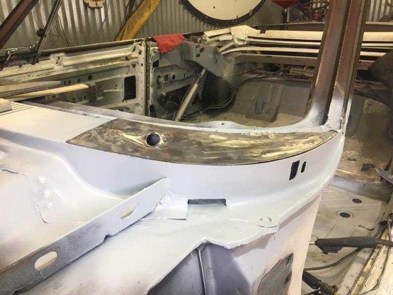

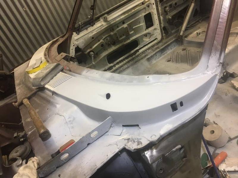

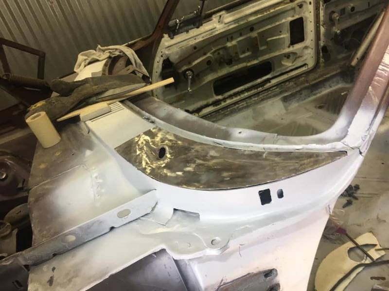

More progress on the 64 !! Cowl top is on,Now the cowl has all new metal and a much larger drain hole and in Primer !! Also working on stripping the door jambs...still finding rust under paint, and Bondo not where you would expect it to be...

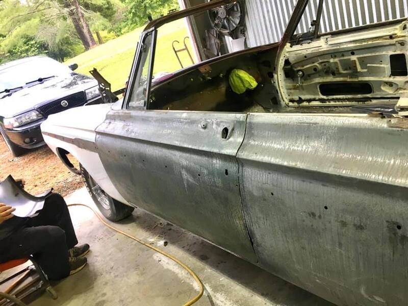

When I get closer to paint time on my car, I plan on pulling the doors off to do like what you are doing. Plus strip the opening jambs and back side of hood. Then I'll do the new color. That way some of the inner stuff is already done for the down the road outer re-do.
You guys are doing great. This car is going to be so much better than it was before. You guys have done more on this project than some fellows do after owning a project for 10 years.

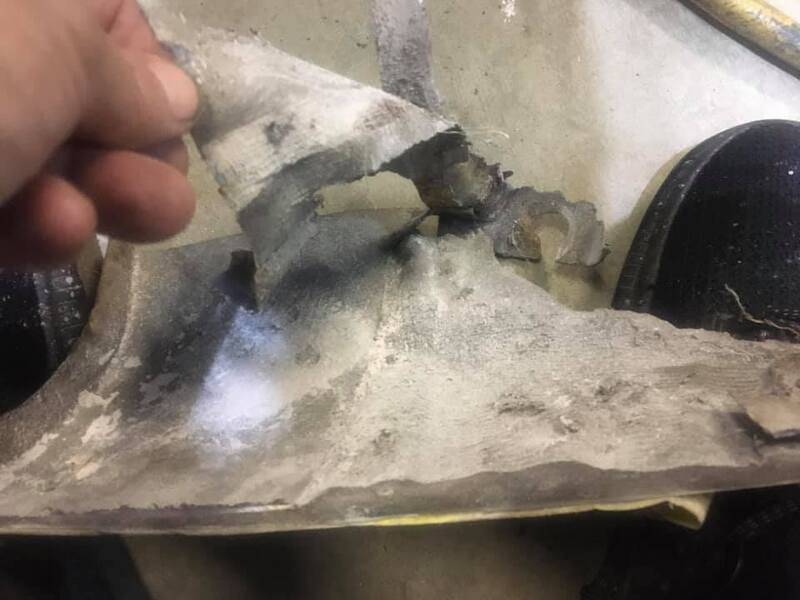

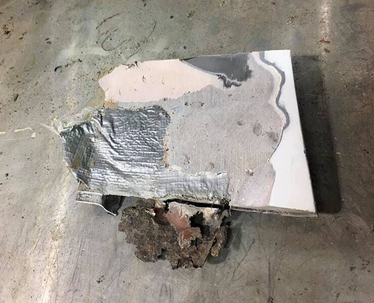

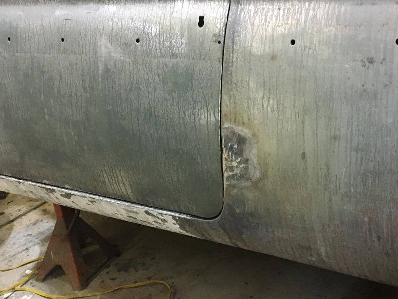

Thanks fella's this car had three coats of paint on it, and tons of poor bodywork. Lots of filler in rust holes like one i just found in the door jamb !!. It had to be done. Fortunately, I have the time to do several afternoon/evenings a week on it. we're bound and determined to get the metalwork done, and get her back on the road !!!

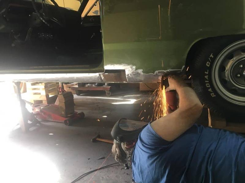

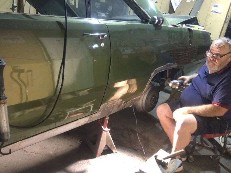

More progress today, and some on my dart.....I found some rust on it as well that was starting to bubble.It was going to Body shop to get painted and after doing a Once over of the body, we found some spots needing attention on it as well. ( we didnt do this Body work either )....

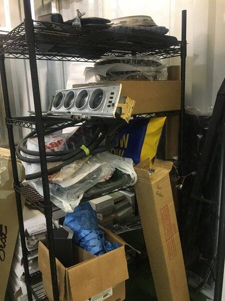

Scored some great parts at Carlisle !! Found a fellow who's dad was restoring a car, and didn't finish or sold it, or something and he had some VERY NICE NOS and New repro stuff that i got.... excellent Dash Cluster, New Door Handles, Excellent Rear Taillight lenses and Chrome, new turn signal lenses, etc etc. That afforded me the chance to get repro rear Taillight bezels from Joe Suchy, Red windlass, all the Door,Trunk rubbers, underhood seals, two Twin Post mirrors, Door sills, Trunk Mat, windshield rubber, Heater core, Trunk filler boards, Floor shift block plate,..Also Got new carpet and Floor Mats from ACC as well as console side carpet, Bought two Max wedge style heater hoses with metal inserts, and some other parts & Pieces I needed from Kramer... Just doing my part to Stimulate the economy....

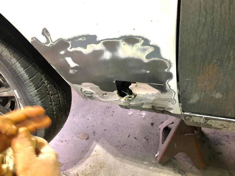

Got back in the garage for a little while tonight.... Hanging the fender before i strip it to mark where to cut the bottom and tack in Lower Patch. Preparing to start painting under the dash, so i'm ready to reinstall heater Box etc etc...Terry is finishing some lower patches on the dart so it can go to the Body shop SOOOON !! Also, check out the chop on his 46 Ford...It's one of the Best I've ever seen....It flows over the car, without cutting the back glass....It's laid forward !!

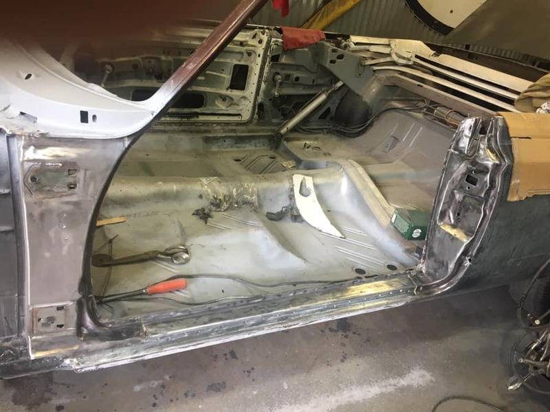

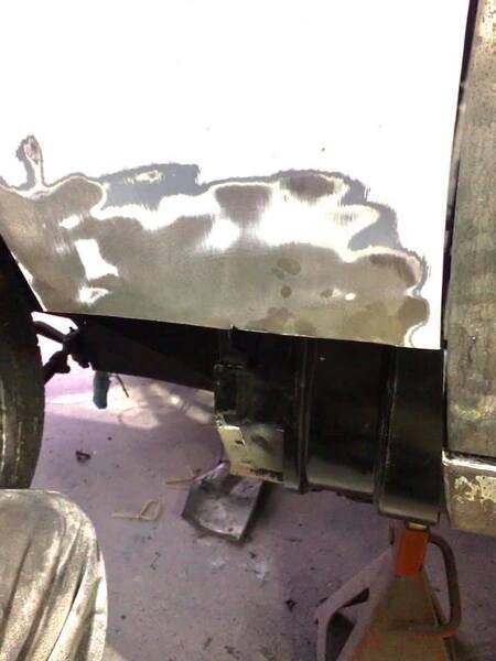

Back on the 64 today now that the dart is at the Body shop. Hung the door to align & Fender. Started to strip the fender as I knew it needed a patch on the bottom...Found a Ton of Bondo over a huge hole covered in Duct tape..Again... I'd probably slap whoever built this car the first time if i ever met them..cut the whole bottom off and putting in a new AMD piece.It came with the inside bracket support as well.Looks like it doesn't fit perfect so we'll split it a little to get it right. The rocker, and door gaps and the fender to the NEW Cowl we made is looking good. The radius on the cowl isn't perfect but very workable !! Cleaned all the old dry seam sealer out of inside firewall. starting to clean and prep everything to paint incl Brake assly and E-Brake assembly. Will reseal, and coat everything with a coating ( still deciding which one ) on the firewall and New floor pans after we weld the floor to the frame rail connectors on the Bottom.

Gotta love cheap body work. It amazes me how some people are driven by wallet only and not getting proper work performed. They'll spend big money on other things but when it comes to paint and body, they have Alligator arms.

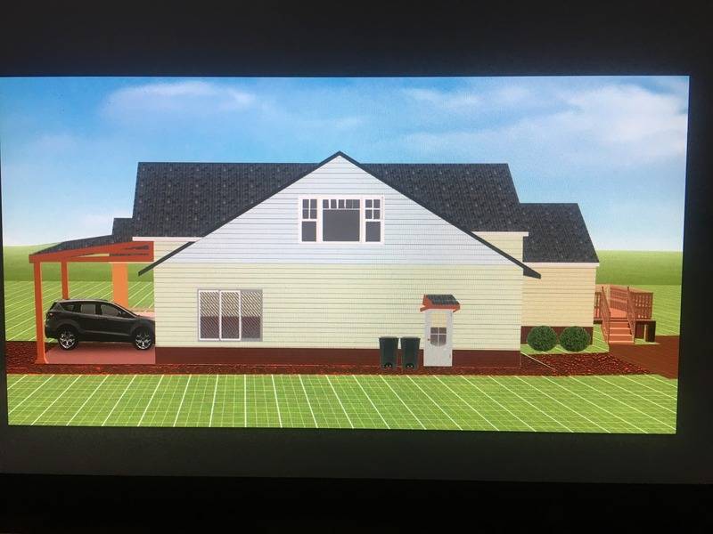

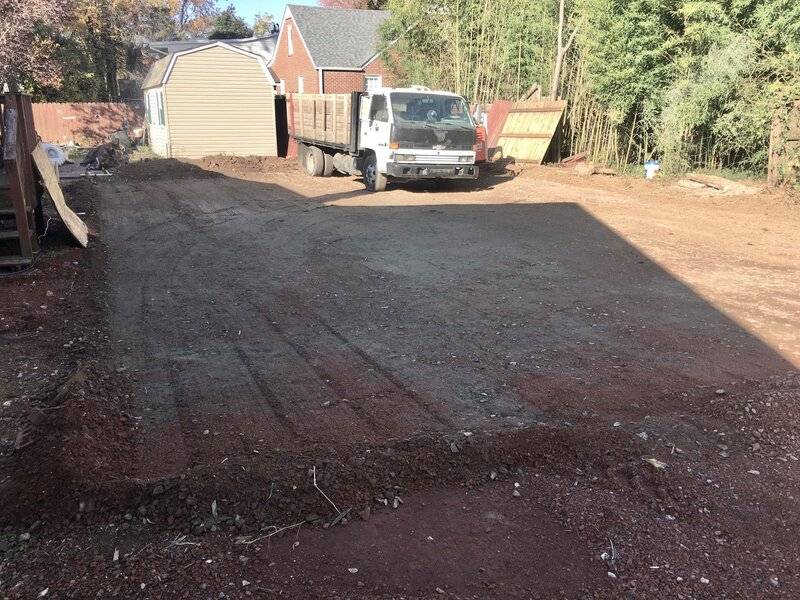

Now, In the city limits in an old neighborhood with all these rules/regs I've spent months trying to get the plans for my 26 x 40 Home addition/Garage finalized where everything worked with our house and the city. had to move from a complete attachment because of the roof lines wouldn't work,the rendering below is what i wanted but couldn't do..., to a detached which we didn't have enough clearance from the existing house to the property lines, and now the garage is larger than 50% of the house size so it bounced, back to a semi-attached structure, and I still had to buy 8 ft of land from my neighbor, which included Full surveys of both properties, and a full appraisal for his lender even though real estate appraiser said it would make no difference.....and $450 later I had a full appraisal that said him losing .0025 % of his land Made no difference. He has a 295,000 house and a note for $70,000 yet they required me to Pay $450 to show that TINY piece of his property wouldn't devalue it enough they would be Upside down....Unbelievable !! Okay RANT OVER...I'm contracting this myself...I've since cut down a huge tree that was dying and was close to the Garage, removed tons of fence, and disassembled and moved a carport to my Daughters, Hand cut and removed MASSIVE amounts of Bamboo from my neighbors lot that I bought 8 ft of.....And they Graded a large flat spot at the side yard…. About 26x40 !!!! Now that the foundation is being dug and the concrete guys are doing their thing, I have a little time on a Saturday to work on the neglected car.....We got the bottom fender patch welded in, quarter panel/door Jamb bullet hole fixed, seam sealed the inside firewall & prepped to paint, installed the rebuilt steering gear !!

Wow! It sounds like you have had a pretty full plate this year. I hope you and yours are doing fine after your Covid bout. Good luck with your new garage build. We designed our own house and attached garage 18 years ago. Single level rancher with 50 X 26 garage with hot water in-floor heat.
