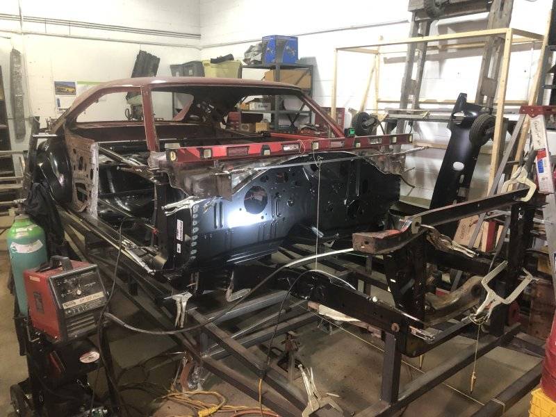

Probably would start off with a good tram bar, laser level , plum bobs, clecos and a jig that has been leveled and a complete shell for reference. Order as many parts as you can as amd is always back ordered ,and when they get stock it's usually out of stock in a week.
