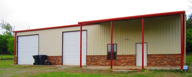

Mine is 38' x 65' and is built on the footprint of my old house, which was destroyed in 2003 in a tornado. shop01.jpg
