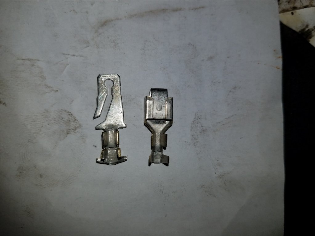

I've used some from classic industries, in my original 68 connectors and they fit fine, just have to wiggle and push to get them all the way through...and make sure your crimps are small enough to slide in a little..yours different from these?
Yes, those are the Packard 56 terminals like I bought that don't work. The original ones out of my '73 are slightly longer and taper more to the tip of the blades: my male originals measure .20" at the square end and the Packard 56's are .25. The Packard 56 male terminals won't even fit into into my female original terminals in the bulkhead connector because they are too wide. The original female terminals I have don't have the extra tab with the dimple in the terminal to give them better contact like the Packard 56 pictured above, also. I suspect Chrysler in all their wisdom must have changed the terminals in their bulkhead connectors sometime in the early '70's, maybe when they changed from black to white connectors.

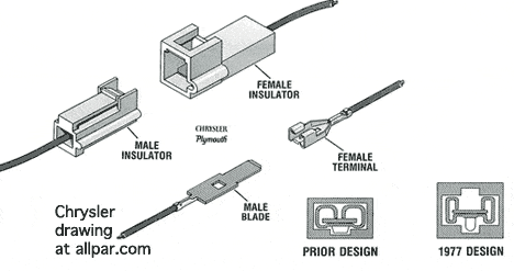

Mopar changed the terminals on 75 or 76 with this kind then a slight change on 77 female ones... rest ( earliers ) were the packard 56 ones
