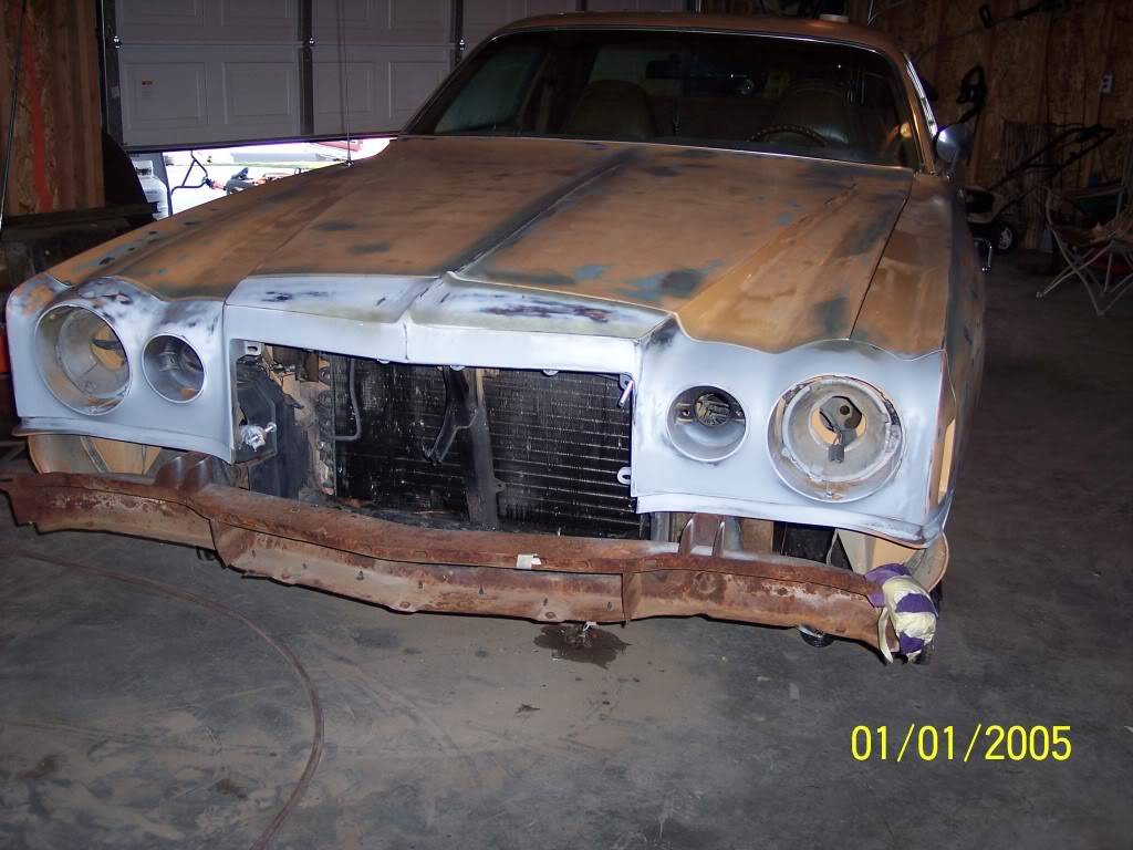

Here's the front (duh)
If I had access to a plasma cutter I would have skeletonized em both. Thats still on the table, I just need to meet up w someone who has one. Here's the bumper now...better, but still heavy...
I can't tell from the pictures. Did you cut up the bracing behind the bumper too?
Naw, I would've needed a plasma or at least an oxy/acetylene setup for that. Whats in the pics is factory. Embedded in the rub strip is about a gazillion (give or take) 9/16"(!) Bolts that go through the chrome outer bumper and then through that heavy steel bracing behind it. The chrome piece isn't light and neither is the bracing. I imagine the shock absorbing mounts are heavy because they HAVE to be. With the right cutting equipment there's easily 20 or more lbs to be lost there. After a crash diet (thats a PUN!) I wouldn't hesitate to put in some lighter-duty bumper mounts/brackets. As is.....I'm not so sure.
