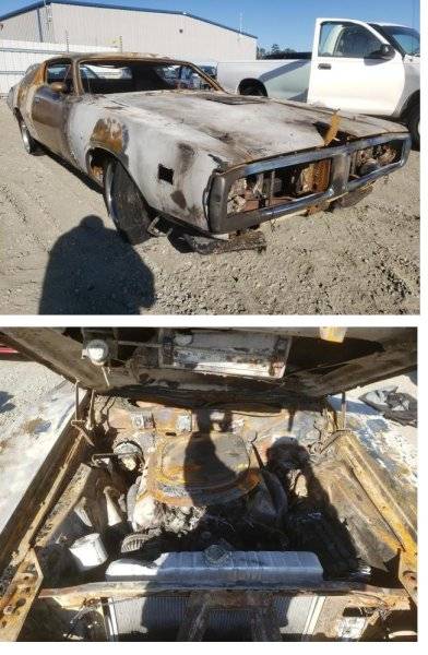

The car would need a full roofskin and inner roof structure,inner fenders,cowl,firewall,doors,quarters,fenders,a hood,trunklid,dutch panel,glass,front bumper,front valence,grille assembly,dashboard,heater box,wiring,steering column,seats,console,shifter assembly,etc. plus engine and transmission,rebuild or replacement as well. It would be a major undertaking even for someone like me who has the parts.

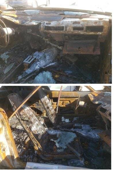

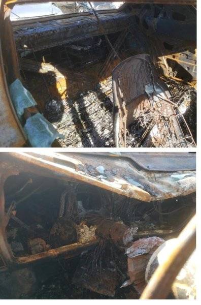

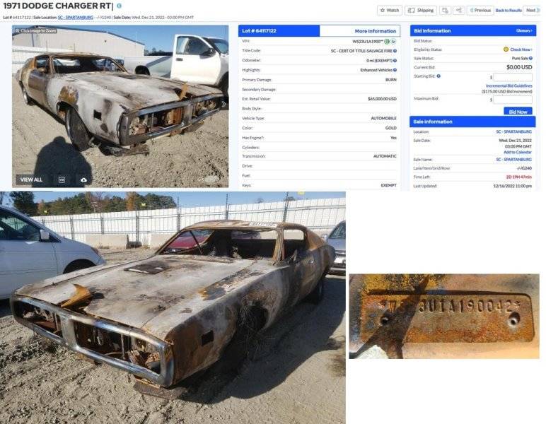

Saw this 71 Charger R/T on Copart. Looks like an alternator gauge meltdown!
Don't tell Nacho...he will chime in to extoll the virtues of the ammeter wiring despite countless meltdowns.

What was the final bid?
No idea. I looked for it, but they removed the car from their listings. I am not registered on their website. Maybe someone who is registered can find out?

It is a bit of a stretch to assume the ammeter, or ammeter connections, had anything to do this fire based on the pictures posted. “Countless Meltdowns”? Relating to properly maintained ammeter connections and related wiring, properly loaded? Where can I find the forensic reports to back that up that statement?
You can’t conflate the later plastic-framed truck ammeter fiasco with the earlier passenger cars, ammeter construction is not the same. Or the fact that most ammeter over-current issues were caused by added aftermarket loads at the battery, especially the later trucks.

’70 Challenger sounds more like a poorly maintained or abused, loose or over-tightened, ammeter stud nuts leading directly to an insulator failure. These passenger car ammeters, ammeter studs, don’t just short out for no reason at all.
In the later plastic-framed truck case, again different animal, no metal cluster frame for the ammeter studs to short to, simple heat related plastic deformation leading to enough heat to ignite materials in close proximity if not addressed in time.

Despite the excuses as to why amp gauges have started fires or caused other damage, the fact is that they can, have and will. Sure if they are properly installed and maintained the chances are minimal but there is still a chance so why take it?
Bottom line is that everyone can do whatever they like with their cars however the truth is that amp gauges and their associated wiring can pose a significant threat, what people do to mitigate the threat is up to them.

Excuses, really? Who is making excuses or questioning mitigation approaches in this thread? Only questioning assumptions based on limited or flawed information. Fact is, any electrical circuit components/connections in any circuit designed to handle any kind of current can and will fail without any maintenance/inspection and/or is exposed to abuse/poor servicing over time (especially after 50+ years) and/or operated outside its original design limits.
