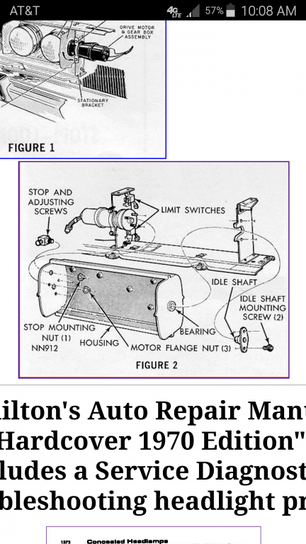

I am looking for the plastic bushing for the rotating headlights on 66-67 Chargers. I also could use the bushing/light housing support/pivot that the bushing rides on. (The part with two screws that is accessible from the turn signal housing location) Are these sold aftermarket for am I going to need to find a good used parts? THANKS!
I may have several used bushings, unsure abt the other part u r mentioning, can u add photo on here ? The brackets etc are all side specific. As far as the plastic bushings, unsure how to get the wiring separated. the terminals look as if they will allow pushing the wires thru but not with drawing in order to remove the connecter and allow wiring to be removed from housing to get the bushing ?? Do not want to cut and splice, will look today to see if there is a way. Anyone else reading this ? please feel free to advise thanks again :-)
I had wondered about the wiring myself. The other part I was referencing has the wire going through it as well. The bushing sits on it. Basically it's the hinge opposite the motor side of the rotating bucket. I will try to snap a pic the next time I am out in shop. Thanks

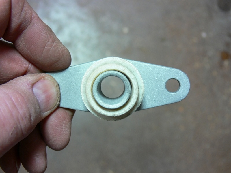

The idle shaft is the other part I could use. I am trying to attach a pic.

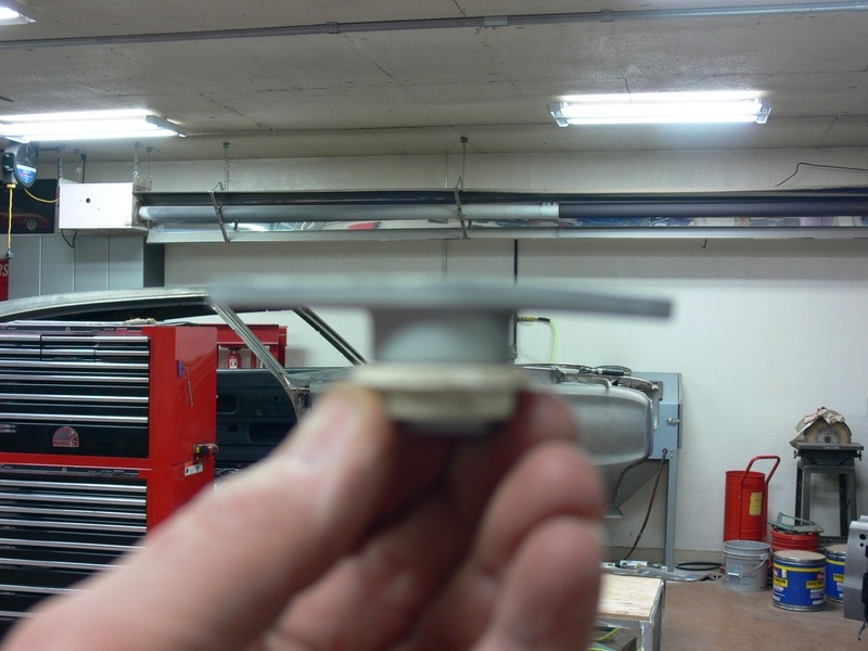

I agree about possibly splitting one edge, do believe that work easily, mine may be to brittle ? Will sell the bushing and idle shaft for 10$ and shipping, will not add handling etc what it cost to ship is what it will be. Hope to add pics today
Okay, just now figured this out, but still will send after you look at these pics and do want, sorry the idle shaft is out of focus, hope you can see the slight bend towards mounting side. The gap on the bushing while on the shaft............
That should work. Somehow my idle shaft got cracked across the mounting holes. It's not completely broken but not good.
theses parts were actually on the mock up I am doing and as I tested the motors they did not show any wobble etc., course the turn is slow, so may not notice anyway. They will be in the mail Monday via USPS..........
