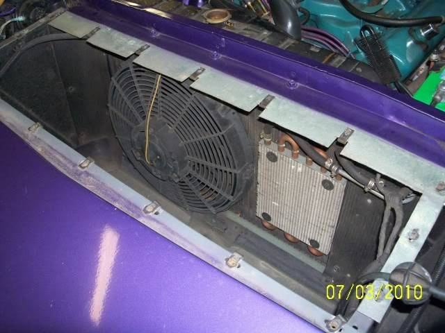

Fan is activated by a switch at the bottom dash. I make it a point to turn it on. I'm going to order a B&m and double check the lines. Does B&M sell a quality transmission fluid and engine oil cooler in one? Or should I just run two separate coolers?The tranny line toward the front of the tranny is the 'out' or hot side, the rear is the return or cool side. Find out which one goes to the top of the cooler. Also, that cooler is an inefficient pos, get a b&m plate-type supercooler - best cooler technology for the buck.
How is that cooler fan wired? Is it always on?
Lol, btw, you're right, those pix suck.
here is mine..5/16" lines to trans, by-passed radiator, been on there since late 90's
Thanks. What brand cooler is that? Is this the car where the fluid also flows through the Rad or no?
