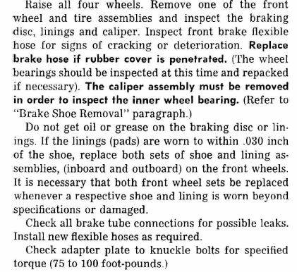

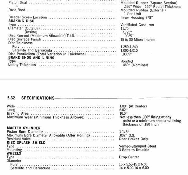

When these manuals cover multiple systems you need to read deeper into the assemblies for more information. They tend to make you think but the information usually is there. In your case the knuckle torque is in the repair par along with the pin torque which was not listed. Also the end of the page which you posted with wheel size which triggered responses.

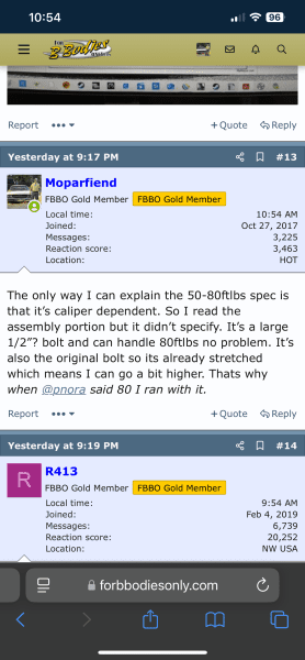

I agree thats why I said in post 13 I went back into the manual assembly instructions thinking they buried in there and explained the range 50-80 but no it didn’t.
Did I miss something in your post that specifically what torque is correct rather than the 50-80 range?
Your fine. But the torque was cited in the manual. I posted a copy of the page a few links back.
